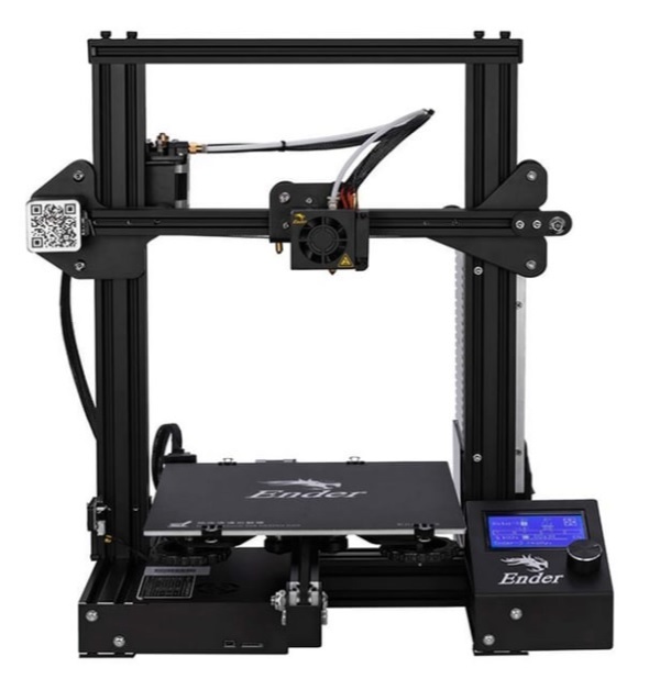

I've had a basic 3D printer for a couple of years and have used it to create a range of things for my layout and other interests. I'll pass on my impressions for those that might be tempted to give 3D printing a try.
I've got an entry level Ender 3 printer with the following basic specs -
It looks like this -
It is really quite useful and I've created level crossings, buffer stops, coupler pockets and some basic scenery items but using it to create a piece of rolling stock good enough to run on my layout is beyond my ability and, I think, probably beyond the capability of this basic machine - at least without some major changes. I just can't get the surface finish and fine detail I would be happy with - then it needs painting.
Hopefully there are some experts out there on this forum who can provide solid advice on the type of machine and material that might produce an acceptable item so others can buy something that they're not disappointed in.
I'll also note that it takes a bit of skill and aptitude to master the creation of a complex 3D model with fine detail on a computer, then slice that design to produce the commands to control the printer, and to then have all the many printer settings just right to get a good product.
I don't mean to discourage anyone from giving 3D printing a try - but a budget machine might be a disappointment.

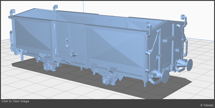

A car such as this one, would take me 4½ hour to make - and cost perhaps 15-25€ without any post processing. and ofc - that's with 100% standard material, if u want a copper look chariot - it'll cost you alot more! :P
but, this'll give those that dont know much about it, an idea of price and time :)
thanks 2 users liked this useful post by Märklin-3D-printer
