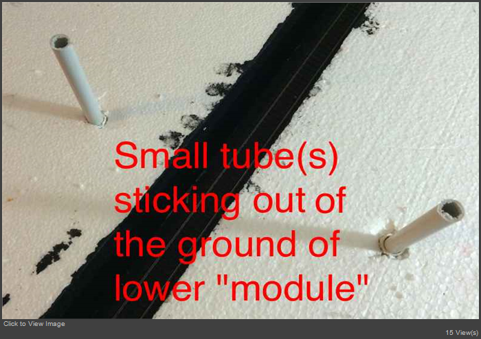

I especially like the 1st idea. I haven't placed any scenery yet to my railroad. I have been saving styrofoam in large chunks hoping to use them to create a mountain with a tunnel through it. I have to figure out how to gain access to the tunnel in case of a derailment. I'm not crazy about soda cans. I don't think they fit any known size tank. My 88 year old back is giving me problems so it is hard for me to get to my shop and to construct layout ideas. I'm heading to Saint Louis with my son and daughter on the 26-28th to visit the transportation museum although the trip may add to the pain. I really don't want to go, but I may never get another chance. I have been following your building and must say you are meticulous to detail.

Just design the mountain so that it can be lifted. In order to prevent the mountain from sliding around in a similar situation, I used tubular conduits, one with a smaller and one with a larger diameter. I jammed two shorter pieces of large diameter tubes into the lower and the upper module, respectively. When the two modules were placed upon each other, I inserted a longer small diameter tube (having the combined length of the two large diameter sections) into the large diameter tubes. Then, I repeated the process at a second location. On the one hand "the mountain module" stayed put - see pix. On the other hand, it could be lifted easily.
