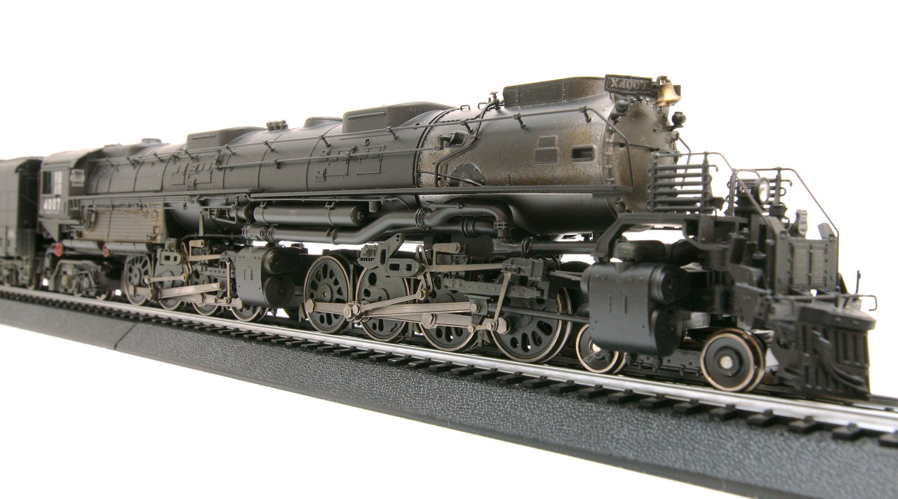

My friend bought a large lot of train equipment at an estate sale and asked me to check out a loco for him. It is an Athearn Genesis HO big Boy #G97201. It is equipped with a DCC Tsunami Sound Decoder.
I set my MS2 to DCC and it recognized and loaded the parameters for the Big Boy. When I release the STOP there is a very quiet "squeal" from the speaker for a few seconds where upon the MS2 then goes back to STOP. Nothing seems to work.
I'm curious if my MS2 is compatible with this loco? The Big Boy is from 2009 so it's not that old. Maybe the decoder is bad?
It's a very nice looking unit. I guess if it is bad it will look nice as a display piece....
