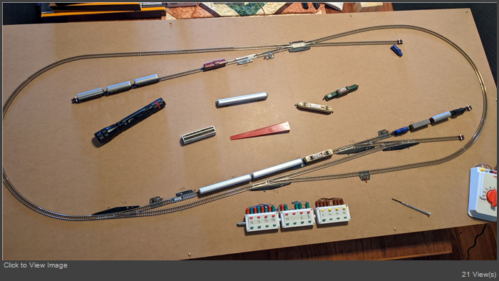

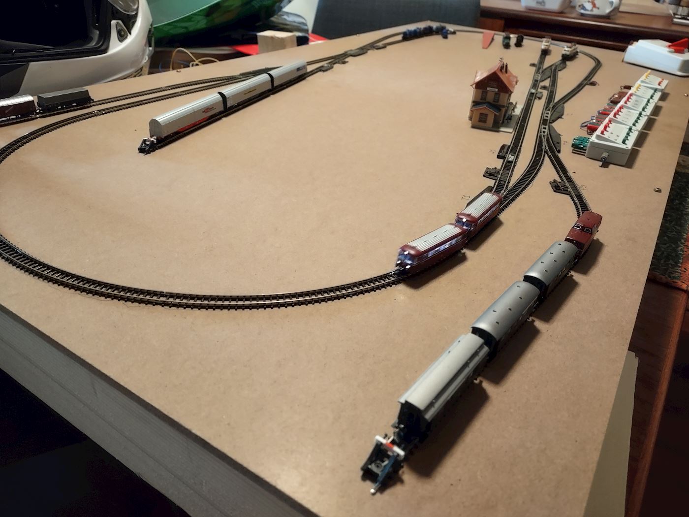

Hello everyone,
During the busy Christmas festivities I was able to set up my starter set and expansion set. I am really impressed as to how well these locomotives run! While my eBay purchases are very nice and run very well, what really impresses me is the little BR 89. It runs so silently and gets on with its job so well.
I seem to really enjoy the tiniest of trains, so I think going forward I will probably focus on small Branch line Locos.
I think my next step is going to be to add some stub end tracks and get some electric uncoupling trucks and try a little shunting.
I'm still slowly working my way through all the literature that you folks have posted here, lots to go through.
And I have to say there's something fun about the utter simplicity of analog. Brings me back to the old days.
Happy New year!

Hello Z scalers,
A few more pieces have arrived and I have expanded my little temporary layout to something a bit more elaborate.
Everything is working just great, the only issue I'm having is that two of my brand new uncoupler tracks, U1 and U2, do not seem to function correctly. When activated, only one end of the shoe lifts up. Before I open these fragile little devices, I'm interested in opinions. Most of my locos and rolling stock decouple no problem on these, but my 88804 get stuck, I'm thinking because the coupler spring is stiffer than the other locos. The 88804 uncouples just fine on my uncoupling track u4 which operates correctly.
Happily I have no other issues with this loco, but my layout is of course dead flat and I've temporarily pinned it down with track nails. The track nails protrude out the bottom of the 6 mm hardboard top enough to enable me to push them back up and pull the nails out with pliers if required. I pre-drilled the holes with a .6mm drill which enabled a nice snug fit as the nails are pressed in with pliers. No hammer! The nails are surplus from a model wooden boat construction project, planking nails.
Happy model railroading!
Best Regards,
Don

Hello, hope all is well
Your layout looks like it is coming along, good progress. Most may use ballast on the track. This gives a cushion to the track and platform. One thing you will discover without ballast is there will be a lot of noise when the trains are run. I noticed that on mine, even with the cork under the track. It will act like a sounding board with an unending resonance. That sound is what some want, it does have an appeal.
Regarding the uncoupler. I believe these acan be somewhat known to be problematic if not kept clean. I looked up on the Marklin site and there are no repair parts for these. I don’t have any, but would recommend verifying the hookup is correct, perhaps some cleaning might be needed etc. the site says there is a manual lever for these also. Does it work manually. If not, it may need cleaning or replacement. Could you compare the functioning ones to the ones which do not work. Perhaps video the operation to see what you might pick up from seeing each working. If you cannot see any obvious issues, it may be time to replace them.
Perhaps a video of this part not working:
Here it is working:
Best wishes, take good care
Dwight

Hello all,
I've been enjoying my little Z scale layout, added a few more sidings, and some new rolling stock.
While this was originally going to be a temporary layout, I have been very happy with it hence no significant changes.
I built a Faller station kit, that was challenging as the parts are very small. Fun though.
I recently received the 88168 Railbus and the 81306 Wine Road set.
The Railbus is somewhat noisy which is a bit of a disappointment as my other new locos are mostly silent. Otherwise it is great, runs very well with nice lighting.
The Wine Road set is excellent! The loco is my first with red marker lights. The Cl 218 runs exceptionally well with very smooth speed control.
I am thinking of raising the rear tracks to introduce some grade. What is the recommended max grade?
IMG_20220704_214620958_HDR.jpgIMG_20220704_215202347.jpgIMG_20220704_195233511_HDR.jpgIMG_20220704_202645169.jpg

Hello Don, great to hear from you and see your changes.
You have some great additions. The 218 set is great. That locomotive worked well with a five poll.
Perhaps a close inspection of the railbus set would disclose the cause of the noise. Sometimes some machining debris is left on a gear or the motor is not completely seated or something. You might need to get out your magnifying glass in a well lighted area. My set is quiet, yours should be too. The many lights on this set makes it a standout when as it travels the track.
Take good care.
Dwight
I've recently started work on another layout so have been revisiting this subject for my own benefit. I would recommend you set a maximum of 2%, less if you can. Your BR218 will be able to pull three or four bogie coaches up that gradient which, I'm guessing, is about the shortest train you'd want to run.
Chris
thanks 3 users liked this useful post by Poor Skeleton
