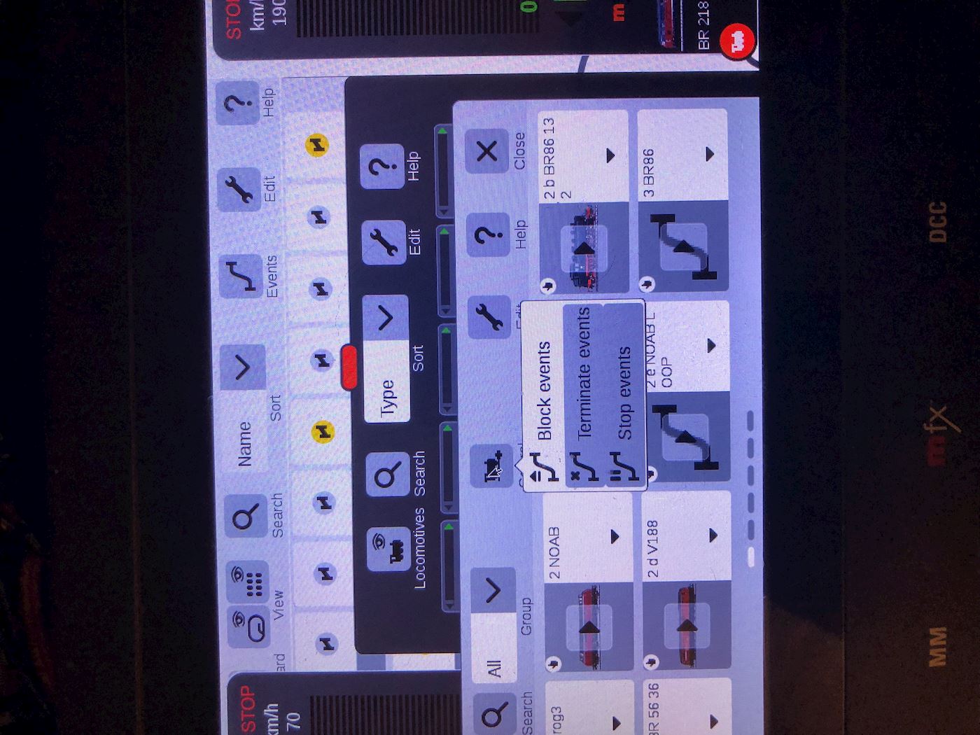

Anybody knows why the two options for terminate and stop events is inactive(grey) while option block events is active and working?
Running my trains on automatic one of the turnouts failed to work and I hit the stop button but I am not able to terminate events(even when stop button is released and there is power on the track. The button in question is on top of the events window in cs3.

My event are homemade and not so E2CBB9E6-AD81-4B56-A3E3-30265C37F890.jpegadvanced. I just monitor the trains and when I saw a train not following my right hand principle entering a station I first hit the stop button… knowing anorher train would enter the track in the other direction. Then I opened the event window and tried to terminate all events and then manually drive the trains back to their starting position. Here I supposed the terminate event creen button would end execution of all events. But the terminate event option is in-active. Even after restart the events continue….

My terminate events are also inactive. I have not recorded any events and thought that was why. Depending on the travel direction of trains, you have to pay close attention as they near a turnout. A W may show up in an event box when a condition is applied. If a train is traveling against a turnout it isn't a problem, but when not, you don't want an event to trigger a point while only half the train has passed through. The remaining cars will enter the turnout of course. Disastrous.

I have not used triggers the «normal» way. I have defined a virtual controlling contact for each block. So chrashes is «impossible». However in this case the turnout triggered but a mechanical failure.. some dirt on the turnout blocked the movment.
I have made the cs3 work now and the contact option is active. Only problem now: I do not know what I did to make the cs3 workConfused
