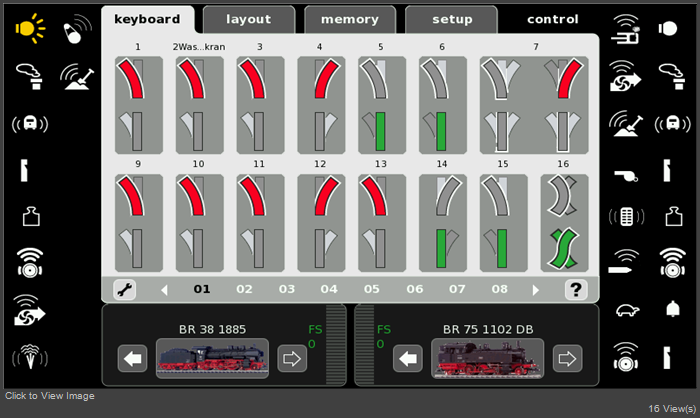

- to create a device (Switch or double slip) on the CS2 in the KEYBOARD tab at the appropriate address

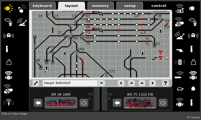

- In the tab LAYOUT start editing and insert the device into your layout

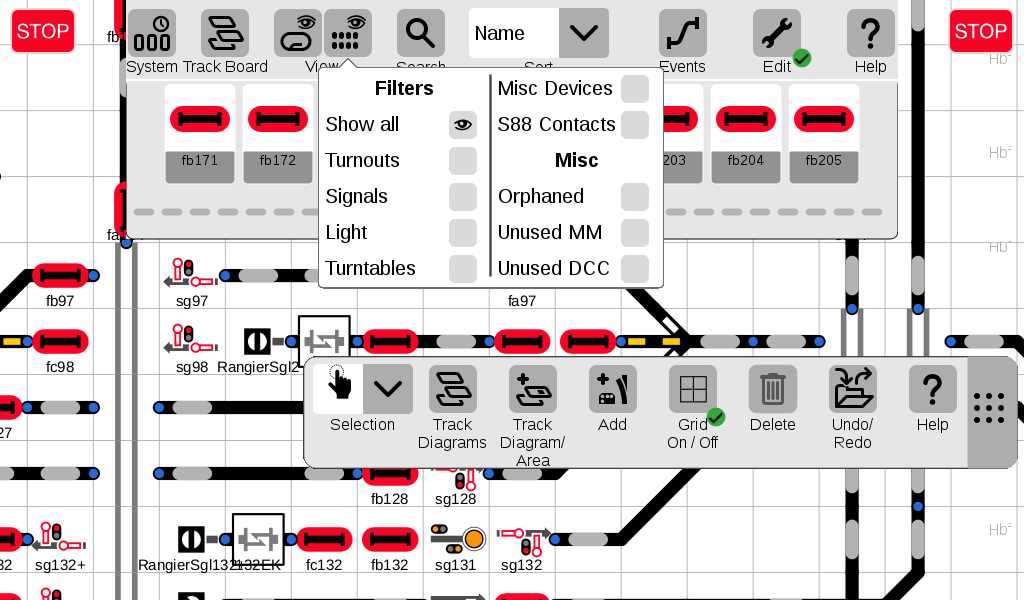

There, it is about click and drag
