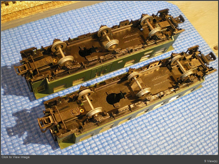

I have a question about the Märklin 4067 / 4079 / 4080 "umbau" passenger cars. Are the wheels of the centre axle of these passenger cars running wheels ? It is strange that you have wheels in the centre that are shorter in length !
Does anybody have an exploded diagram for these passenger cars? Also, can somebody show me pictures of the the underside of these passenger cars ?

Hello Ranjit,
Here are the pics you need. I just dug them out the other day and was contemplating selling them.

Thank you, Martin, Ian and Mike for your useful feedback and comments on the centre wheel assembly for the "umbau" passenger cars !
The axle length of the centre wheels is exactly the same as the end wheels to enable one to put them on the track. THe difference is that there is no pin at the end of the wheels and a metal plate to hold them in place. This arrangement makes it possible to have some play. Yes, I agree with you, Ian. It is somewhat difficult to put the centre wheels on the track.
