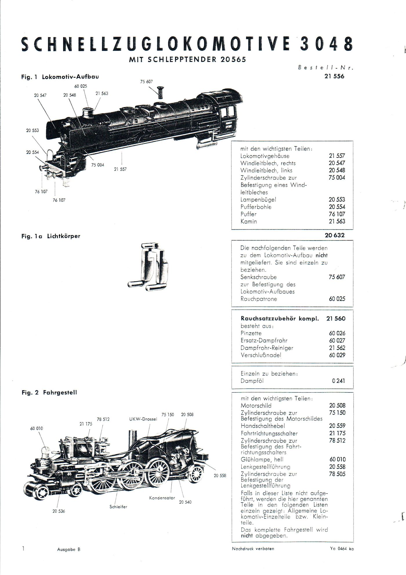

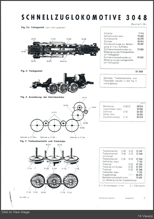

Hi Marco, these sheets may help, they are the original part numbers from this 1964 issue but a quick search usually gives the modern replacement
And the parts listing covering the 3048 from the 0733 Service Manual
Hope it helps

Hi Cookee, thank you for your reply. I have ordered spares using the sheet you have posted. I had found it too weeks ago on Marklin's website.
