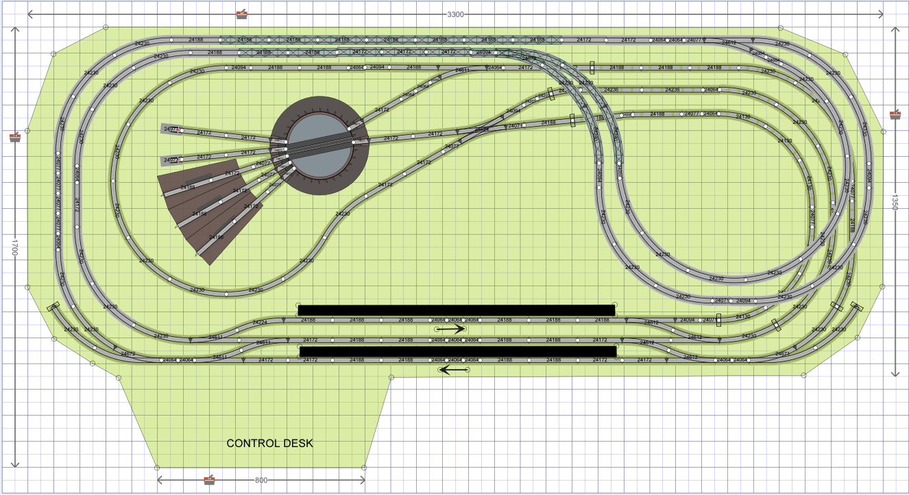

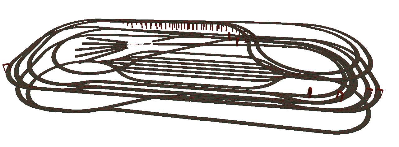

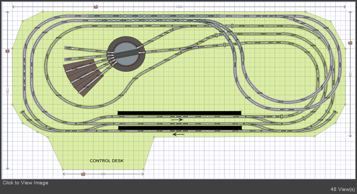

I have created my new layout in Anyrail, its outer dimensions are 3.3m x 1.35m.
Please have look at and give me some feedback before i go ahead and start the bulding process.
My main purpose is to have a number of trains running automaticly which randomly goes down to the fiddle yard and another train enters the main layout. Since i have locos from all eras i'm not trying to replicate any special place.3D_view.PNGFiddle_level.PNGMain_and_upper_level.PNG
Looking forward to some comments. Good or Bad

#2 Posted : 26 May 2021 17:22:55(UTC)
Posts: 4,046
I suggest moving the turntable into the end of the space available. See https://cabin-layout.mixmox.com/2019/08/Turntable-position-in-yard.html for details

Posts: 1,300
Nice layout! I suggest you fine tune with Anyrail for achieving the same track distance in double-track sections, i.e. parallel tracks.

Posts: 2,578
Location: Sweden
Smile
Agree. Especially the two upper level "north side" tracks are probably too close to each other to give enough clearance where the inner track turns inwards. Apart from that I see no problems.

on the left side station entrance I would transition from the curve into the station platforms, rather than having the 'S' bend afterwards.
It will look better, run better and give you longer platforms too.
