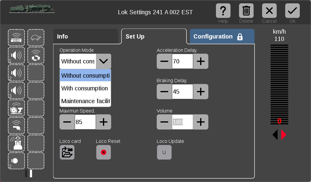

You must first activate "edit" then select edit locos" (bottom red pull-up button)
Then select one of your locos and select SETUP
In the field operation mode select one of: without consumption, with consumption, maintenance facility
ATTENTION: in the mode with consumption you run the risk when a consumable is depleted (water, coal sand) that the loco crawls at very slow speed until you refill all consumables

#20 Posted : 28 April 2021 17:34:50(UTC)
Posts: 3,739
Here is a small video on how to drive any loco using the world of operation (WOO)
1 select edit loco
2 change the loco status from without WOO to a selected driver seat
3 validate
4 assign the loco to the left control
5 swipe the left red loco symbol, all the way to the right. Then the selected driver seat is displayed
6 to leave the driver seat, touch the red loco icon on the right and slide it all the way to the left
