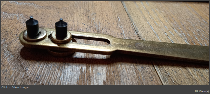

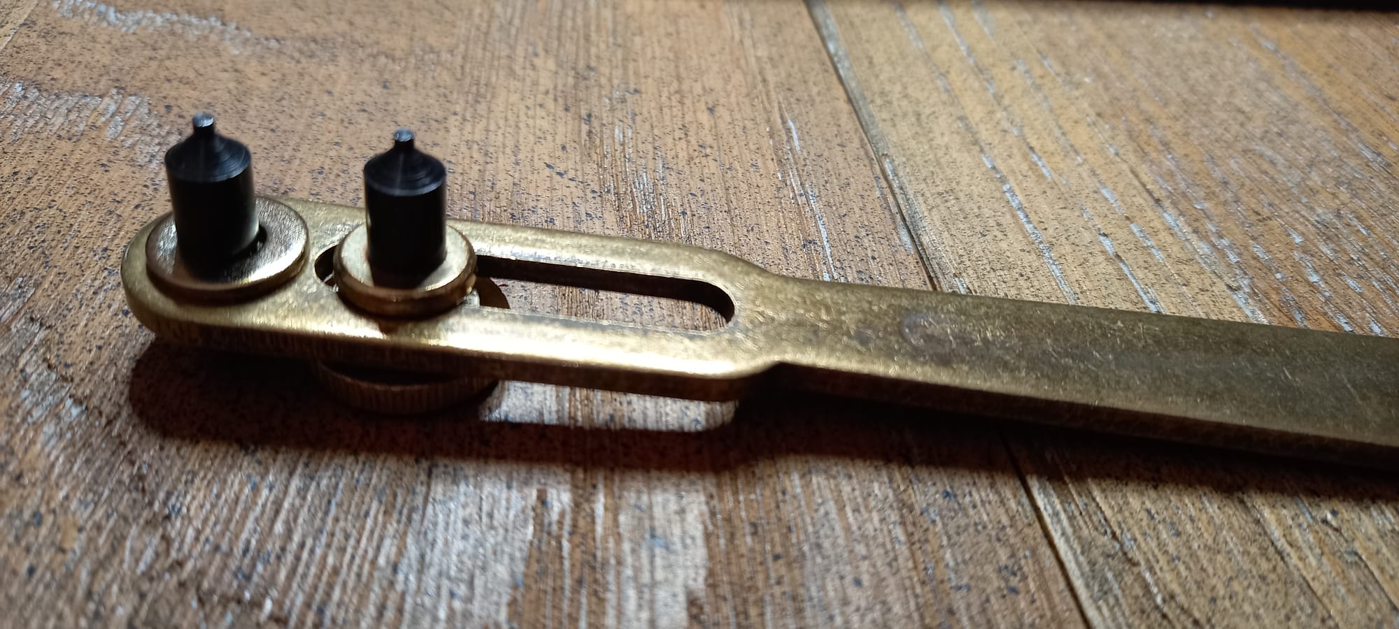

So once the problem was identified, the desire was to obviously eliminate the phenomenon, having time and doing tests on tests I could see that the problem therefore
It resided on the left axes and therefore the right ones were to be taken as a model for the so-called quartering (i.e. each wheel must follow the previous one by 90 ° up to the driving wheel).
But unfortunately this was not enough as I read here and there that once this quartering has been fixed there is also a small tolerance that can give problems and in fact there was a point during the rotation on the left axes where the main running gear. that is, the one that connects all the wheels made resistance and therefore not only raised the left front wheel, but also caused a jolt of the loco.
The wheel that in the end remained witness of the now small phenomenon remained was the left front wheel which was the one that had the most tolerance of all and which by hand was very difficult to move a little for fear, a little for inexperience and a little because they slip between the fingers.
Then a tool I used to change the batteries of watches came to my aid: a case opener that I would like to submit to you as a tool to be included among those useful for site maintenance (maybe there is a similar one for this hobby and I didn't know it)
Of course I am also attaching the video of the wheels finally adhered to the tracks during the left turns
and with its cloak and tender
Hello everybody ThumpUp
