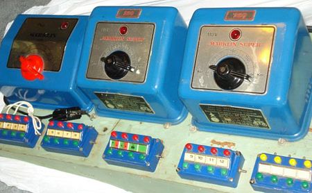

Greetings,
I am looking though my old Marklin collection, thinking about selling most of it.
Question: Are these old transformers still safe to plug in? Are they worth anything? Some of them are very heavy. Last time they were plugged in was the 1980's, but they have been stored in a very dry, clean and temperature stable room (Under a bed)

Are there some 280 A transformers on the picture?
Be very careful when you plug them in.
See here:
https://www.marklin-users.net/forum/posts/t32687-
#3 Posted : 24 March 2021 10:31:44(UTC)
I would get them all checked by an electrician, but a quick way to tell if the 280A transformer wiring has deteriorated is to take the mains plug off the cord. Check the rubber insulation on each of the wires. If it is cracked or dissolves to pieces when you touch it, it is a fair bet it's the same inside the transformer and therefore an electrocution risk.
But do get them checked by a qualified person.

I would normally advocate keeping old things going but in this case I don't think they are worth the bother. I would put them to one side and find either blue plastic ones or white plastic ones which are all much newer and available second hand.
As to value, it is very little and postage costs are high.

The one on the far left is from the 1980's. The other two are kind of sketchy! I think the door stop idea is probably wise. (Then I am gonna open them up and see what makes them tick...or take them to the recycling center in the city where I live)
Yes, it appears to have a plastic case if I am not mistaken.
With the six sockets on the back they are really old, going back to the mid-1950s at the latest. You would probably find a scrap metal dealer would give some money for them, otherwise your local recycling center if you don't have a use for a couple of hefty door stops.

The one on the left is an early 60's transformer, I got one at Christmas '63 with my first M train.
It was driven to the local recycling station about 5 years ago since the rubber cord was hard, cracked and disintegrating...
I had repainted it green in my youth and it looked like sh-t anyway... BigGrin
At the same trip to the recycling station I also got rid of a 280A and a later 60's 30 VA transformer with the same shape as the left one but it had a "sharper" dial and more modern black print on the metal sheet.
