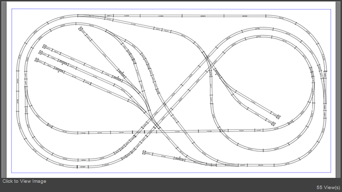

I don't know how to make this open automatically so you'll have to download it I guess. I saw this layout in an ETE Express presentation and remembered it from when I was a young teenager. It was in an Atlas Tool Company magazine "Six Layouts for Custom-Line Track". I still have the book. I decided to have a go at converting to C-track using Scarm. Atlas and C-Track geometry doesn't match up due to different angles on turnouts and crossovers but I think it came out pretty well. The double track is on bridges above the yard tracks below.

The addition of a pair of left hand R3 curved switches in the upper right hand corner double track would improve operation by allowing out and back running from the yard.

Nice thing with M is no special wiring needed!
The track plan does not hold any return-loops, and as such does not need any special wiring in 2-rail either.

Agreed Henrik, but if you add the cross over I spoke of it creates a return loop. Operationally more interesting.

The Granite Gorge is probably my all-time favorite HO track plan. Matter of fact, at the age of 13 I built a DC HO layout following the step by step plans and instructions provided by Atlas. I have often thought that the track plan would make a great Marklin layout too. So, thank you for converting the plan! Question: How closely does the Marklin plan mirror the Atlas plan? I’m asking because the framing that Atlas engineered might have to be re-engineered to accommodate an altered track plan.

The plan is close but not exact. This would be an issue around the bridges. Using standard open benchwork or Linn Westcott's L girder system it shouldn't be much of an issue. Just use risers instead of the blocking system the Atlas plan uses.
