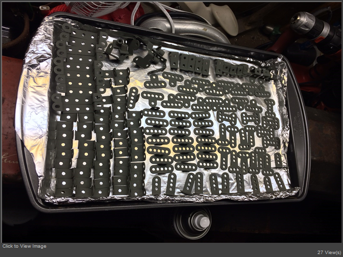

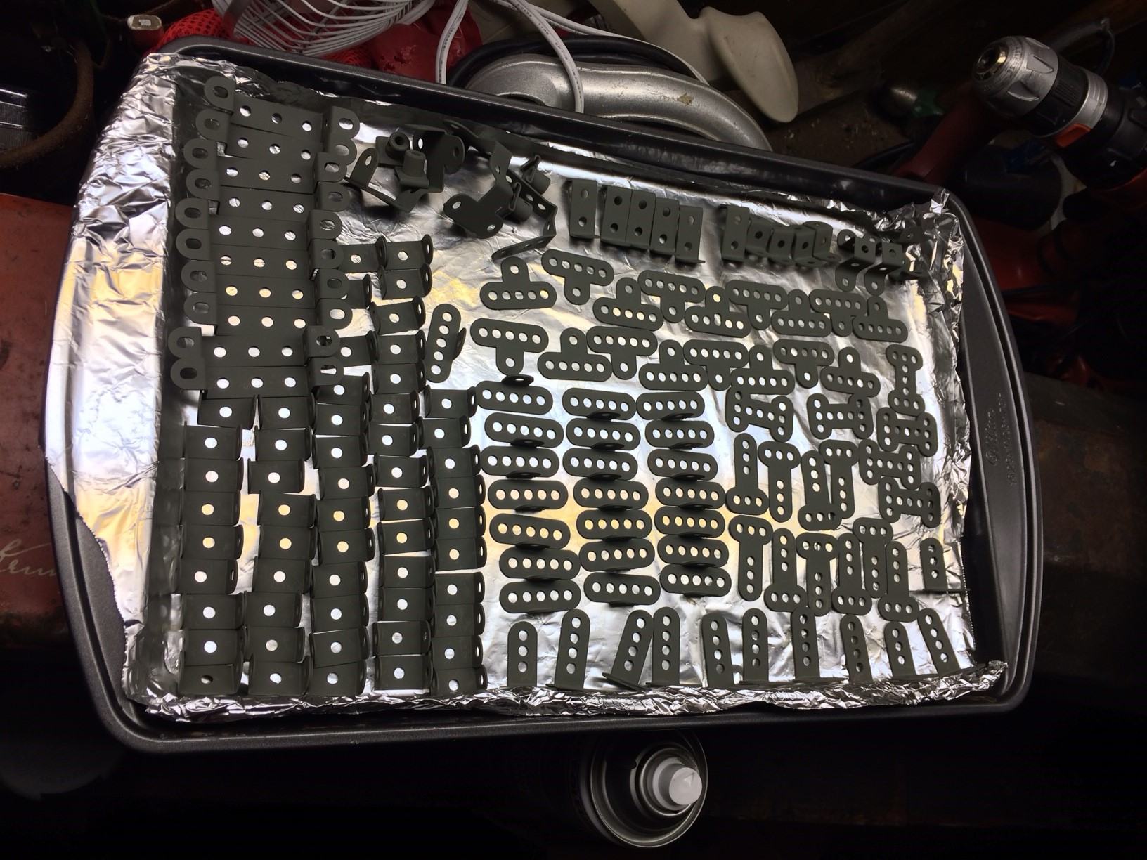

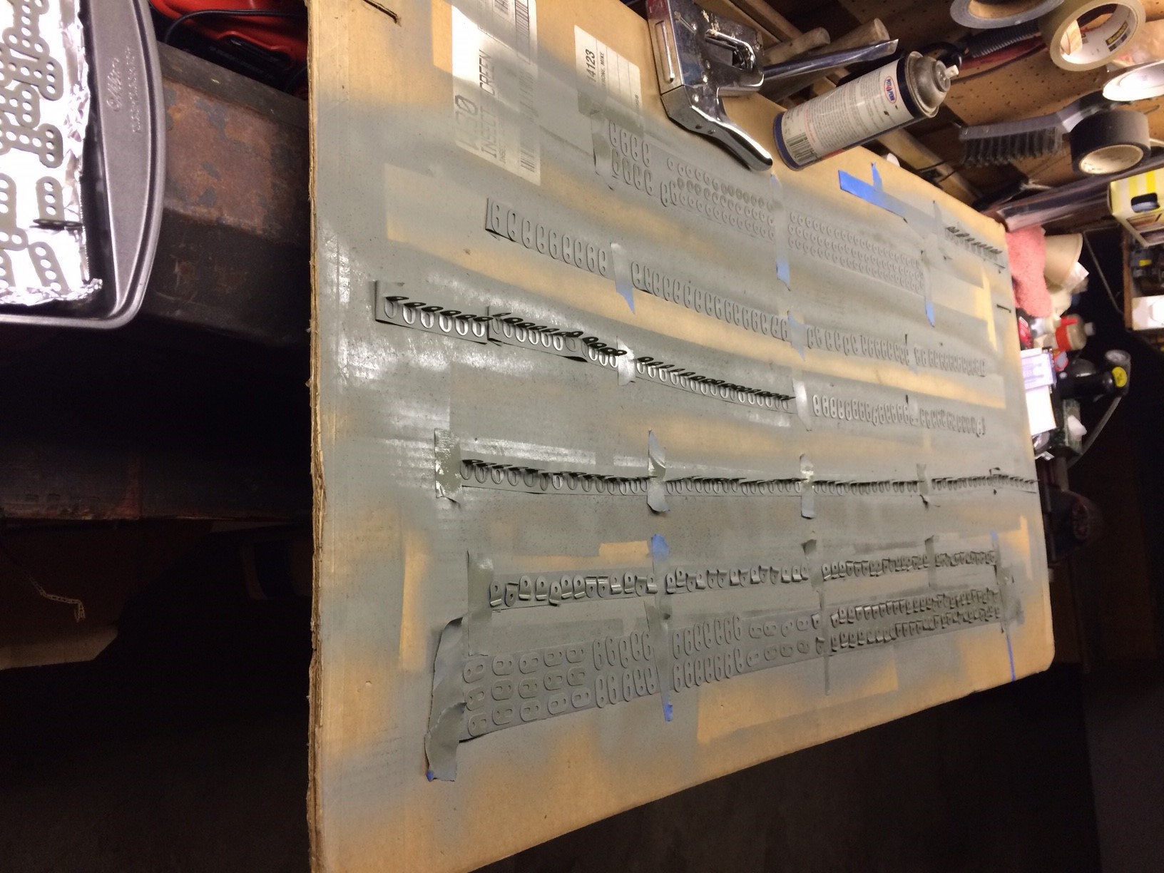

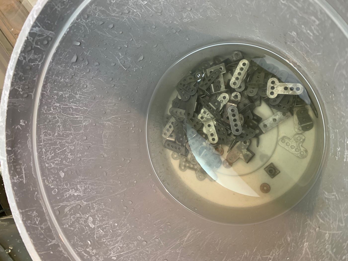

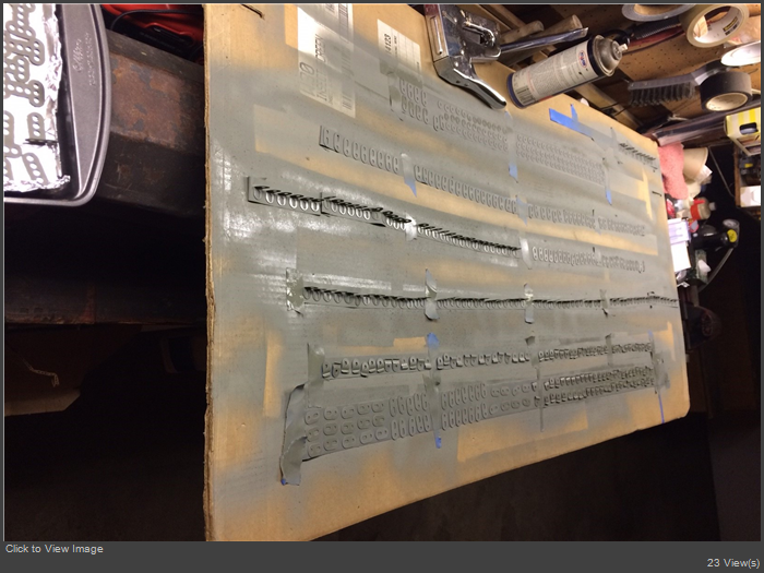

Some images from the field. As mentioned, the painted parts were good, the black anodized parts were not. Very strange. So a (much bigger than intended) restoration and futureproofing job was done on the black bits:
- Acid bath (vinegar 100%) for 2-3 days
- Scrub
- Neutralizing solution dip, baking soda and water
- over baking to 100% dry
- Etching primer, 2 coats to 100% seal the metal (may be overkill, but at this point I wasn't cutting corners)
- 2 top coats in black
Black is currently drying, but some images from last night's primer are below:
