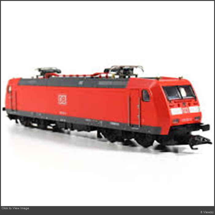

I have recently inherited an older marklin loco
It has an FX decoder, but I was still able to find it ok on the CS3 Database. It installed ok, and lights worked direction ok, but the speed is very slow, when on max speed it travels at about 25% the speed of my other locos. I thought ok service it, and I had it oiled etc by a couple of expert friends.
After retesting for 1 hour in each direction, the problem still remains. I could upgrade the decoder 60977 or 60949, but wether this solve the speed problem, i am not sure.
Any ideas, or similar expierences Confused
Tim

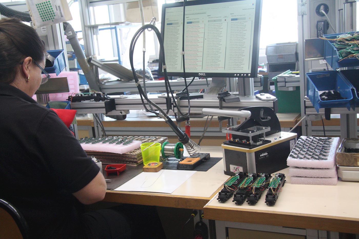

The decoders get programmed on the production line immediately before they get put in the item. I watched this happen at the factory at the last IMA. The person on the production line takes a programmed decoder out of the programmmer, puts another one in the programmer, then fits the one taken out into the loco or whatever it is to be fitted to.
here it is happening ...
The black box on the ladies right is a gang programmer, doing what looks like up to 4 decoders at a time, judging by the lights on the front of it.

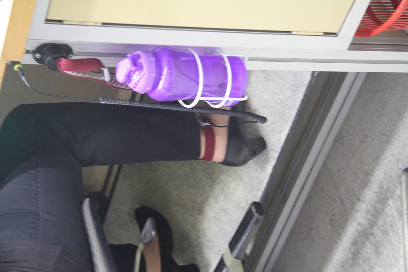

The lady doing this operation had her anti-static strap attached to her leg ...
I just hope she didn't have nylon stockings on at the time ... Scared

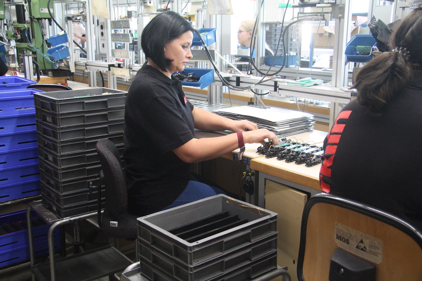

Another lady had her anti-static strap attached to her wrist ...
