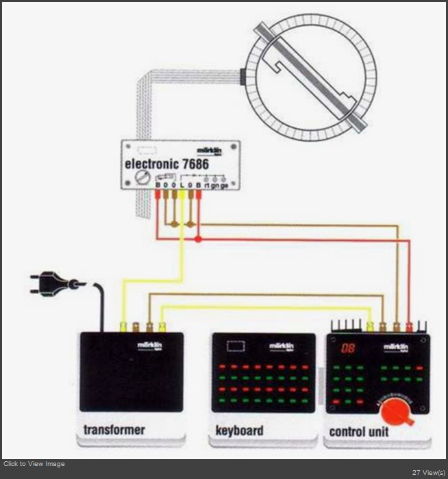

How would you go about connecting a 7186 turntable (not 7286!) to the 7687 decoder?
The decoder box does not contain a ribbon cable. The 7186 does not have a ribbon cable. The connection diagram in the decoder and the 0308 digital book show a ribbon cable.
Thanks and best regards,
Tony

You can't, at least not without major modifications to the turntable. The 7186 is an analog device. Therefore it has no way to provide any feedback to the 7687 decoder which is a digital device. That feedback tells the decoder the position of the rotating bridge of the turntable.
There are different ways to automate the 7186 like sensing the track current from the spoke tracks. (the spoke tracks are not powered up until the bridge is aligned with one and that can be used to determine the bridge position). But that requires building some device to do that.

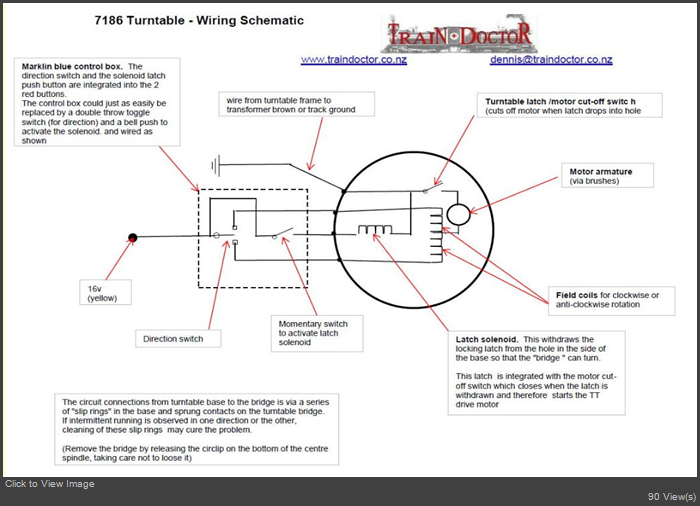

The key difference between the 7186 and 7286 TurnTables (TT) are:
- 7186 has a "universal motor" (both for AC and DC)
- 7286 has a DC motor
Here is the 7286 wiring (note that the 3 diodes on the TT are not represented)
As you can see the contact in the TT which opens in front of each track position can be used to report the position
The 7186 wiring (thanks to thetraindoctor.co.nz)
The wiring diagram is extracted from the train doctor as seen from here http://thetraindoctor.co...186_turntable_hints.html
I don't know the 7687 decoder enough to provide further guidance.
I hope this helps

As others have pointed out the two turntables use different motors. The 7286 uses a DC motor, so if the polarity to the motor is reversed the motor will turn the opposite direction, allowing the turntable to turn either direction.
The 7186 turntable has a "universal" motor which will run on AC or DC - but with DC unless you reverse the current through the magnet it will always turn the same direction (irrespective of the DC current direction) - which is the reason it will also run on AC.
The motor as fitted to the 7186 turntable uses standard loco motor parts, so what you COULD do is use a loco upgrade kit to change the field coil magnet to a permanent magnet, and fit a 5 pole armature. I would recommend changing to a 5 pole rotor as this may be needed to get the current low enough for the 7287 decoder to handle, the motor in the 7286 is quite small and geared well down, and I don't know what the current carrying capacity of the 7287 is.
You may then need to look at the release solenoid, to see if the driver for that has enough grunt. Again the solenoid in the 7286 is quite small. At worst it may be necessary to rewind the solenoid with more turns of finer wire to get the current low enough, but there is a trade off when you do this. It may be better to have the decoder operate a relay that then drives the solenoid.
Offline HerrDoktorBD

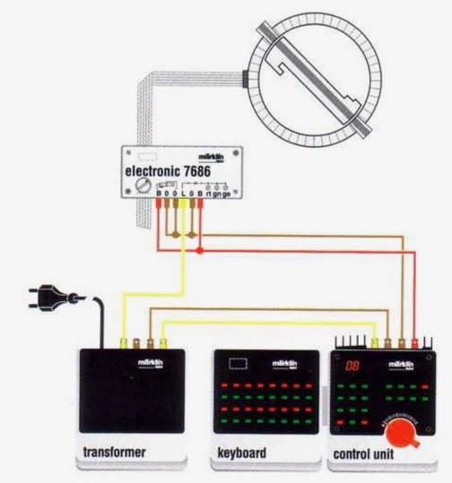

I'm partial to a motor upgrade and also a relay to operate the solenoid. But I'm still unclear about the ribbon cable wiring to the 7687 which has six wires.
This diagram:
and this:
http://www.hjb-modellbahn.de/Elektrik/Elektrik.htm
is taking me down the German internet rabbit hole.
Edited by user 30 August 2020 19:21:12(UTC)  | Reason: Not specified

Don't use the 7867 with the 7186 TT as you will destroy the stepper motor control in the device.
Use a m84/k84 device to replace the push button panel.

I like to convert old analog stock to digital operation. Posts about the 7186 turntable were not working for me, but here is my solution.
The primary issue is digital power vs old AC power to turntable, while also controlling the k84 decoder. The turntable will not function with digital power, so the yellow lead must come from an accessory transformer that shares ground with track (or turntable ground).
The k84 is needed for left/right turn (#4) and the long pulse (#3) to get going; k83 for solenoids won't allow control. Importantly, once the k84 unit gives a start pulse it needs to be turned off. The turntable will continue to rotate (with less noise) and stop at next closest track (just like old manual switch does).
The k84 start and stop is easy to program in cs3, but is manual for older intellibox. Maybe there is a more clever solution to stop pulse in older digital drivers.
Pic of k84 connections is below. Yellow and white go to accessory transformer; red and brown to digital power. This works for me.

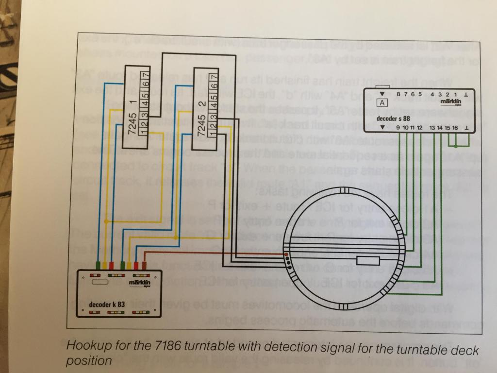

Since the request was for a 7186 I would stick to the original product!!!
This is what I found in the Marklin Digital booklet.
You need an M84 or the components shown in the picture.
I recall Marklin telling me that the m84 is better to manage the 7186, compared to the m83
2 x 7245 universal relays
1 x K83
1 x S88 if you want to program the tracks (to me useless)
I have managed to get the crane to work in this same configuration, more or less.
HTH
Marco
Offline ocram63_uk
#18 Posted : 01 February 2022 14:02:26(UTC)
ocram63_uk
Joined: 07/01/2015(UTC)
Posts: 739
Location: England, Suffolk
Sorry, forgot attachment :-(
Here it is
