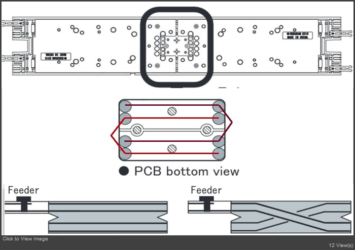

Does anyone have a Rokuhan R078 Double Crossover and know how the springs and PCB works? The manual shows non-power routing with track power from just one track (all 8 springs mounted).
I would like to feed the upper half from one track and the lower half from one track also. Is this possible with the tracks on the upper half not connected to the tracks on the lower half?

Tanks for your answer. For DCC all springs are in (non-power routing) and the power goes everywhere.
I have DCC too, but I am also trying computer control. The track leading in to the upper half is one freedback section and the track after is the next. Same thing for the lower half. That is why I want to have the non-power routing per half (two A013 to the right).
The first picture shows the full non-power routing and how I guess the PCB board works.
If I had a R078 I could try to figure out what each spring connects and how the PCB distributes it. Maybe the PCB can be modified.

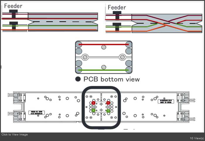

The second picture is how I would like it.

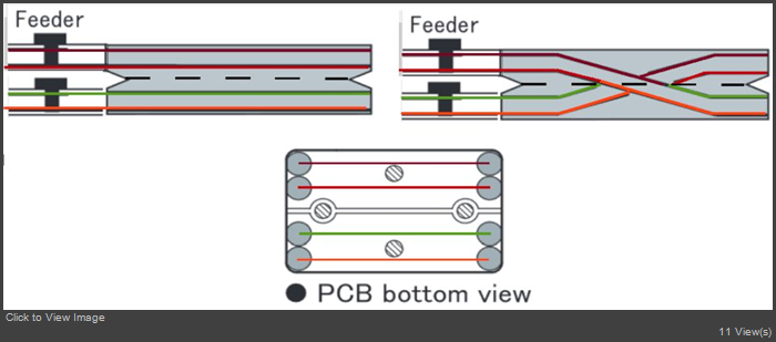

I promised to came back with my findings but it didn't arrive here until yesterday. Anyway I think I have figured out how to rig it for my purposes. As far as I understand the two center spring on the upper half connect internally in the crossover to the lower half outer rail. I just added the 2 top most and the two bottom most springs. Thus connecting the upper left turnout with the upper right turnout as well as the bottom left with the bottom right. No connection between top and bottom tracks.
I tested it first with one feeder track. When straight the engine went back and forth but stopped in the middle when thrown. With two feeder tracks the engine went everywhere. Just as I want.
I didn't think I would be able to fiddle with these minute things but I thought inside the box. I used an empty shoe box with the crossover and bag with springs and screws in it. To place a spring I used a needle and treaded it inside the spring. Then I placed the tip of the needle in the hole and let go of the spring. I didn't lift the needle until the spring had fallen into the hole.
