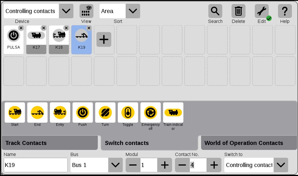

Offline gamolina
#7 Posted : 29 May 2020 21:40:33(UTC)
gamolina
Argentina
Joined: 03/10/2012(UTC)
Posts: 58
Location: Buenos Aires
Hello, they are as "internal memories" for events.
You can create them in "Controlling Contacs Switch Contacts" see picture
Then you can use them in Events, as a normal S88 contact
Greetings
