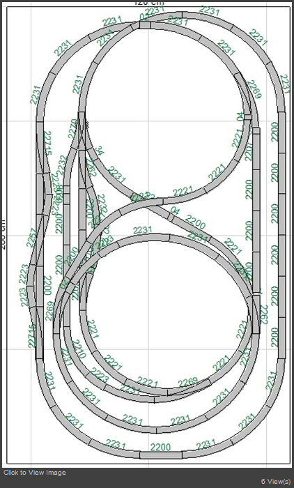

Building lay-outs for some years now, left me with a good supply of spare tracks. Mostly K-Track.
Now I was thinking to use this surplus and build a small lay-out for testing, programming/adjusting and runing newly bought trains, before unleasing them on the main layout. Say 1.00 x 2.00 metres max. to be installed on a board of wood, which I can put a side easily.
My idea would be to include especially those K-Track items which could possibly cause a problem for a train, waggon or coach.
Think of:
sleek switches 22715 and 22716
cross section 2257
3-way 2270
a variety radius of curves
curved switch 2269/8
lanterns attached to switches
inclinations
What are your thoughts?
Rinus

#3 Posted : 12 December 2019 17:52:55(UTC)
Posts: 3,652
Rinus; Very good idea!
You should definatly install some difficult zones of tracks. Especially S-curves and all the crossings that you mention.
However, I would also be sure to install a rather simpel (outer?) oval track, which can be run without much challenge to the train.
F.x. to be able to run-in locos. -Even if a train cant handle difficult trackage very well, you might still need a track where it can run for some time, without you having to observe and be too worried about mishaps...
I woudlnt do any gradients, if you need to be able to store the thing easily and in a small space. Maybe it can be done separatly, like a ramp that is hinged in one end, and can be opened up to try out differetn heights.
Also, I would be sure to install some tracks where one of the rails is isolated, in order to see behaviour on contact-tracks (and reduced ground-contact).
PS: "With or without landscape?" -That depends; Do you think it is necessary to test the train for different types of landscapes? ;-)

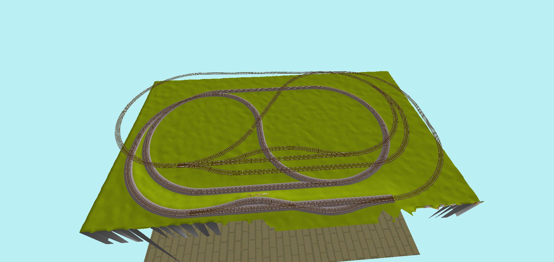

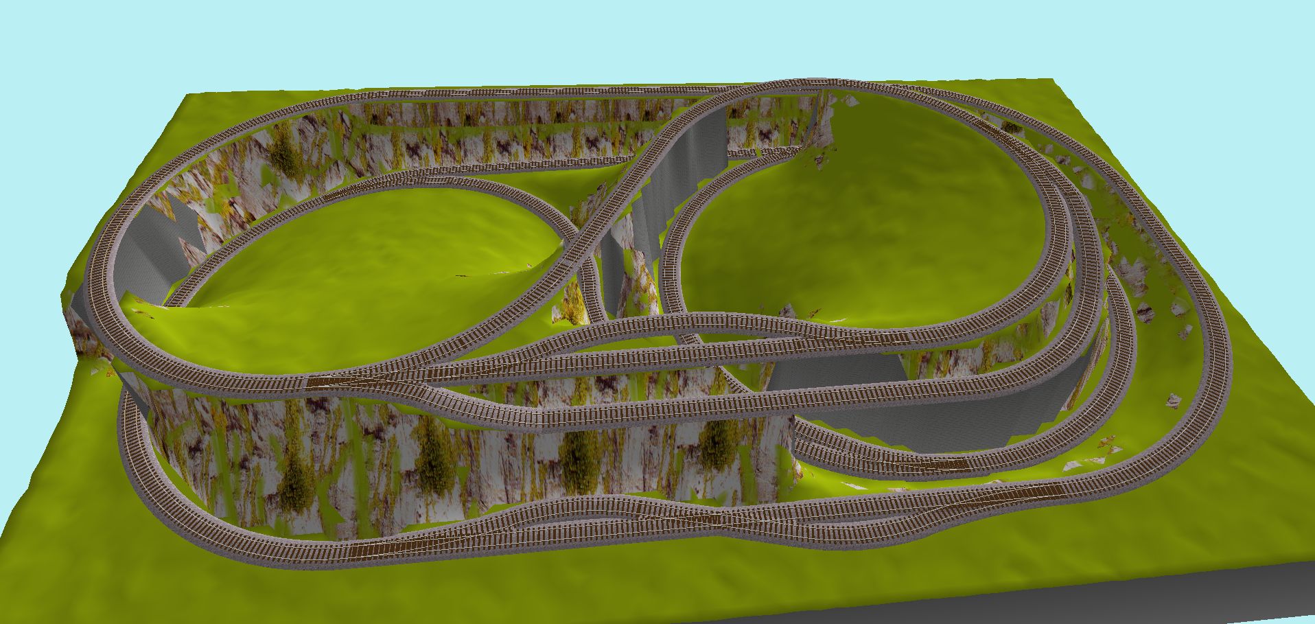

#5 Posted : 13 December 2019 12:29:51(UTC)
Rinus
Joined: 20/02/2005(UTC)
Posts: 1,729
How about this? Its with a 2.5% and 4% inclination.
thanks 1 user liked this useful post by Rinus

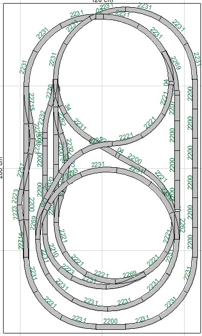

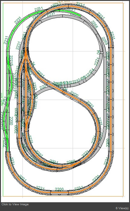

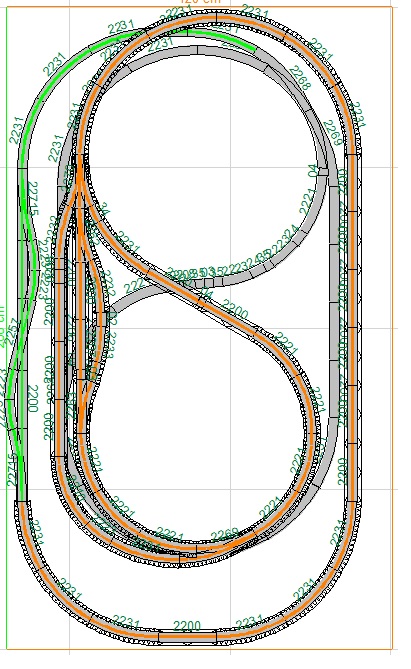

#6 Posted : 13 December 2019 18:40:28(UTC)
Rinus
Posts: 1,729
Some changes:
What do you think?
Wanted to include a 8 by using a cross section on the base plate but I could not get it fit.Confused
Rinus
