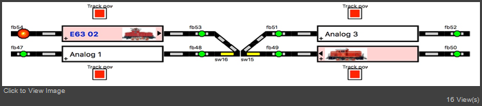

Meanwhile, I continued my experiment by adding a k84 for controlling track power. The setup I ended with is shown below (I only include the relevant part of the total layout).
As shown above, the setup has now four blocks connected via two switches. Notably, I have placed two analog locomotives on the tracks. As before, the switches and the sensors are run by Rocrail. In addition, I have added a k84 that can switch track power of the individual blocks on and off; it is visualised as four pushbuttons next to the blocks. In the picture, all buttons are off so that all blocks are disconnected from track power. (The switches have their independent track power supply that is always on.)
How this works is best shown in a series of pictures.

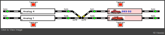

In the picture above, I have used drag and drop routing to send the locomotive "E63 02" from block "Analog 4" to block "Analog 3". When the route is locked, its associated commands turn the switches as needed, and in addition command the k84 to turn track power in blocks "Analog 4" and "Analog 3" on. Therefore, the related buttons turn green.
I use the white trafo to run the locomotive towards its destination. In the status shown above, I have reached the "enter" sensor of block "Analog 3", acknowledged by Rocrail by showing the loco image also in the destination block. The other loco, V 60, stays put: its track has no power.
When the loco reaches the "in" sensor, the route Analog4-Analog3 is freed. Block "Analog 4" is opened for other use, likewise the switches. In addition, the track power of two blocks is turned off by appropriate "at free" commands in the route definition. So Rocrail actually stops the loco once it reaches the "in" sensor by cutting off its power!
Again, I think this experiment shows the feasibility of this approach. Of course, more complex logic will be needed if the locomotive is just passing by a block towards a more distant target - in this case, the power of the starting block should be turned off, but the power on in the intermediate block should be left on. I believe this can be done quite easily with XML macros.

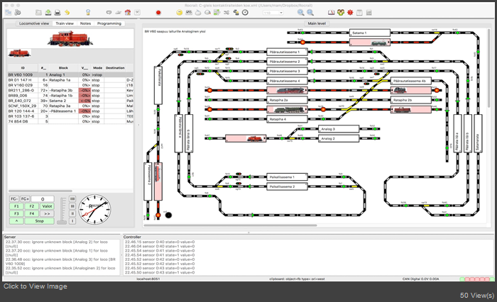

I have now built a simple analog layout that utilises the ideas described earlier. I nevertheless left automatic direction change out; it was difficult to get it work robustly. I don't mind changing the direction myself.
The Rocrail screen for the layout is shown above. The setup is powered by two transformers. One provides voltage to the main loop controlled by the four signals; the loop runs fully in automatic mode. The second transformer is used to run the inner tracks. Two K84 units switch the power of the eight inner blocks on and off on the basis of route activation.
Although I built the track in my study - a smallish room - I think I should be able to run about 140 cm long trains on it. So the track should offer welcome physical exercise to my 30-some analog locomotives that have stayed in rest too long already.
