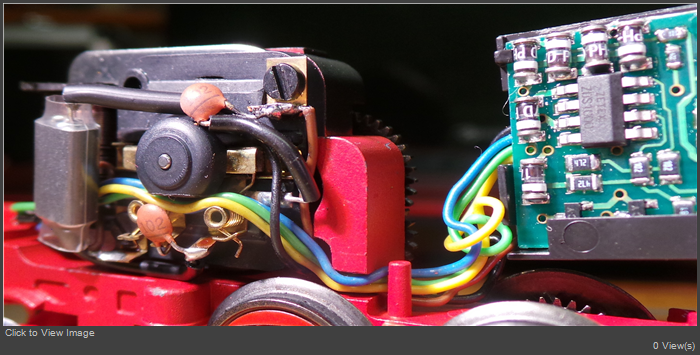

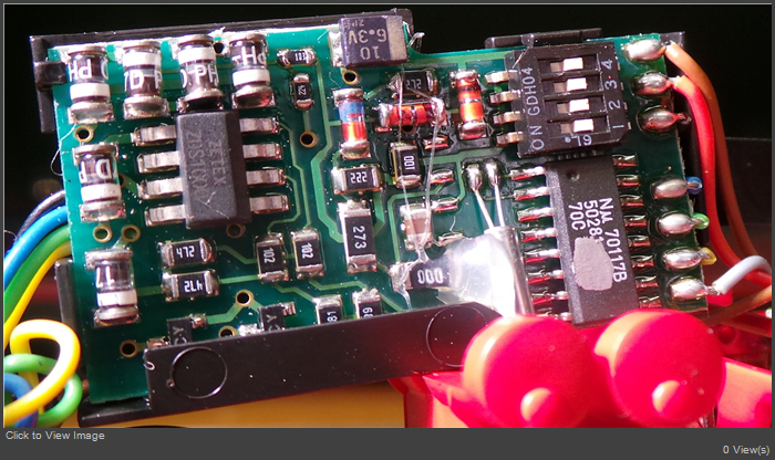

Hello Jacques
I have created an album with 16 images in of the afore mentioned Loco without the top on for you to look at, As you can see the switches are all set to standard mode and nothing looks burnt or damaged as far as I can see.

Address on that should be 78. That is switch 1 up & 2,3,& 4 down. Enter address 78 on you controller & see what happens.

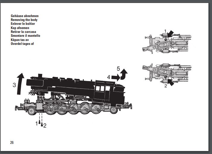

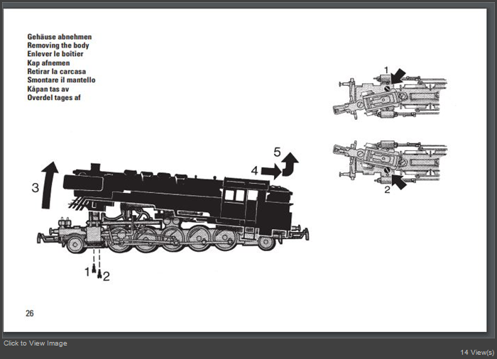

heres some pictures to help you out Wink
PDF of the manual with spare part numbers to use in future( the model is a bit newer in this but it uses the same moulds so most of the stuff still applies)
https://static.maerklin....a4cc80101e1434541692.pdf
thanks 1 user liked this useful post by Antti
Offline TEEWolf
#15 Posted : 07 November 2019 19:11:35(UTC)
@A7Bicester
are you shure this loco is digital?
Looking at the explosion drawing listed by @Dave Banks post #13, then the part #34 in the spare parts list looks like a "Fahrtrichtungsschalter" (direction-of-travel switch). Never seen a digital loco with such a switch inside. These switches were used for analogue locos. A decoder I could not find in the explosion sheet.
Also the motor looks like a 3-pole engine instead of a 5-pole high effinciency one.
BTW I bought via eBay an old loco as well, which was offered as a digital one. When it arrived, no documentaton were supported and the loco showed the same running behaviour as you describe. I opened the loco and well it was not digital. It is analogue one.
Offline Antti

Hello Teewolf, the exploded diagram covers the analog/delta/digital versions. You will see small inset diagrams admittedly not very clear covering the delta & later on the digital setup. It is only a sketch of the way it is connected but does show the boards. #33081 is a Delta version. If Richard would be so good as to upload a photo of the electronics of the loco following Antti explanation of how to get the shell off then we will all have a clearer picture of what we are dealing with.
https://static.maerklin....fe3ffe53a41434542494.pdf
Yay Some success, I have done what you advised here and I have control over the loco at last using the MS2. I went in to "Enter Manually" then "MM2 Coding Switches" and changed the address to 78, this gave me normal operating functions over the loco. (Forward, Reserve, Speed, Start & Stop).
Do I also have to set the address to 78 under the "MM2 Programmable" & "DCC" menus as well?
On the MS2 screen on the left hand side I have the following: "Lightbulb" Icon - F1 - F2 - F3. On the Top right hand side of the screen, a "Turtle" icon, When I press any combination of the buttons nothing happens.
Were getting there slowly and I thank all who have helped me in sorting the problem out, the "Seller" is just not interested and refuses and contact with me. I feel the need for some negative feedback.

Originally Posted by: A7Bicester Go to Quoted Post
glad to hear you got the old gal working! Laugh the functions F1, F2 and F3 are just default functions for FX and MFX locos they wont do anything on a Delta loco. If you enter a delta loco through MM2 programmable the MS2 thinks that its just a regular FX loco and gives you the functions. On a Delta locomotive you only have forward and reverse and a constant smoke unit if the loco supports it. If you have an FX loco with some functions for example a whistle one of the function buttons (F1, F2, F3) would activate it. the "turtle" function is a standard feature on every FX and MFX and it basically just disables the acceleration and breaking delays or in short "direct control"
