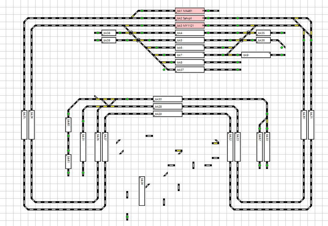

My RocRail progress is here, please bear in mind it is work in progress!

Now in the case of your example, I and many others have the same situation - different length blocks and trains.
What you do is have the shorter trains occupy the shorter blocks only and the long trains occupy the long blocks only.
This way there is no wasted space and no occupancy blocks due to short trains taking up long blocks that only long trains can fit in.
You need to specify the block lengths in their config and also specify your locomotive and trains lengths.
This will prevent long trains trying to stop in a short block, as they will only use a route of sufficient length.
There is a global automation setting 'select shortest block' you can use, or alternatively (and the better way) is to restrict/allow routes for each of your trains based on lengths.
The latter is better because it then allows randomisation for destination in the stations, though you may not want that.
With select shortest block it always selects the same block even if 2 blocks are the exact same length. I know because I've been through that trouble before Cursing
