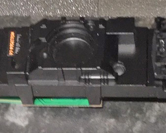

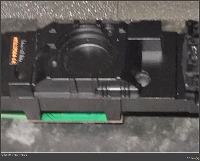

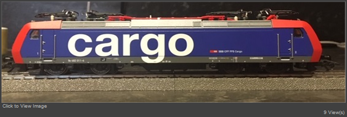

I bought this loco from Rails for £80 knowing that it just had a decoder and no sound. I have taken it down to my local DCC specialists, Coastal DCC and between us we have opened it up to find that it isn't just a simple task of taking out the Marklin decoder and putting a LokSound decoder into it, then add some speakers. The decoder is an old fashioned built in job. The cost of making this sound fitted would be out of my budget so I have decided to have a second look myself.
Way back in to late noughties, I had a shop that sold DCC stuff and di a lot of decoder installs including N scale split chassis locos so I have a fair idea of how to go with this myself. However, I am looking for hep and inspiration before going ahead.
I append some images of the situation. Is there a Marklin way out of this or do I have to buy the stuff and just wade in?

There is a Märklin way: get Märklin 60979 or try to find a discontinued Märklin 60949. You will keep the yellow LEDs this way.
You can get a decoder board from Modellbau Schönwitz along with red and white LEDs incl. long-distance headlights. You also have to buy a decoder if you go this way, could be ESU or Märklin or other brands. For a few bucks more you get white LEDs.

Well this is what I did for 36851 Elektrolokomotive. BR 482 (SBB/CFF/FFS) :
http://luessi.ch/shop/catalog/p...ath=2&products_id=36
or http://luessi.ch/shop/catalog/p...h=2&products_id=2362
http://luessi.ch/shop/catalog/p...h=2&products_id=2345
https://www.stayathome.ch/Re482_decoder.htm
And add the sound decoder of your choice. I found this a very simple easy way to upgrade the loco.

Maerklin has a kit for conversion of these models. If you get the Trix circuit board, you can order that and use them to install a ESU or other 8-pin decoder.
The Maerklin version only worked with the in-house decoder.
You can add an aftermarket PC board by Luessi or other, plus a decoder.
In my opinion, the Maerklin kit might be the cheapest option.

I have now installed the Marklin conversion. It went like a dream except for one thing. One of the tabs from the motor broke off! Fortunately, I could get to the base of the tab so I soldered a wire in and everything works fine. The conversion took about 20 minutes.
The loco now runs a lot smoother than it did although the sound is fairly quiet. The volume setting is on max so I guess that's about it. I bought the loco from Rails for £80 and paid £90 for the conversion. NOt too bad.
