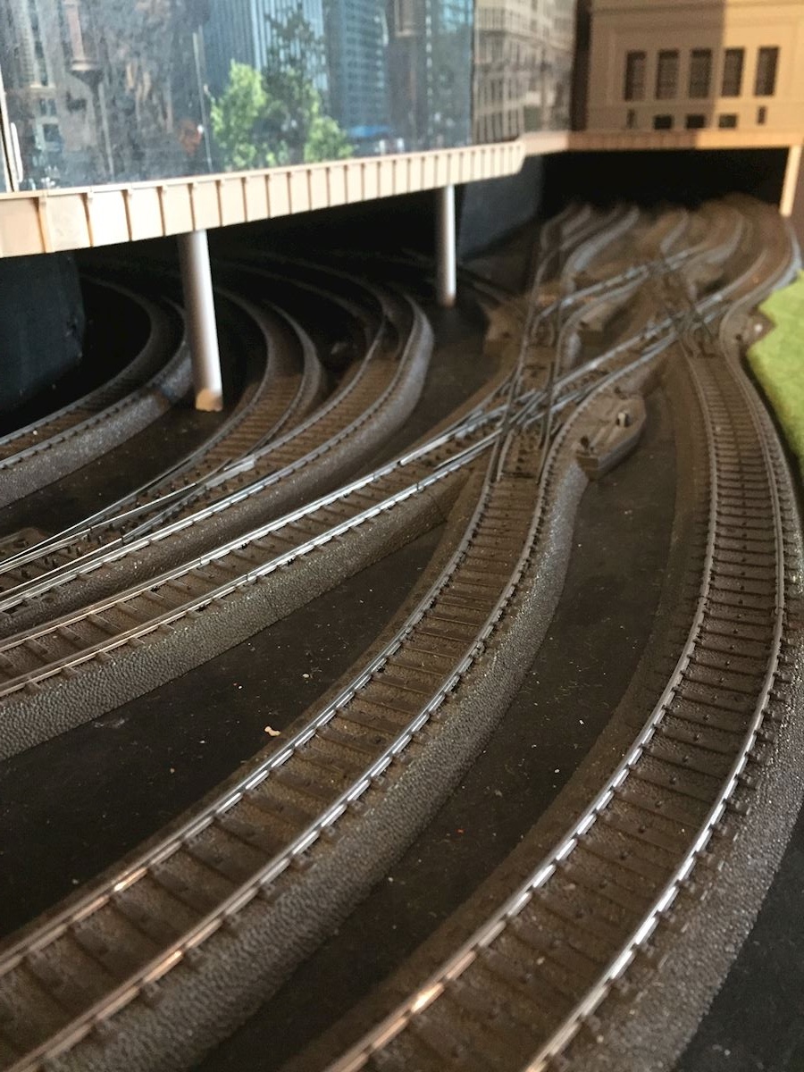

Good morning,
After two years of planning for my new layout, collecting all the track pieces and finally creating my new Märklin C track HO scale layout. I can say, I’m nearing the end of my journey! It's been a real breath of fresh air using the Märklin C track program with all of the set pieces. I would like to encourage others out there who like me had doubts about the benefits of this innovative track that you need to try it and let me be the first to say, “Try it you'll really like it!”
I can honestly state that this was the most enjoyable project l've ever had in creating and building a HO scale model train layout. Having everything fit and follow a defined geometry takes the track laying phase to the next level where everything fits into the track plan! The track plan is the map that shows you where everything goes from your concept, ideas and wants to making your layout work. Without a track plan you'll only run into trouble! I would recommend that you purchase some sort of track planning software. I used ANYRAIL software which worked well for me and l'm quite sure the other software programs work as well. Using software you have the templates for the track pieces and all you have to do is make a layout plan that suits your needs. The tracks fit into place on the screen of your computer. Once completed print your plan and start laying your track pieces following the your track plan. No calculations, no measuring and no cutting of track needed, everything fits into place and then your done! Your Märkin C track dream layout is made just the way is should be, right on track!

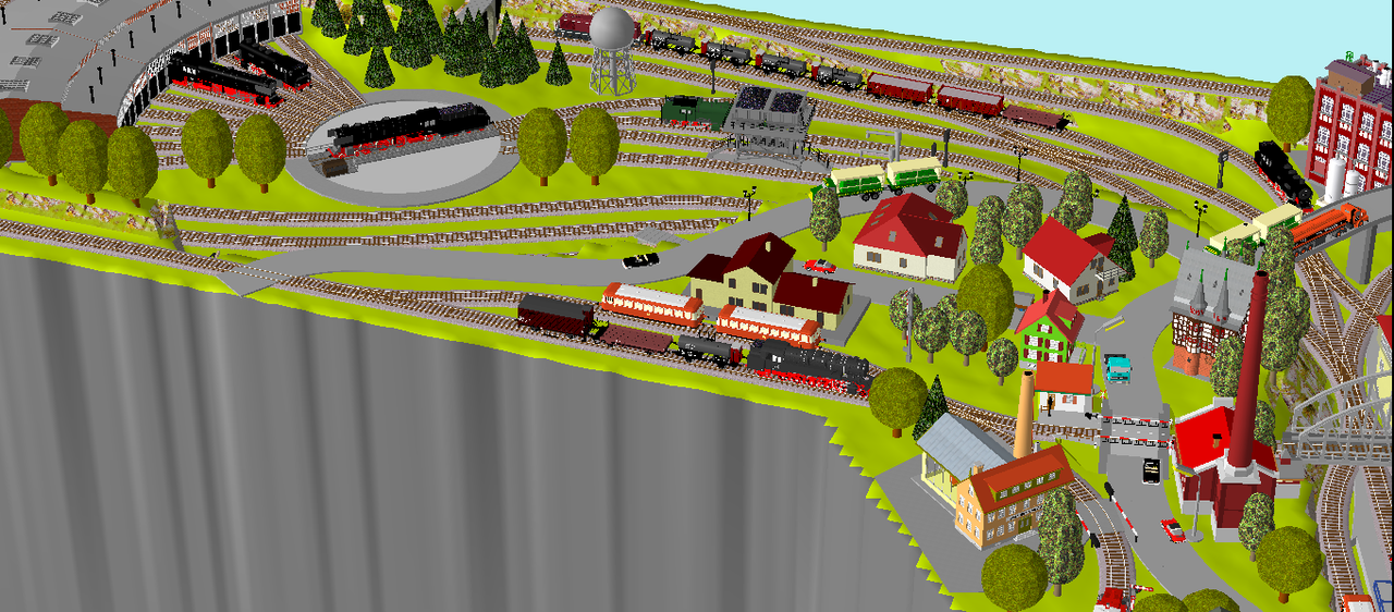

For my layout I have used Wintrack. Alas it is not free but very good to create your layout (of courseBigGrin ) but also calculate the slopes and start thinking about your landscaping.
Here is what it gave to me during the preliminary design phase

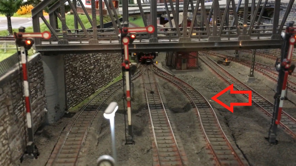

Here is an example of a change on the 24630 triple point on my layout (sorry I paste a part of another topic of mine):
Because I was not happy with a portion of my layout where the track was making a "S" curve cause by the geometry of the Märklin 24630 triple point:
I did some surgery on the triple point to correct this:
The problem was that the portion of rail to be grafted was just where one of the triple point's motors is.
So the soltion was to cut the plastic bed at a different location of the rails cutting.

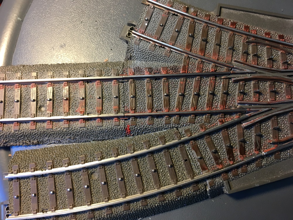

Here is what it looks like (before trimming):

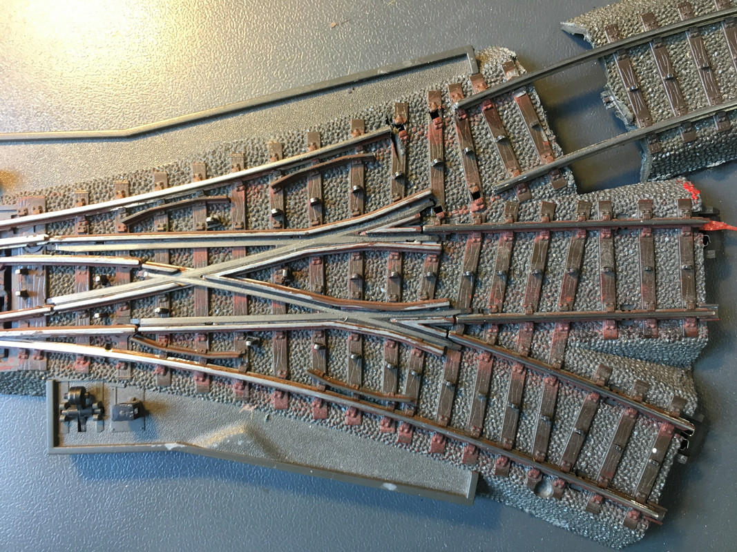

Here is the finished "surgery"BigGrin :

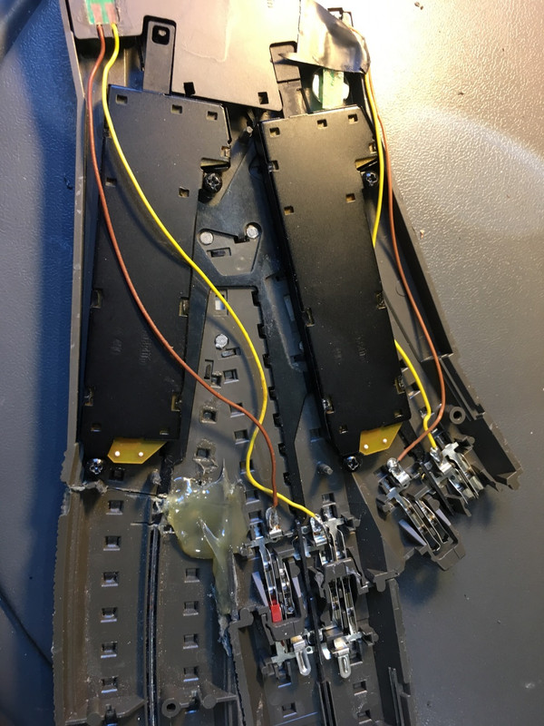

Bottom looks like this
A bit of cyanolit glue on the rails (from under the plastic bed and a bit of hot melt.
Surgery was made with my diamond disk and hand drill
It is far from perfect but the track layout problem is corrected

Just to illustrate how tracks can vary, here is a picture from SNCF track near Paris with a third rails and provision for a 4th one all on concrete sleepers for a suburban track.
Seriously I believe C track is probably one of the very best and can integrate wonderfully in your landscape (This is not my strong pointBigGrin )

For people not afraid of saws, post # 101 in this thread might be inspiring:
https://www.marklin-user...d-innovations#post573115
While the standard 24611/24612 turnout branch angle is 24.3 degrees (12.1 degrees for slim turnouts 24711/24712), it measures only 16 degrees at the frog (10 degrees for slim turnouts).
Cutting the curved section of a 24611/24612 turnout after 164 mm results in a poor man‘s slim turnout, matching the 64.3 mm track distance of the slim turnout geometry.
Cutting the curved section already after 151 mm results in a 52 mm track distance.
