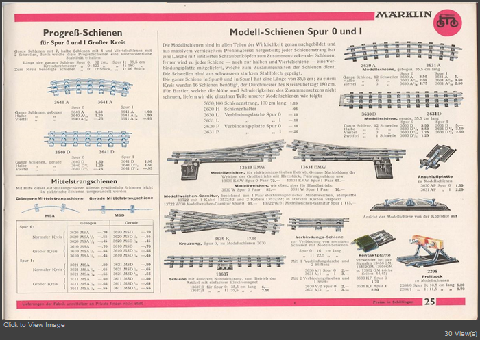

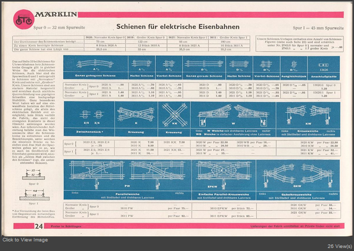

Hi Cookee,
Generally not only the curves are stamped with the radius, but also the straight tracks. A straight - track "12" is intended to use with- and fits the geometry of "12" - curves where 12 tracks make a circle. A straight track "8" fits the geometry of the "8"- circle. There are also "6" - tracks, but they are rare.
The usual track was the track with 3 ties. The track with 7 ties was named "PROGRESS"* and was the luxury version of the track.
Generally a straight track is a "D" - track and curved track is a "A" track. In very early times there were also "B" and "C" tracks with different connectors. "A" and "D" - tracks have 2 pins on one side and 1 pin on the other. Straight "B" and "C" have either three pins on both sides or no pins. Same for curves "E" and "F".
A combination of the "6", "8" and "12" series was not planned and is only shown in very few track-plans. The geometry was not compatible like the usual combination 5100/5200 we know from H0.
Two pages from the catalogue 1935 with the track for electric trains.
Markus

Thanks Markus, that's really helpful info. I have seen those pages in my catalogue but I did not understand the distinction with the 'Progress' track. And it appears there's an even more advanced version? - with even more ties?
So from what I can tell, the track was not really changed much at all during production and there's no easy way to determine manufacture date for a piece of track?
That's fine, it makes no actual difference but I'm thinking of selling it all and any information I can add to my description should help. I'll just guess that it probably dates circa 1930's and I won't be too far off BigGrin
