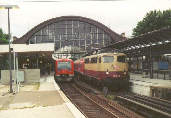

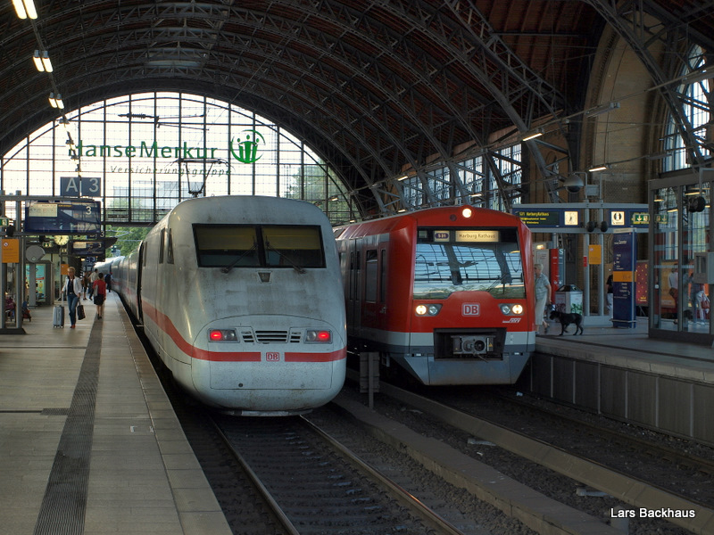

You called?BigGrin Here comes photographic evidence of the catenary inside and - since it might help to understand the situation inside - in front of the station:
http://images.fotocommun...69-9eb9-b1e5a601598b.jpg
http://www.eriksmail.de/...C241003Dammtor190210.jpg
http://www.eriksmail.de/.../474554Dammtor141208.jpg
http://www.bahnbilder.de...-bahn-hamburg-329298.jpg
http://www.eriksmail.de/...00003Dammtor2p040109.jpg
http://www.eriksmail.de/...72535Dammtor1p211208.jpg
http://img820.imageshack...9721/103235dammtorkl.jpg
http://www.hamburger-bah...HH-Dammtor-mit-Halle.JPG
http://www.reflektion.in..._100807_1_sb-hh_1000.jpg
http://imageshack.us/pho...170131chambdammtor8.jpg/
http://www.trainslide.co...29ewd-s-bahn-hamburg.jpg
Speaking of eras: The three-car electric multiple unit Hamburg S-Bahn train DRG Class ET 171 (since 1968 DB Class 471/871) being fed by the third rail was running through Hamburg-Dammtor from the 1940s until 2001.
Enjoy - Ak Smile
Speaking of eras: The three-car electric multiple unit Hamburg S-Bahn train DRG Class ET 171 (since 1968 DB Class 471/871) was running through Hamburg-Dammtor from the 1940s until 2001.
Enjoy - Ak Smile
Absolutely fantastic! Thank you!
It appears some of the scaloped glass panels at the ends have been removed to make clearance for the catenary. I'll keep that in mind as this build progresses. May need to do the very same thing for the same reason.
Loved the picture with the two kinders posing in front of the triebwagen. She even has a handful of flowers. Good stuff!

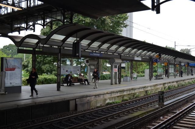

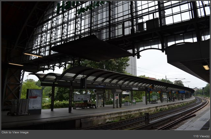

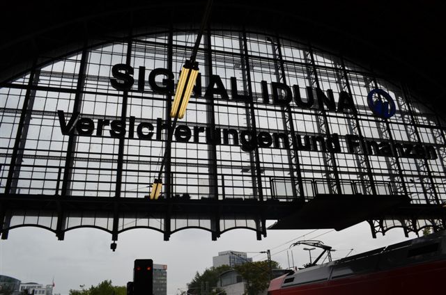

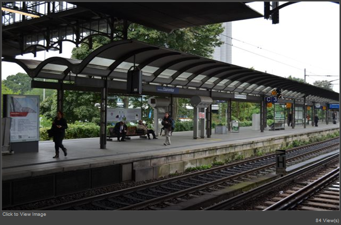

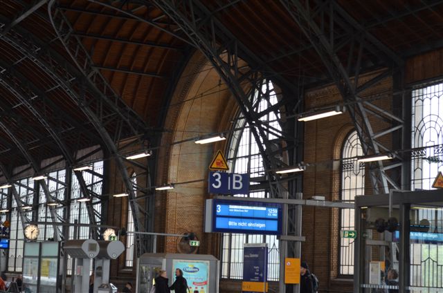

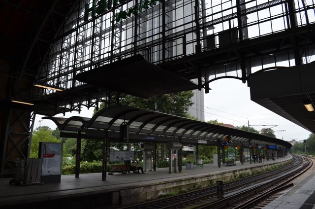

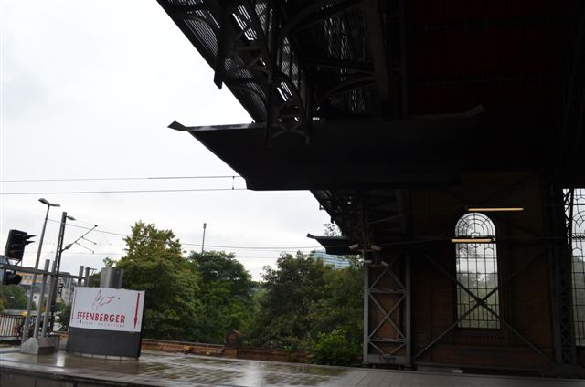

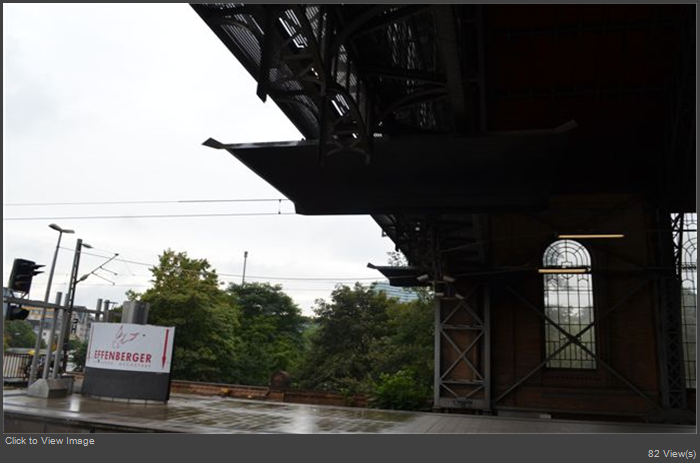

Hi Matt,
I took lots of inside pics, both the Train Hall and downstairs, as well as close up of the oiutside of the building.
The Catenary inside is conventional wire. The S Bahn is three rail at ground level, with the solid third rail on the RH side of track.
Where the Catenary exits the hall the bottom pieces of glass are in deed missing to allow for the splash shield if that is what it is called. Have a look, just a few samples !
NZMarklinist attached the following image(s):
Hamburg Dammtor BHF_Marklin Days Trip 2013 1595 (6) Looking West outside from S Bahn side.jpg
Hamburg Dammtor BHF_Marklin Days Trip 2013 1595 (75) Main Doors South Side.jpg
Hamburg Dammtor BHF_Marklin Days Trip 2013 1595 (77) By South  Side Doors.jpg

Hi Glen,
If you could e-mail me your pics or post them here for others to see, I would be very greatful. The more information I can gather, the better. Both for me and anyone in the future who may build this kit.
Thanks!
Edit: I posted too soon. Thank you so very much! A stunning building both inside and out. I know modern construction methods are way beyond what we knew and did 100 years ago, but the style (both artisticly and engineering) they had is something to behold.

Hi Glen,
Thanks!
Edit: I posted too soon. Thank you so very much! A stunning building both inside and out. I know modern construction methods are way beyond what we new and did 100 years ago, but the style (both artisticly and engineering) they had is something to behold.
Matt note the inside wall by that S bahn Zug, it appears to be conventional bricks but they may have been put there in the 1990 rebuild ?

Hi Matt,
Enjoy - Ak Smile
Something I hadn't considered but, that pic appears to be the S Bahn line as it is today. So way back when there was Catenary on all lines maybe Huh
I say that from the knowledge, and assumption, that the platforms could never have came very far out the eastern end because of the bridges. So that pic is Western end Nth side = S Bahn line as it is today Wink
Great picture resourse AK ThumpUp
Glen
I noticed that too. Trix has reproduced that on the end pieces. It was one of the segments that sandwiched the window glass. What is also interesting is the center section has the brick laid in an arc to meet the main window. Trix did not do that there. They have a brick panel that glued to the inside, but the side panels (also brick) are just vertical and do not follow the curve of the window. I also think they just put them in so you would not see the unfinished insides of the "towers" when you peered through the glass. These panels do not even come all the way out to meet the brick panel glued inside the center panel. There is a gap of about 1/8 inch. This though will be in the corner where you would not be able to see it through the window.
The big question, is the brick on the inside the same color as the sandstone? It looks close.
