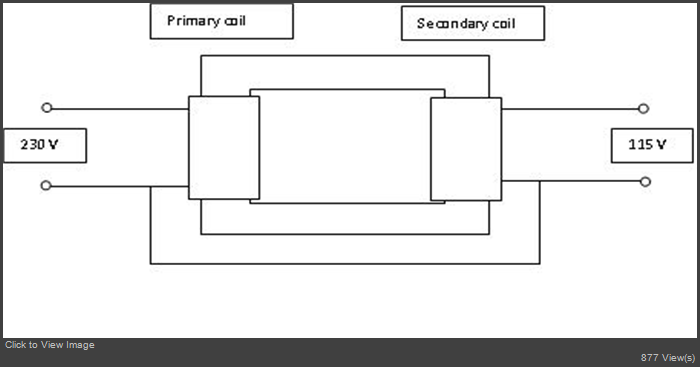

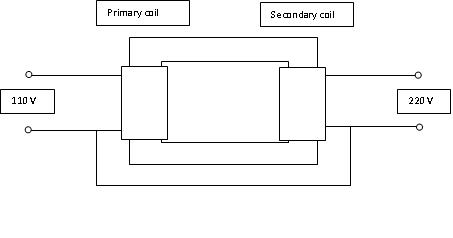

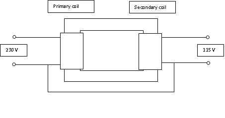

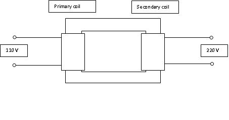

Hi Tulit,
I would also suggest you get a proper power supply for North American voltages.
As Ray points out depending on what the transformer looks like inside you may end up with various voltages between your house neutral and the output neutral of the transformer.
One could separate two cases:
1) Full transformer
This is a simplified drawing of a full transformer:
In this case there is a full isolation between primary and secondary sides and it doesn't matter which of the connection points to the left is connected to the house neutral and to the house phase wire. No need to use a polarized plug to connect this type of a transformer.
2) Transformer without galvanic isolation;
In this case there is electric connection between one of the poles of the primary side to one of the poles on the secondary side. For use in the US this type of transformer should (must?) have a polarized plug in order to connect the lower point in the drawing to house neutral and the upper to house phase.
It could be that you have a step up transformer of this type.
Finally, even if it is a bit off topic. My wife is from California. When we married (in 1985) she brought a few electrical items to Sweden. Most of them were replaced by 230 V versions and taken back to the US, but she had a calculator that she loved and on a business trip to the US I bought a 230 V to 115 V travel converter at Radio Shack. (A piece of crap, but a good starting point for doing my own design and at a lower cost than all transformers I had seen in Sweden).
I noticed early that it didn't have galvanic isolation between primary and secondary sides and given that outlets and plugs are not polarized in Sweden. I designed a new box for the transformer with a test button with a red lamp. If lit, then the plug needed to be turned 180 degrees in the outlet in order to operate in a safe manner. The Radio Shack designer of that transformer had evidently taken for granted that the left hole of an outlet is neutral and you can never count on that in Sweden (and in many European countries) and furthermore in theory the pin which was meant to be the left one could also go in the right hole by turning the converter 180 degrees - in short a poor design from electrical safety point of view. But it was a very cheap transformer and it still works even if we don't have the calculator any more.
PS I have an M.Sc.E.E.
thanks 3 users liked this useful post by Western Pacific
