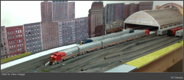

Hello All,
Jeroen's great story of poor-man's Union Pacific F7 made me to join the discussion forum too.
I have a similar project, a poor-man's Santa Fe F7B, using a Märklin frame and Athearn body. Nit-pickers stay away!
It all started when I bought a Märklin F7 ABA -set from Ebay. The cab units were 3060 and 4060 as promised, but the B-unit turned out to be something else than a 4063. Somebody had put a plastic Athearn body on a shortened 4060 frame. I guess Mr. Koll would have listed it close to nothing.
The body was factory painted but was lacking handrails and other details. Also the bottom tanks in the mid-60's Märklin units was warped, which seems to be common and needed to be fixed. I thought I could do a better job, and started collecting material for the fix-up project.
I got an unpainted Athearn Body #30240 for a little bit more than $8. This one has the steam generators as I understand unlike the Märklins. I'm going to need'em when I get my Super Chief coaches!
I also checked out Athearn and Old Varney frames and running gear, but decided to stick with Märklin. The frame is as simple as possible and nobody else has million-mile trucks like Märklin. Actually the 4063 frame is made from the same stamping as 4060, but it's cut shorter in rounded end. In one of the pictures you can see the difference.
I painted the plastic body with Model Master spary paints, and used Decals, Micro Sol and -Set from Microscale to finish it. I found also a Diesel Dress-up kit from Walthers, which had all the needed handrails and windows.
I really like the Farr -intake grilles from Detail Associates which are a must.
In the meantime I got a genuine Märklin 4063 B-unit which now completes my F7 ABBA -setup! All I need now is more power and more driving axles, two is not much. But that'll be another topic.
BR, Juha

#17 Posted : 08 February 2014 18:33:01(UTC)
Posts: 5,913
I tried a rich man´s ATSF F7 approach combining a 37622 with a 4063 and a 33622 - see pic.
Greetz - Ak

#19 Posted : 09 February 2014 17:32:35(UTC)
Posts: 5,913
Thx Ray,
Yes, I always liked the poor man's F7 approach, and I felt compelled to honour these forum grandees.
It runs quite well. I set one motorized A unit in each MS and turn up the speed evenly. Once the second 33622 A unit arrives, I intend to release the 37622 to his solitary A-B existence and team up the two 33622 - which hopefully show a similar behavior - under one single address, thus controlling both motorized A units with a single MS.
Offline 3rail4life

#26 Posted : 12 February 2014 21:56:09(UTC)
Posts: 5,913
When will this madness stop?
Edited by user 13 February 2014 21:33:50(UTC)  | Reason: Not specified
#27 Posted : 15 February 2014 00:30:12(UTC)
Posts: 5,913
I have not tried this, but if you have two units with the same address, remove one unit from the track, reverse, then replace the unit...will they both try and go in opposite directions?
Now that I have both 33622 delta F7A locos I tried it. Result? Well, it does not work this way as they seem to develop something like a collective intelligence. Whatever I do, they always move into the same direction. And, as I am useless when it comes to electronics, I do not dare to touch the cables in order to reverse the polarity. In the good old analogue times there were only two, a red one and a brown one. Ignoring the yellow lamp feeder, there are now five cables connecting one way or another the pick-up shoe, decoder board, engine and chassis.
So, for the time being I put both FA units on the same address and run them in a AABBB configuration. Looks impressive (although I prefer the worm look of ABBBA) in front of my eight streamliner coaches or 19 tin plate box cars plus caboose. The two 33622 engines master the four percent grade on my layout, but one needs to pay attention to the throttle (or get helper assistance). Thus: true fun!
Inspired by prototype - see pic.

#29 Posted : 15 February 2014 14:24:03(UTC)

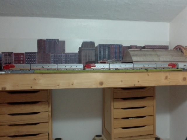

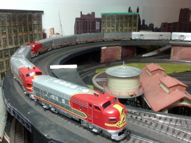

Since we are talking about ATSF and "poor man solutions", here's my Märklin ABBA and my 8 coaches "El Capitan" consist.
The Athearn coaches are at least 30 years old and I paid $ 6.50 /piece at the Train Shop in Santa Clara , California, back in 1984
I have recently retrofitted them with Symoba KK mechanisms, which made all the difference between frustration (old US style funky couplers) and pleasure (Märklin KK)
Still makes for less than $ 20/coach, far for the $1000+ you'll have to pay for this year new 6 coaches Märklin set!
thanks 7 users liked this useful post by jvuye

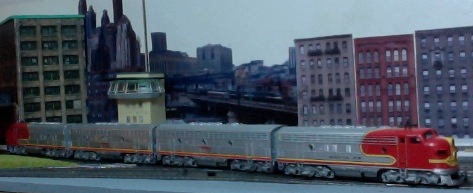

Simulated:
#34 Posted : 15 February 2014 20:08:12(UTC)
Posts: 5,913
Simulated, too:
#35 Posted : 15 February 2014 20:16:39(UTC)
Posts: 5,913
Simulated, again:
