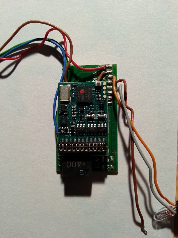

I bought a 21pin Mfx decoder, on EBay, from a Marklin 30080 (BR01) and want to know what the Marklin part number is for it.
I can the download the manual for it.
I've attached a photo to help.
Thanks in advance.
Mancsaint

Offline Markus Schild
#2 Posted : 05 October 2013 01:09:23(UTC)
Markus Schild
Joined: 14/01/2006(UTC)
Posts: 1,802
Location: Wurttemberg
You are looking for this one:
Code:
http://medienpdb.maerklin.de/product_files/1/pdf/60942_betrieb.pdf
Markus
#3 Posted : 05 October 2013 01:28:05(UTC)
Posts: 15,451
The decoder is a crippled 60942 (see Markus's post for a link to the manual).
The decoder does not support DCC and not everything described in the manual will work with that decoder.

The decoder has function outputs AUX1 through AUX4 and lights and you can use F0 through F15 as you like.
Forget the 30080 manual, the 60942 manual is a better source of information. But because DCC is missing, you will need a Central Station or ECoS for any advanced setting.
