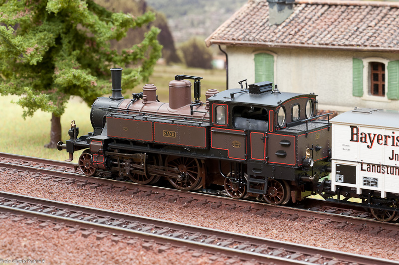

Hi Gregor, behind the curtain of the 26535 you see the engine, a packet decoder and a lot of coloured wires.
I have Painted the engine and wires in black.
About the 37135 the decoder is an old version, more big and without protection, better to leave the curtain
Alberto
