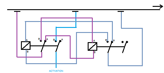

This can be done in several ways, I think.
You can use the Märklin UFS relays as a "memory-bit" and make a toggle electro-mechanically;
Normally I make my systems with 24V industrial strength relays, where the coils can be powered on continuosly, but I think this plan is correct for track-contacts and Märklin 16V bistable relays.
It whould work correctly with both slider and wheelsets operated contacts, as long as the distance between each track-contact is more than a train-length.
Forget about the "direction of travel"; This will work in both directions... RollEyes
