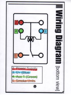

The other thing i forgot.to tell you is since they are two smokes.units, and to be on the safe side, i wired them through a mini relay to the decoder.

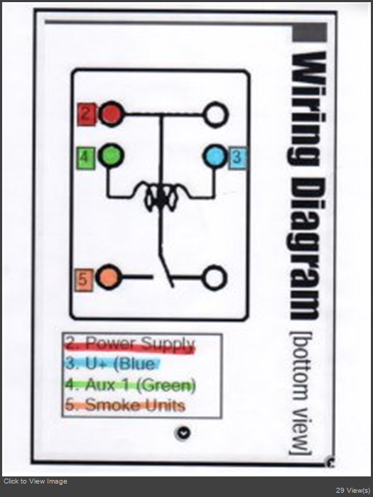

Did you use an ESU 51963 Miniature Switching Relay, 16 Volt, or did you go solid state?

Hi, the ESU ones

Thanks Francisco, I had a little trouble finding them with Google because I did not know the part number. I eventually found them on the ESU website. They are not expensive so will order a half dozen, I am sure I will use them on other conversions too.

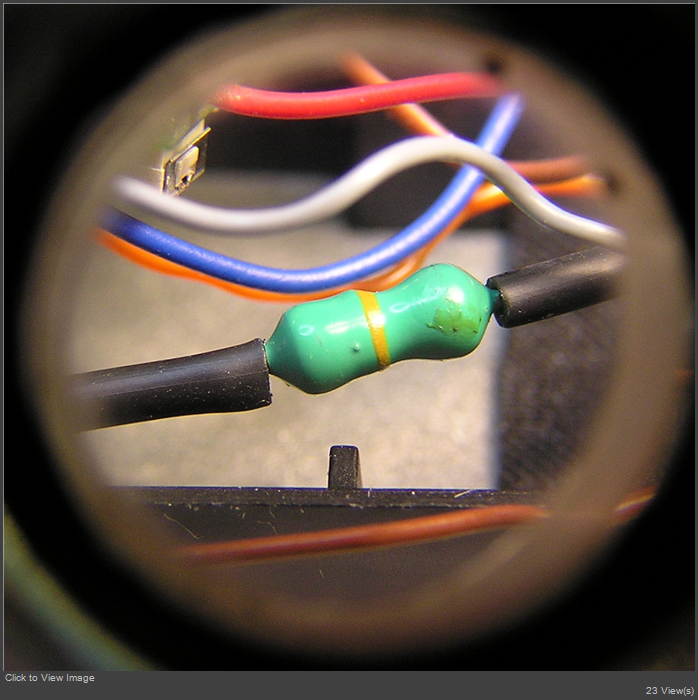

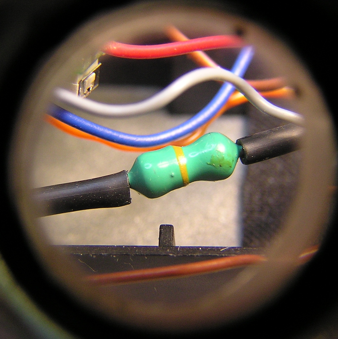

The two wires connected to the motor both have what looks like resistors in them I assume they should stay wired in. They are similar in shape to a half watt resistor but a bit shorter, are pale green in color with a single coloured band. They could be a choke?

Yes, they are chokes and must remain in place. You can solder one end directly to the motor tabs and then the wires.
Here you can see a picture
https://ajckids.com/blog...n-dcm-motor-connections/

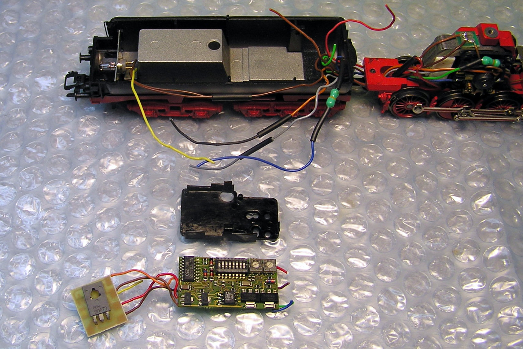

I came to that conclusion too that they were chokes. I measured the devices with a VOM and found zero resistance that told me they were not resistors, also the shape was wrong and they only had one colour band.
Soldering them to the motor is a good idea too, it gets them out of way of the clutter in the tender.

I am not sure I will finish before you do even though you have to wait for your replacement decoder. This is all very new to me, it is not as though I am doing a "like for like" replacement. I am taking lots of pictures and making lots of notes. But I am getting my head and my hands around it and will start cutting wires very soon. Removing the power transistor should be easy, it only feeds the lights and smoke units. Once it is out of the way, the rest should be easier, the whole thing is a bit cluttered right now.
I have all of the existing wires in a table with their purpose and colours noted. Once the 6090 is gone, the colours of the existing wires become irrelevant, it is then down to purpose. It is it a case of tracing them out, cutting them out and connecting the wires from the new adapter board. These connecting wires are also in the same cross referenced table showing colour and purpose. So matching purpose for purpose should see everything connected correctly, I hope. It will be one step, or should I say wire at a time.

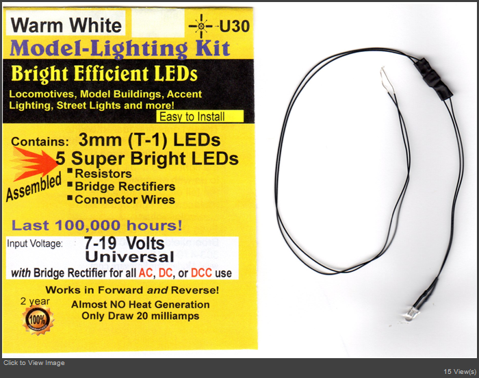

A new question, slightly off topic but related.
The 3702 came with two incandescent light bulbs installed, one for the front lights and one for the rear. I am thinking seriously about replacing them with 3mm (T-1) LEDs. I have a pack of five which already have resistors and diodes attached and are good for 7-19 Volts and which also function with AC, DC or DCC use.. It looks like I could remove the rear light-pipe from the tender and install two LEDs in its place. I could possibly replace the front light light pipe the same way but that may involve more surgery than I want to undertake at the present time. But I will investigate the front and rear lights to determine what is involved.
Has anyone replaced the front and rear lights in a BR53? Comments and suggestions will be most welcome.

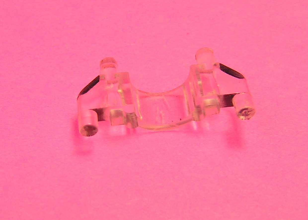

Originally Posted by: mb300e4m Go to Quoted Post
A new question, slightly of topic but related.
I removed the rear light socket and bulb and the light pipe. The holes in the back of the tender in to which the light pipe fits are too small for the LEDs to fit into. But it looks like I can mount the LEDs somehow (yet to be determined) inside the tender body with the LED lenses touching the holes in the body. The holes in the tender body have lens' fitted to them, that is good, one less thing to mess with.
The light replacement task is going onto the back burner for now, so back to the decoder we go.

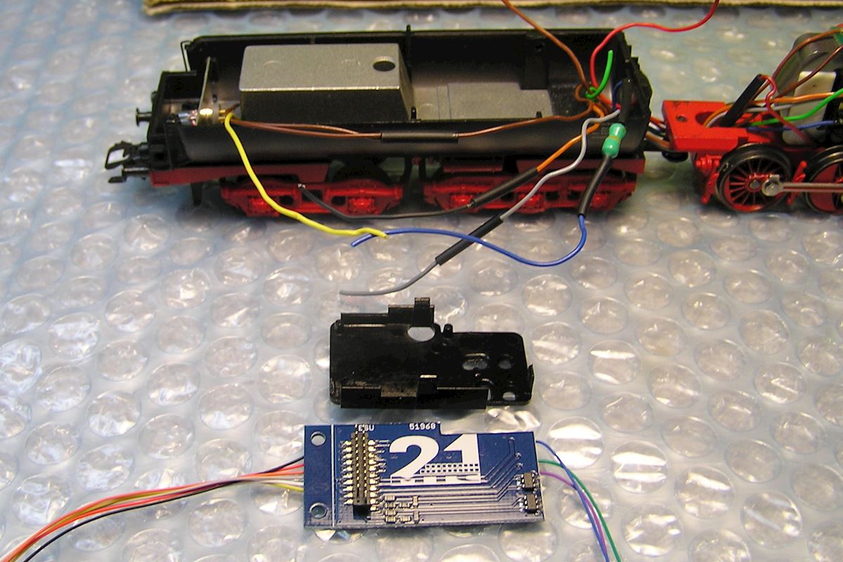

Out with the old and in with the new. I assume that the one edge of the adapter, the one with the mounting holes, can be removed. It is scored on both sides. Then it can be refitted to the 6090 plastic mount.

Hi, yes the plate should fit in the holder, perhaps you dont even neet to cut it. But it may make you lose a couple of mm in height to fit the speaker, if you should not use the holder, just insulate the wieght and secure the plate with double sided tape.
On the other hand, i don see the point in replacing the bulbs with individual leds, you can retain the difuser and change the bulb with any led (using the same socket) then solder the wires to the plate, dont forget the resistor.
As for the color you may find out that war white is perhaps not that warm. I tend to use yellow ones but try to keep the bulbs everytime i can. Remember that they are not intended to illuminate the road but the make the loco visible.

Hi, yes the plate should fit in the holder, perhaps you don't even need to cut it. But it may make you lose a couple of mm in height to fit the speaker, if you should not use the holder, just insulate the weight and secure the plate with double sided tape.
On the other hand, i don't see the point in replacing the bulbs with individual leds, you can retain the diffuser and change the bulb with any led (using the same socket) then solder the wires to the plate, don't forget the resistor.
As for the color you may find out that warm white is perhaps not that warm. I tend to use yellow ones but try to keep the bulbs every time i can. Remember that they are not intended to illuminate the road but the make the loco visible.
You are right about the plastic holder it takes up space where the speaker will go. Laying it down flat will result in a lot more room.
Regarding the bulbs, will the original incandescent bulbs work OK with the new decoder? If they will I will keep them as is.
To make the adapter card fit better, I needed to file a small notch in the edge of the card next to the two U+ copper lands. It does not need to be very deep, just deep enough to accommodate a plastic gusset in the side of the tender body. This way the adapter card will fit flat in place and not slope down from right to left.

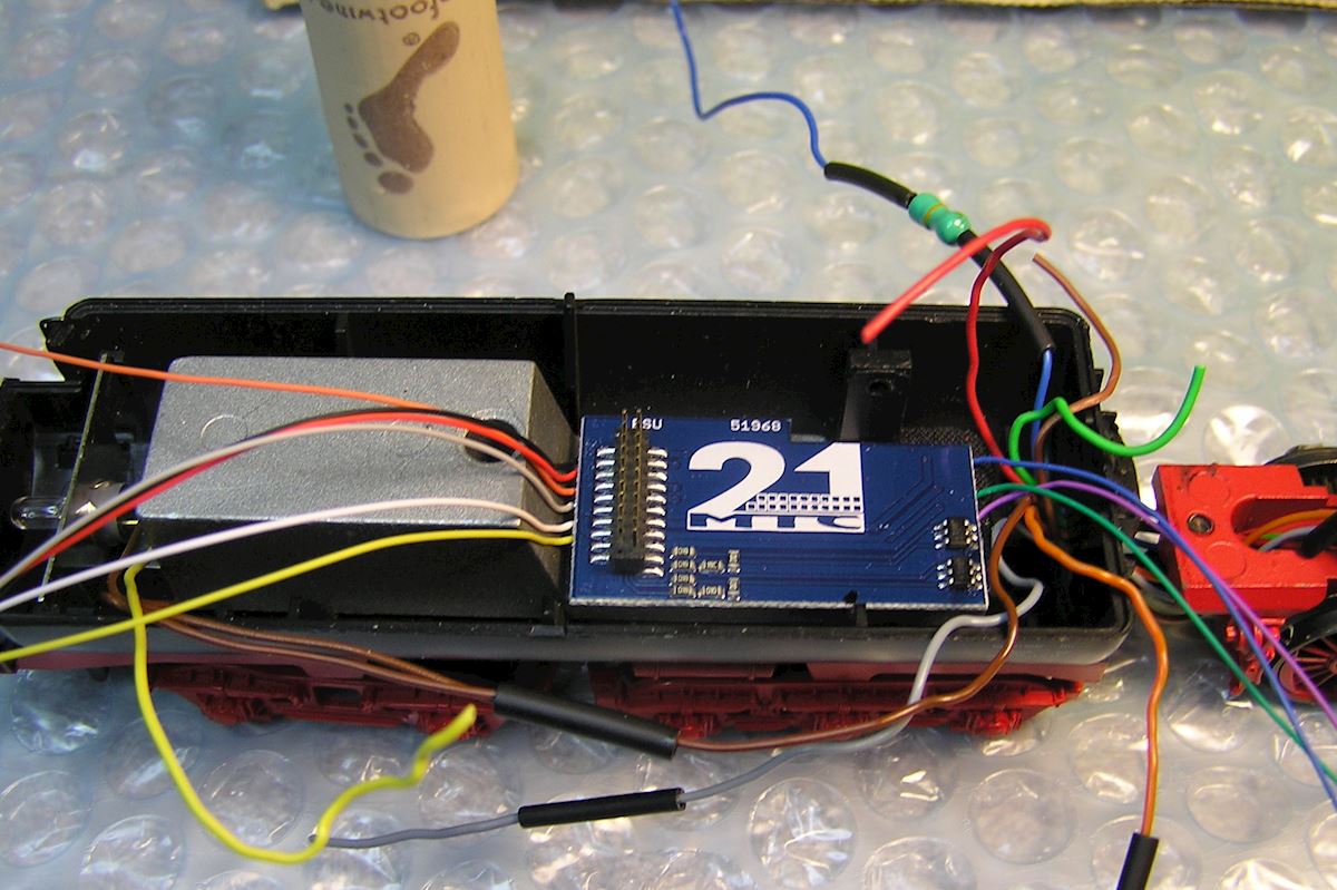

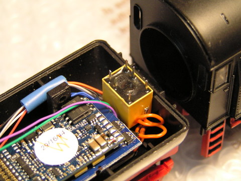

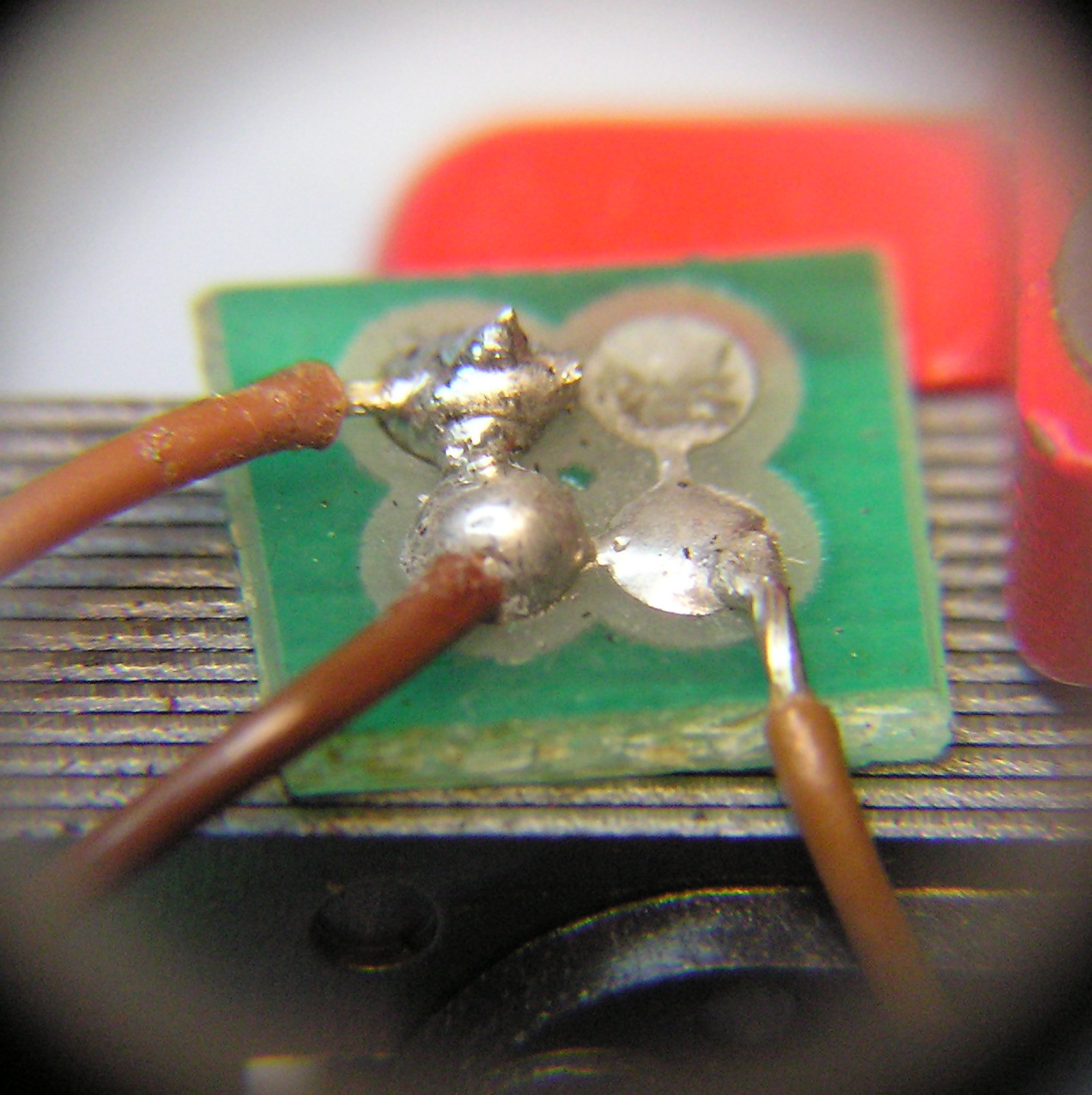

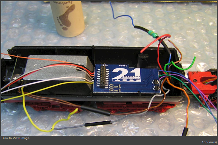

This has almost been a blow by blow thread, if you know what I mean. All that is left now is to hook in the relay for the smoke units to the orange wire, except I don't have any relays yet. Can't get any retailers to respond to my e-mails, it's like they don't need the business, Cursing maybe I'll go solid state. I need to re-install the rear light too but that is a no brainer, that is the yellow wire. Then comes the decoder...keep your fingers crossed when I get to that. Cool
Notice the short piece of blue sleeving, I cut a notch in a gusset, fed the wires through the sleeving then pressed the sleeving into the notch, that should keep them tidy. Any slack wires you see will be tucked in out of the way.

Nice, you are almost done.
as for the relays, you may try to find equivalents at an electronic store, once i needed smaller ones than the ESU and i found those: OMRON G5V-1, they must be widely available.

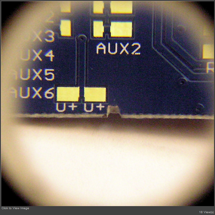

As for the lights, yellow with yellow and the other pin to the blue wire or any U+ pad, you may use one for each light and one for the relay when you got it, the soldering is much simplier.
the black wire to the tender wheels is ok, but...as you can see in the previous picture of my engine when i showed the ball bearings, you can see an small bronze pad fixed in the lower left screw of the motor shield, that way you ensure that ground is made by all the loco wheels and not only the ones in the tender, that is very useful when your wheels and/or rails are not completely clean, of course you must be sure that there is no other cable touching the loco chassis at any point.
An empiric way to check for short may be to put the loco on the rails without the decoder when the wiring is done, nothing should happen, if you get a short then check all your wires again.
The brown cables to the lights can be removed safely, as i said before just one pin to any U+ pad. If you dont like to solder to much on the board you can do the following:
mainting the wiring with brown cables to the lights and extra little board, then solder the cable from the little board to the blue wire or U+ pad.
Might sound confusing but it is not.
in short:
red cable to the pickup shoe.
black cable to wheels ( just to the tender ones is fine )
and nothing more to those cables
All functions (lights and relay ) must be wired according to the color code ( white and yellow for lights and green for the relay in F1, leave the violet alone ) the circuit is completed trough the blue cable (u+) for all functions.
Orange and grey to the motor trough the chokes

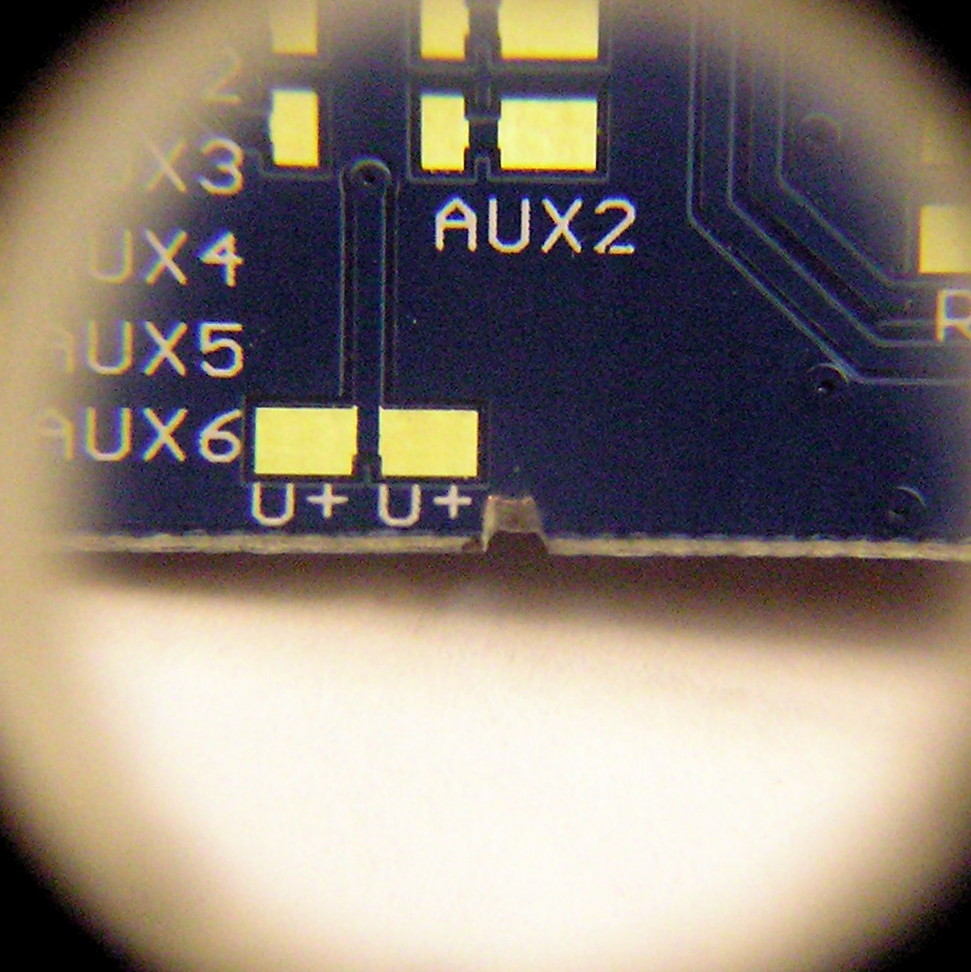

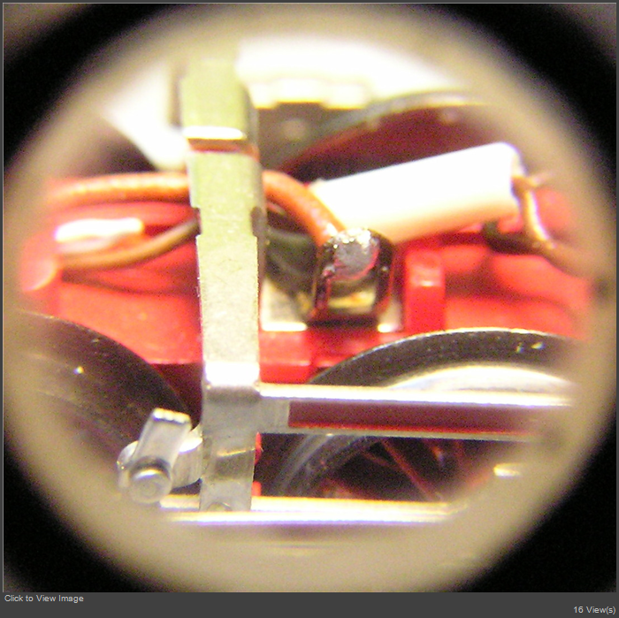

In your picture you say:
"...you can see a small bronze pad fixed in the lower left screw of the motor shield, that way you ensure that ground is made by all the loco wheels and not only the ones in the tender, that is very useful when your wheels and/or rails are not completely clean, of course you must be sure that there is no other cable touching the loco chassis at any point"...
I have Pin 21 and 22, Black and Red wires connected to outer and center rails respectively. The U+ Pin is connected to a solder pad mounted on the motor laminations and insulated from the chassis. This pad has two brown wires connected to it. One WAS connected to the rear light and tender wheel pickups, but now only connects to the rear light. The second brown wire connects to the front light and to the front chassis and provided additional outer rail power return.
It seems to me that I need to break the connection to the chassis and run a new wire from the front chassis to the tender wheel pickups. Having the U+ connection “grounded” to the chassis sounds like a fatal arrangement for the decoder.
On a related matter, I plan on changing the two light bulbs for LEDs, but am awaiting replacements. Can I use the existing incandescent light bulbs without causing damage to the decoder or adapter?

Hi, it is ground, so it is soldered to the black wire, in the link i have send to the AJC forum you can see it clearly.
The tab is then attached with the motorshield screw making the whole chassis and wheels grounded

Today, I am going to document everything that has been done to this point. It will be a pin by pin and wire by wire listing of what is connected to what and how. I will post it here. I believe the only things still needing to be done are 1) replace the incandescent bulbs with LEDs and 2) install the relay to power the dual smoke units. These will be attended to at a later date.
Hi again Francisco,
I can see the tab in the AJC picture, mine is a little different. The front chassis has a solder tab on it which connects the chassis to Pin 21 (Black) wire which is also connected the Tender Outer Rail pickups. That takes advantage of the six non-powered drive wheels, the ones without tyres, and the front pony truck wheels as ground returns. You can see the tab in the picture.

Yes, it is the same function.👍

Hello again, here is what I have done so far. There are a few things left to do for the Smoke Units, but I am waiting for a shipment of ESU relays.
a. Disconnected Smoke Units and Front Light common from Front Chassis
b. Connected Center Rail pickup to Pin 22 (Red wire)
c. Connected Tender Outer Rail Pickups to Pin 21 (Black wire)
d. Connected Front Chassis to Tender Outer Rail Pickups, Pin 21 (Black wire)
e. Connected Front Light common to pin 16 U+ (Blue wire)
f. Disconnected Rear Light common from Tender Pickups.
g. Connected Rear Light to Pin 7 (Yellow wire)
h. Connected Rear Light common to Pin 16 U+ (Blue wire)
i. Connected Front Light to Pin 8 (White wire)
j. Connected Pin 18 (Grey wire) to Motor Right via choke
k. Connected Pin 19 (Orange wire) to Motor Left via choke
l. Connect Smoke Units to Relay (to do)
m. Connect Relay Solenoid to Pin 15 (Green wire) (to do)
n. Connect Relay Solenoid to common (to do)
The installed light bulbs are rated at 22V and draw 25 mA at rated voltage. If these will work for me, I may not bother with LEDs.
Thanks for your help and advice.

e) smoke units should not be connected to U+, light is ok
take a look of the relay diagram at esu homepage, then:
Pin 2 must be connected to pickup shoe
Pin 3 must be connected to U+ ( blue )
Pin 4 must be connected to green
Pin 5 must be connected to the central pin of smoke units
The ground of the smoke units is trough the loco chassis
In the meanwhile, just disconnect the smoke units from U+ and do the rest as pointed.
And enjoy your newly upgraded loco!!

Hi again Francisco,
The list in my last post had an error in item e. The smoke unit power wire goes back to the tender and not U+ and is coiled up in the front corner of the tender awaiting the arrival on my doorstep of a relay. I checked the wiring several times and missed the error, I was too close to the work I guess. It is good that you caught the error, thank you for your attention to detail.
I had looked at the relay information on the ESU page and have captured the images for reference. I will wire the relay as you suggested above. There is room to install it in the front of the tender.
I set the loco on the test track today and powered her up without the decoder. I did not see any smoke or flames and all was quiet. So hopefully I should be good to go with the decoder plugged in. The incandescent bulbs should be alright as they are rated at 22 Volts and draw 25 mA at 25 volts. 25 Volts is as high as my test power supply will go.
You may be able to see the orange smoke unit wire coiled up in the front corner of the tender. I guess it is getting to be show time, as in "plugging in the decoder then applying power again," what say you, shall I give it a go this afternoon? I need some encouragement to "push the boat out" as it were.

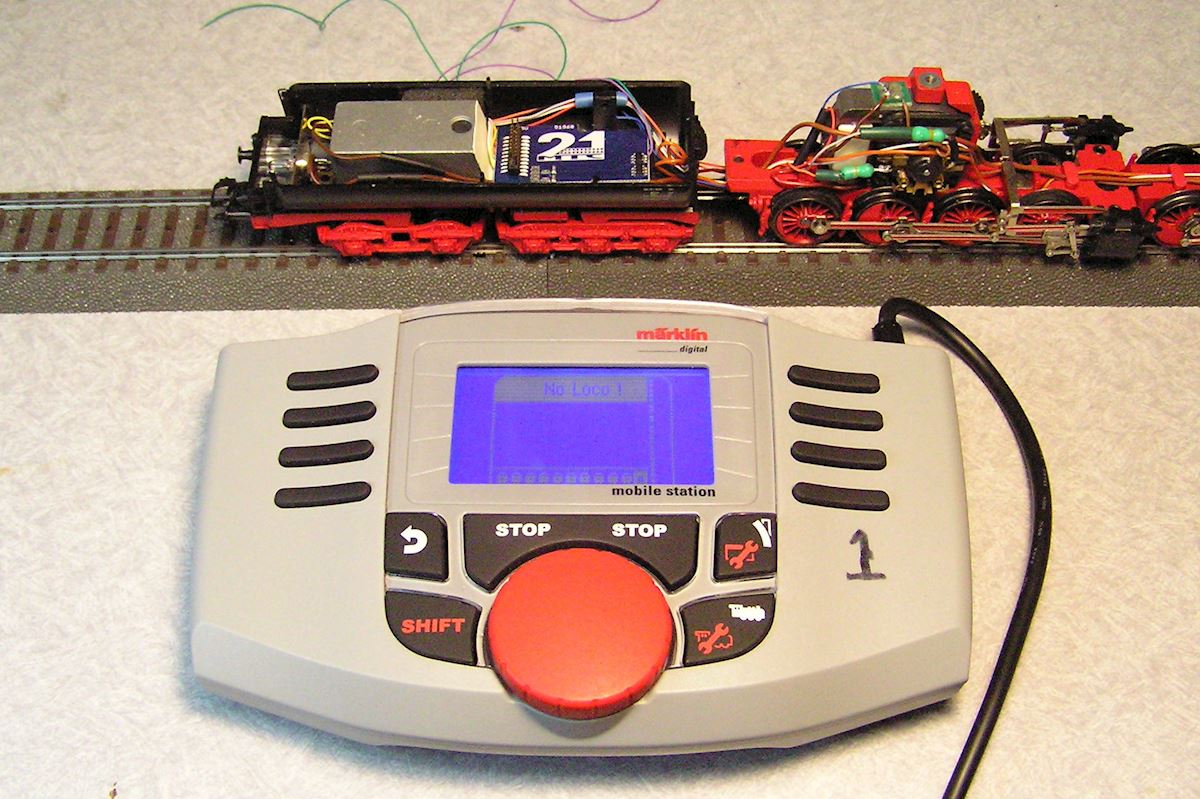

I connected the speaker then installed the Decoder.
I hooked up one of my MS2 units, picked a free memory space, placed the loco on the track and MFX started blinking on the screen; then as expected the MS2 recognized and registered the loco. I stepped it through all the functions except Smoke and all worked fine, and the lights changed when the loco direction changed. I then powered it down and left it for a while.
When I came back to it, I powered up the MS2 and noticed that the memory space was now empty and the front light was lit all the time unless the Stop was pressed. Also the screen said No Loco and the function icons were gone. I powered it down and back up again a couple of times but nothing changed. Oh shoot said I, the decoder must kaput. I hooked up my my second MS2 unit, powered it up then put the loco back on the track. This time the front light was off and MFX was flashing again, then as if by magic, hey presto, BR53 and the function icons showed again on the screen. A loco image was not displayed but neither was it on the first MS2.
I left it powered up and ran it back and forth on the test track a few times, checking all the sound functions too and all seemed OK. Then powered it down for about 15 minutes then back up again. The loco was no longer shown in memory. Also MFX does not flash on and off and the MS2 won't find the loco. I tried my first MS2 again but it is the same however the front light is not lit any more like it was yesterday. So now neither MS2 units will find the loco automatically.
I deleted a loco that I no longer have from my first MS2 and tried that memory location, but MFX did not flash it did not register it.
Do you have any suggestions, maybe my MS2s are too old or need firmware or software upgrade?

#82 Posted : 27 April 2017 18:49:14(UTC)
franciscohg
Chile
Joined: 10/07/2002(UTC)
Posts: 3,299
Location: Patagonia
Hello Peter, it worked! Great!
Have you tried resetting your MS2?
I have only one that came with my son starter set, and i use it only as a slave in my CS2. IIRC sometimes they "forget" the locos, so they did not appear in the list but since they were registered, they dont register again. My experience with them as a main controller is very limited so i cannot give you other advice than reset it for now. Later i can explore more options using it as a main controller, had to find the ugly box first.....

Hello again Jacques, good to hear from you and I am glad you like the thread, it was almost a boarder-line photo essay. If it encourages others to get into Digital, then that is a bonus.
Here she is all buttoned up awaiting the arrival and installation of an ESU relay to drive the dual smoke units. In the picture I am sure you will recognise some of the locos including a well used 3102. The red loco is a Trix Twin LMS 0-4-0 Tender Engine from 1938, she is 3 years younger than my oldest H0 locos from 1935. I have started my search for a replacement digital controller, however I do have an unused, new in the box, Digitrax Zephy Xtra DCS51 All In One Command Station; I need to get it out of the box and read up on it.
Best regards, Peter B.

The relays arrived a few days ago, so on with the saga of the 3702 conversion. There is plenty of room in the tender for the relay. The "orange" wire coiled up in the corner is the feed to the center pins of the two smoke units and will be soldered to the relay pin 5.
I need to find a supply of the same gauge wire that ESU use for their decoders and adapters. Can anyone tell me the wire gauge and suggest a supplier in the USA? The wire used for the original 6090 decoder in this loco is much too thick and although stranded, it is too stiff. Sad
Peter B.
