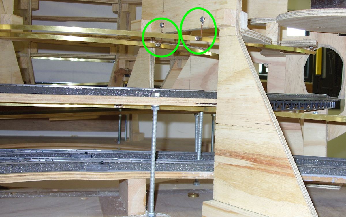

This is the Viessmann version:
Alternatively, you can leave the tunnel with no catenary, but then you need a ramp, or sloping wire, at the exit, to lead the pantograph onto the wire again.
Or you can make your own mounting / bracketing, depending on the construction methods used on your layout.
Edited by user 22 July 2012 19:43:06(UTC)  | Reason: Not specified

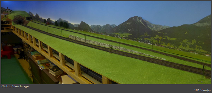

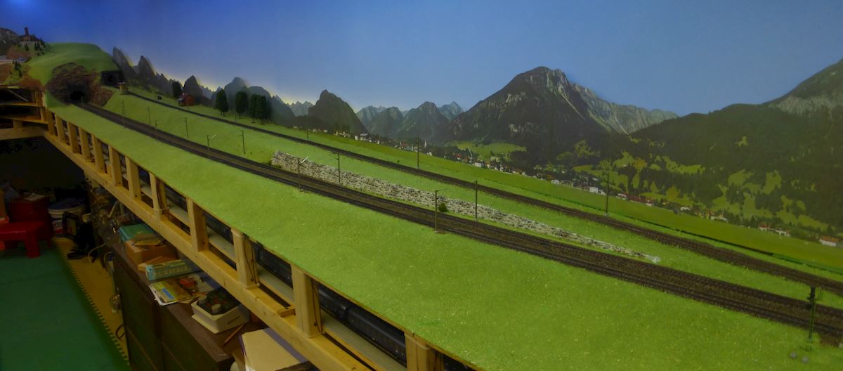

I just put up the poles. No actual wires. The thinnest wires available are twice as thick as they should be and they look awful in a station with lots of tracks.
here is my Paradestrecke with the poles up.
Look at photographs of the prototype, you have to look very carefully to see the wires if at all.
Look at photographs of models with catenary and all you see if a latticework of huge wires.
I did put up wires once but decided never again.
http://layout.mixmox.com/1/Sommerfeld-catenary
