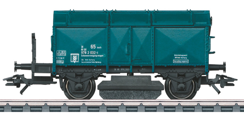

I don't think a "track" cleaning wagon would do you. What you want to clean are the studs and the wagon would only clean the tracks. Having said that, perhaps cleaning the track itself would help a lot in letting the current flow.
I bought recently. one such wagon from Marklin for the tracks (46049), not the studs, and I got good results. I started doing this after one loco got junk on it from the tracks and was wobbling. Now it runs perfectly again. BigGrin
I like getting the pads wet with rubbing alcohol (Isopropyl) before I run the wagon around the track. After I have run the wagon many times, I then clean the pads with a cloth wet with Isopropyl and run the wagon again. The wagon comes with two more sets of pads but you should not discard the first pair until it clearly is too dirty. I am still on my first pair. My local dealer says these pads last a very long time.
Again, this has to do with cleaning the tracks.
As for the studs, then I would use sand paper. I have never done it yet and it should really not be a problem in normal operation because the shoe itself normally cleans the studs. Your case may be different.
Incidentally, you can also clean the tracks manually with a lint-free cloth and Isopropyl. Obviously, before the track is laid down. Doing it manually afterward would be a big job, unless your layout is very small.
Below is a picture of the wagon I bought.
Hope this helps.

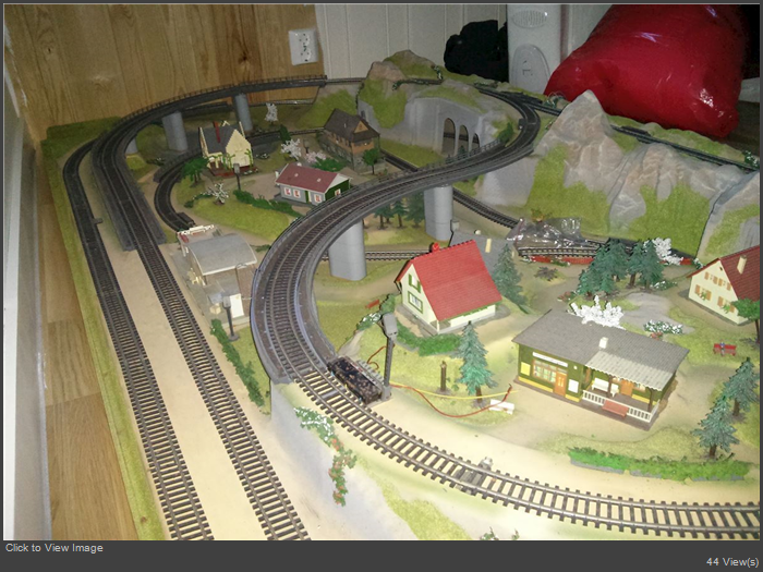

Lot of great suggestions here. I think ill try the sandpaper on centerstud-trick first. I belive the rails are ok. Atleast it looks like it when i use the multimeter. My biggst problem at the moment is time, so just be patience ;)
I think this is a preformed layout from NOCH dated back to the mid-70ies.

VERY nice layout!

Looks like a Noch 8065 "Brünnstein".
Tack plan is available on the Noch Site - http://www.noch.com/pict...ene/8065_Bruennstein.pdf (If the link doesn't work, as many here do not, look under discontinued track plans.)
