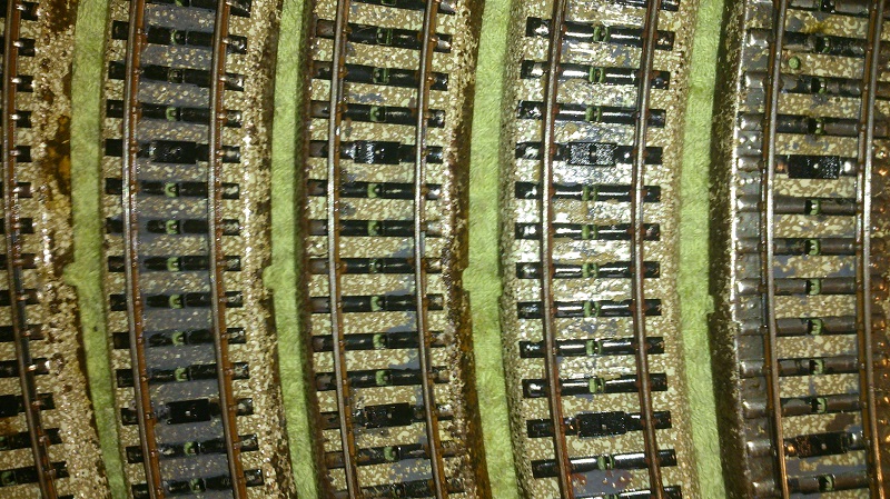

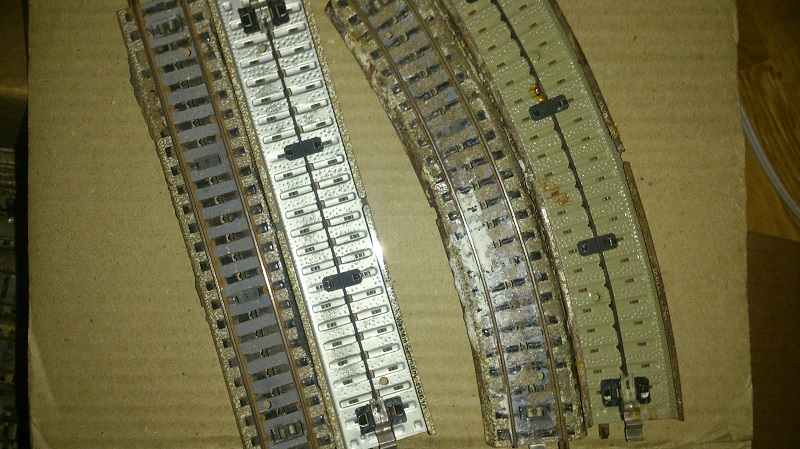

I took som pictures.
First picture shows tracks in three conditions. To the left is very good, no rust and little dust. In the middle is no rust but dusty. Most of my track falls into these categories. On the right is rusty rails but no rust on roadbed. Som of my track are like this. I also remeber seeing some tracks with rust on the underside of the roadbed but nowhere else but can't find them now.
The second picture shows the nightmare. I have some track in this condition from a recently aquired lot I purchased for the rolling stock. There's also some turnouts in similar condition.
EDIT: I have added smaller pictures that shows without download. The same as the ones to download, just resized.

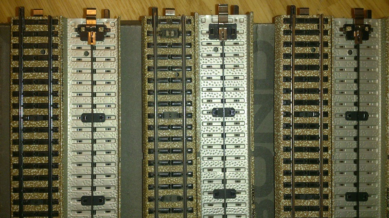

This is probably not good. I had just dropped 12 pieces of really dirty track with lots of scenery stuck to them into hot water and soap when I got a text: picking you up in 10. Turns out the weekend road trip starts today, not tomorrow. I was completely unprepared and panic packed in 8 minutes. The tracks I placed on a newspaper and covered with a towel. I'll be home again late Sunday and I'm kind of dreading lifting that towel...

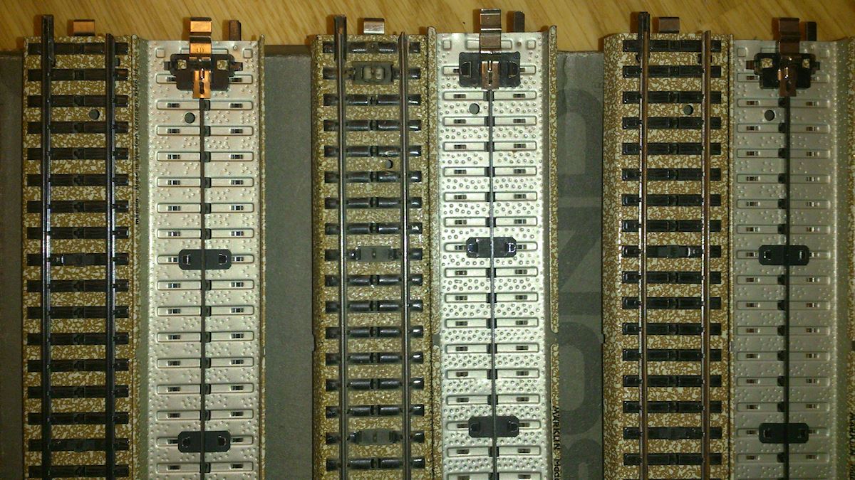

Here's an update on my attempts at track cleaning. Better late than never. Last post I reported leaving wet tracks under a towel and left town in a hurry. They didn't seem to be any worse for wear when I got back and for unspecified reasons they stayed under that towel for quite some time before I returned to them. But finally I did. I scrubbed them with a scrubbing brush in the sink filled with warm water and dish soap. I also used an old tooth brush. Not really happy with the result as there's still plenty of color, glue and scenery stuff left on them and some factory paint was lost as well. To dry them I put them in the owen at 150 degrees celsius thinking that should evaporate the water quickly. It did. But it also half melted the plastic so the puko rails moved causing shorts when testing the tracks later. Some bending, remelting and general abuse later the tracks no longer causes shorts but I still won't use them. Lesson learned I guess. Oh well, these tracks where junk anyway so no big loss. Pictures attached. DSC_0404_800.jpgDSC_0403_800.jpgDSC_0407_800.jpg
Some questions:
1: Those of you who use Track Magic after cleaning your tracks, do you apply it to the whole piece, top, bottom, rails, everywhere? Or just on the actual rails?
2: What exactly is Lighter Fluid? I see it mentioned in many threads about cleaning but I have been unable to figure out what it is chemically. Basically, what is it called in Sweden if I want to buy it in bulk?

Tomgi, you have two rust problems. You have cosmetic rust affecting the appearance of the track and you have rust and other problems on contact surfaces affecting track performance.
The cosmetic rust can be taken care of and greatly slowed down by oiling the rusting metal. Any oil rubbed on rusted carbon steel will help remove the surface rust (applied with cloth, brush, whatever and a little elbow grease) and will hold down the rust from returning due to a light surface coating that you leave behind. Even 30 weight motor oil will work, but too much of such relatively heavy oil will likely make a mess and may eventually get on to your contact surfaces and cause other problems. I suggest a light oil because it is easier to control how much you apply and easier to clean up any that does get on contact surfaces. WD-40 or anything similar has a very light amount of oil and also some other solvents that loosen rust and other sticky residues but relatively quickly evaporates. Use a cloth, brush it on and wipe it off with a cloth... Any old oily stuff will work wiped on the surface rust and will hold off the surface rust for a good while to keep it from coming back (maybe for years). Thin loco lube (expensive), sewing machine oil (where to get?), WD-40 or similar sprayed on a cloth, almost anything will work when rubbed on surface rust to loosen it and help get most of it off, and then keep it from coming back very quickly.
Oil does wonders for holding off surface rust but oil on the contact surfaces will cause more grief. It does not conduct very well. You could actually thoroughly rub down the rusty rails with oil to get rid of the rust and then come back and clean the oil off the top of the rail contact surface by wiping with a solvent (paint thinner, naptha, alcohol). The outsides of the track bases will rust where the paint has come off and the steel is exposed. The track were originally very well painted, but sharp edges can erode or chip, etc., for many reasons, and expose bare metal. Once the rust starts, it will work its way under the paint where it eventually chips off and you may find rusted unpainted areas. A quick wipe with some oil will slow this down and clean up the appearance.
The rails will rust where they are down to bare metal (on top) and on the sides where the original bluing treatment has simply been overcome. Rust on the top of the rails will prevent the loco wheels from making good contact and will affect the train running. Rust on the side of the rails only affects the look.
If the steel rail surfaces on M track are badly rusted and pitted so that you are getting lousy electric contact, you can't do much harm by taking the surface down to a smooth metal surface if it is bad enough. Like I said, scraping or rubbing hard with another piece of steel will do the trick most of the time, sanding if needed. Think of this as burnishing the metal back to a smooth clean surface. The problems I see with my M track are lots of use and abuse over the years, including rusting, physical dents, scratches and gouges, and pits and carbon buildup likely caused by electrical arcing. Get that back down to a smooth clean surface and most of the problems will go away. Run the locos often enough and it should stay in good shape since the constant friction keeps the surfaces clean.
Other newer tracks are different. I am not entirely sure about K track, but C track seems to be coated with chrome. Destroy the chrome coating, and you will probably have a major problem and need to replace it. This is where nothing but a light solvent (alcohol, naptha, paint thinner, whatever - all will get rid of gummy residues as will enough rubbing with a just a cloth or a felt pad or a rubber eraser) and minimal abrasion is your best bet.
M track is a different story. The couple of included photos seem to show some rails with the rail surfaces fairly beat up and some rusty. Work them over and they will probably be fine. Rust and pits on the surface of the rails will cause electrical problems but rust on the sides of the rails and the rail base is just cosmetic. I also see some rust underneath at the center rail connections that would be a whole different problem to fix if they cause problems. Those are just mechanical connections.
I am not too sure about any hot water and soap treatment for metal track that already has rust problems. Most likely will cause even more rust to form on the freshly cleaned surfaces unless something else is done immediately afterward to coat the surfaces to prevent rust.

After reading through this topic I tried the recommended method of removing rust (1) soaking in white vinegar for 6 hrs followed by (2) scrub brush followed by (3) deactivation in Baking Soda followed by (4) drying and lubrication. The results were completely unacceptable, as it completely removed all the paint from the roadbed and ruined the track. Also, it did not remove any of the rust. Its rather frustrating to follow advice here and have it ruin the track. I did find a product called "Iron Out" (in a spray bottle) which completely removed rust without damaging the painted surfaces. I also used a product called "Boeshield T-9" which is an anti-corrosive lubricant used on airplanes, this also does not harm the paint. My advice is, DO NOT use the vinegar method unless you want to remove all the paint from your M-track. Boeshield.jpgIron Out.jpg
