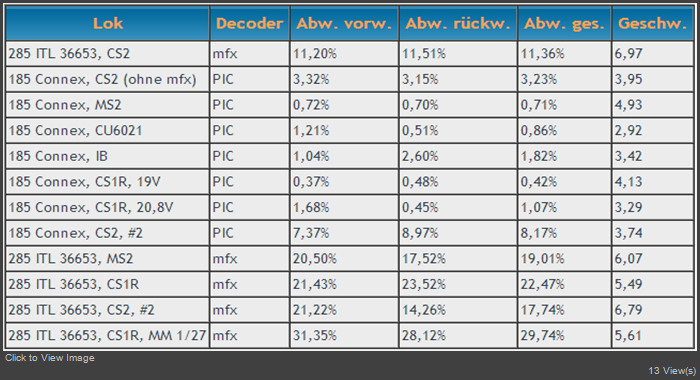

Posts: 15,544
some new results from today.
Someone said the CS2 would be the best controller for such tests. So I tried the CS2 today.
The first test was with an ITL 285 (#36653, TRAXX hobby loco with mfx and sound). With the CS2 the results were almost OK (speed varied about 11 % during 16 test runs).
For comparison I then tried a TRAXX hobby loco with fx decoder. I ran very jerky with the CS2. I aborted the test, disabled mfx in the CS2 and tried again. Some test runs were still jerky, leading to a lower average speed on that runs. Speed varied about 3 %, not bad - if it hadn't been very jerky at times.
I kept that loco, but tried an MS2 this time. Speed varied less than 1 % this time. And remember: hobby loco with hobby three-pole motor and hobby decoder.
Still using the same loco, I now tried the good ole CU 6021. Speed varied by about 1 %. And with the CU 6021 this loco achieved the lowest speed.
Then I tried the Intellibox, still with the same loco. Speed varied by about 2 % here.
Then same loco, but with CS1R. Track voltage (as displayed by the CS1R) was 19 V, my standard setting. Speed varied by less then 0.5 V.
Since with the CU 6021 I achieved the lowest speed, I concluded that the speed depended on the track voltage - higher voltage leads to lower speed at speed step 1. So I set the CS1R to maximum voltage (it now displayed 20.8 V) and tried again. Variation was now about 1 %, but speed was considerably lower.
Now same loco back to the CS2. I reactivated mfx and gave the CS2 a re-boot. Now the speed varied by about 8 %, several of the test runs were very jerky.
Now I went back to the ITL 285 and also tried this loco with some other controllers.
With MS2 the speed varied by about 19 %.
Then with CS1R and mfx, the speed varied by about 22 %.
Then another test run with the CS2, speed now varied by about 18 % (first test series of 16 runs with the same loco and the same CS2 had a variation of only about 11 %).
Back to the CS1R, but now mfx was disabled and test was conducted with MM protocol. Speed varied by about 30 % this time.
It should be noted that the speed of the fx loco was around 3 or 4 km/h while the speed of the mfx loco was around 6 or 7 km/h. Stable speed at lower speed levels is more impressive.
Neither CS2 nor MS2 display the current speed step as a figure. With both controllers I gave the locos a single notch on the speed knob from standstill, assuming this should be speed step 1 (very likely with the MS2, but I'm not sure about the CS2).
Remarkable result of this test: the fx loco ran jerky with the CS2 while it ran fine with the other controllers. Maybe Märklin should address both the load regulation of the new mfx decoders and the output signals of the CS2 TFP (track format processor).
A test series (16 test runs) takes a considerable amount of time, but with only 16 samples the lowest and highest samples may still be far from the highest or lowest possible values. But the order of magnitude is still significant.
I did two test series with the ITL 285 and the CS2 - speed varied by 11 % in the first series and by 18 % in the second series.
Once again the hobby loco with the hobby three-pole motor and the fx decoder achieved much better results than the mfx-equipped loco with the same type of motor - especially if the tests conducted with the CS2 are excluded (as the fx loco ran jerky with the CS2).
I'd say the three-pole motors are better than their reputation - and the mfx decoders have to take a bigger share of the blame for bad performances.
I attach a table with some details. The percent values show the variation forward, reverse, and total and the prototype speed in km/h.

As I understand the actual track length you use for measuring is about 29 cm and the loco’s are running at speed step 1?
Generally you would get more accurate results with a longer distance between the 2 triggers (circuit track in your case). You are comparing speed over a short distance and the inconsistence in when the software actual register the puls from the circuit track will skew the results compared to doing it over a much longer distance.
Also I am not sure if running a loco at speed step 1 has much to do with load regulation? I would imagine this has more to do with the actual performance of the engine and its gearing. At speed step 1 the engine is rotating very slowly and any slight obstruction in gearing etc. will influence the result (random reults).
As I understand load regulation has more to do with consistent speed when load is increased or decreased of the loco (e.g. when climbing up a hill and running down again)? The decoder sends a command to engine – then listen – if the engine is not doing as told it will send a signal to correct it? When running at speed step 1 we are not really exposing the loco to any change in load?
I would suggest a longer track length with e.g. a climb and running the engine at medium speed, where the engine will be exposed to an actual change in load. I believe this will give a more accurate comparison of load regulation performance, if that is want we want to compare?
Brgds - Lasse
Offline Janne75
#20 Posted : 08 January 2014 08:20:39(UTC)
Janne75
Joined: 23/03/2012(UTC)
Posts: 2,556
Location: Finland
Thanks Tom for doing these tests. This one is offtopic, but it became in my mind when reading your posting. I sometimes very seldom put my analog locos on my digital layout tracks and they run then with relatively high speed. But there is much difference how they do it on the upper layout with CS 2 60214 and lower separate layout with 6021 Control Unit. With CS2 60214 many of them run very jerky, but not all for some reason. The same locos run on analog tracks with normal transformer ok. And the same locos which run very jerky with CS 2 60214 run with consistent speed on lower digital layout with 6021 Control Unit. There seems to be some kind of pulsing signal to analog locos and also for example my turnout lanter lights blink with very fast frequency. I don´t know the reason for this, but I just wanted to write this here if it has something to do even with your loco tests? I mean difference with CS 2 and 6021 Control Unit?
Janne
#21 Posted : 08 January 2014 08:53:10(UTC)
Posts: 15,544
I started these test series because I noticed that the new mfx-equipped locos sometimes start with an abominable jerk (sometimes with a small jerk, sometimes jerkless) and then continue to travel at varying speeds.
The jerk is just a short moment of inconsistent acceleration. I found no easy way to measure that yet.
But I can easily measure the average speed of the loco across my test track.
At speed step 1, we are talking about times of 25 through 100 seconds! I use an old MS-DOS PC that does nothing else but poll the circuit tracks a few thousand times a second. I've been using this test configuration for years now.
In the beginning I even connected the circuit tracks to two PCs at the same time. For short intervals (fast locos), the difference normally was 0 to 2 ms.
A PC clock can be expected to be off by 30 seconds a day, so you have to allow 1 ms difference for each 3 seconds of measured times. And the results of the two PCs were only few milliseconds apart, as expected.
Good locos will give results that vary very little. I have no doubt about my measuring equipment.
As said before, running at speed step 1 is the biggest challenge for load regulation. I tried to make it simple (no grade, no curves, no load).
I made the tests because I noticed with my bare naked eyes that the speed at step 1 was not consistent. And maximum speed 60 % above minimum speed can be noticed.
The real problem: unsmooth start from stop to speed step 1 => I cannot measure this easily. Tried something with a video camera, but evaluating the videos takes a lot of time.
Another observation: locos that sometimes start jerky also have varying speeds when cruising constantly at speed step 1 (yesterday I also made a testrun at speed step 2 of 27 using MM protocol and the variation was still rather huge; the minimum speed at speed step 2 of 27 was lower than the maximum speed at speed step 1 of 27).
I takes a good motor or a good load regulation to start a train from a stop without jerk. Märklin now sell locos with cheap motors and homemade mfx decoders that lead to locos that start jerky.
The hobby locos (BR 185, 285, ER 20, Ludmilla) run fine with fx decoders, but not with mfx decoders. Same problem with e.g. BR 216/218 (with the small difference that these locos have RRPs of 250+ Euros).
Locos that start jerky are intensively discussed on Stummi's Forum. This finally led to the initiative to send Märklin an open letter about their motor and decoder problems.
It seems only few users here notice the jerks when locos start or care about the jerks. But more users care about cheap motors in high-price premium models.
A loco that starts smoothly (without jerk) at 1 km/h scale speed looks much better to me than a loco that starts with a jerk at a minimum speed of around 7 km/h.
Only one company sells locos that have these abominable jerks out of the box - and only since they introduced cheap decoders in 2009 and combine them with cheap motors since around 2011.
I know now how to avoid these jerks.

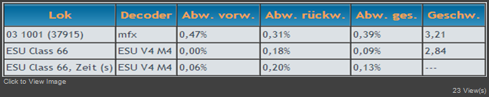

Two more results.
I tested my ESU Class 66 loco.
The results in km/h were 8x 2.84 km/h forward, 2x 2.84 km/h and 6x 2.85 km/h in reverse. I think for ESU locos I have to change the display to three decimals. LOL
For the ESU loco I also analysed the timings in seconds (forward between 31.112 and 31.151 seconds, in reverse between 31.014 and 31.140 seconds).
Either calculation puts the ESU loco on #1 in my charts with the most stable speed at speed step 1.
The other loco was the Märklin Insider model 37915 (03 1001) with new mfx decoder and motor with bell-shaped armature. A very good result, #4 in the charts.
I also gave my Piko V 200 a test run. Speed was 0.56 km/h at speed step 1. The slowest loco I've tested so far. Time for my 29 cm test track was nearly 158 seconds, so it would take more than one hour to make a complete series of 16 runs. I cancelled the test series with the Piko loco as I don't have time for that today. That's the factory setting - for normal use I'd increase CV 2 to get a speed of about 3 km/h at speed step 1.
Didn't test any Zimo decoders yet.
