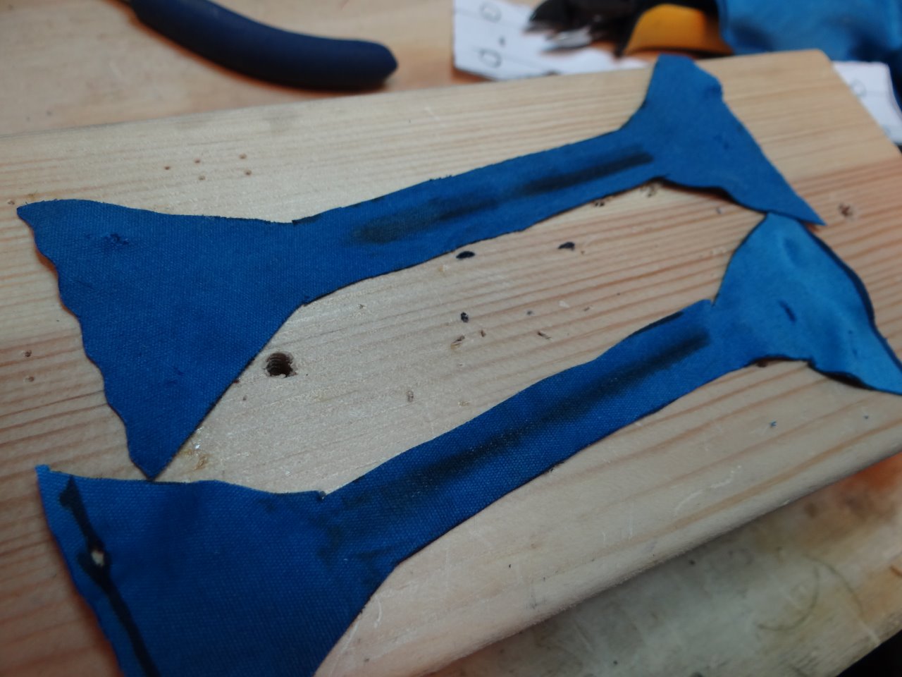

Here is a video on how to make a center rail cleaner for those stud things. Marklin does not make one, and the Stummi forum had a lot of DIY ones, but all in german.
Here is one that is really cheap - almost free - if you have a small car with a slider (pick up shoe) already on it, like the box car with the tail light.
If you don't have that, pick a small car you don't mind screwing a slider onto the bottom.
Then all you need is one of those clothes for cleaning your glasses.
Edited by user 16 September 2013 15:58:48(UTC)  | Reason: trying to get video to work
thanks 21 users liked this useful post by SCWHIPPLE

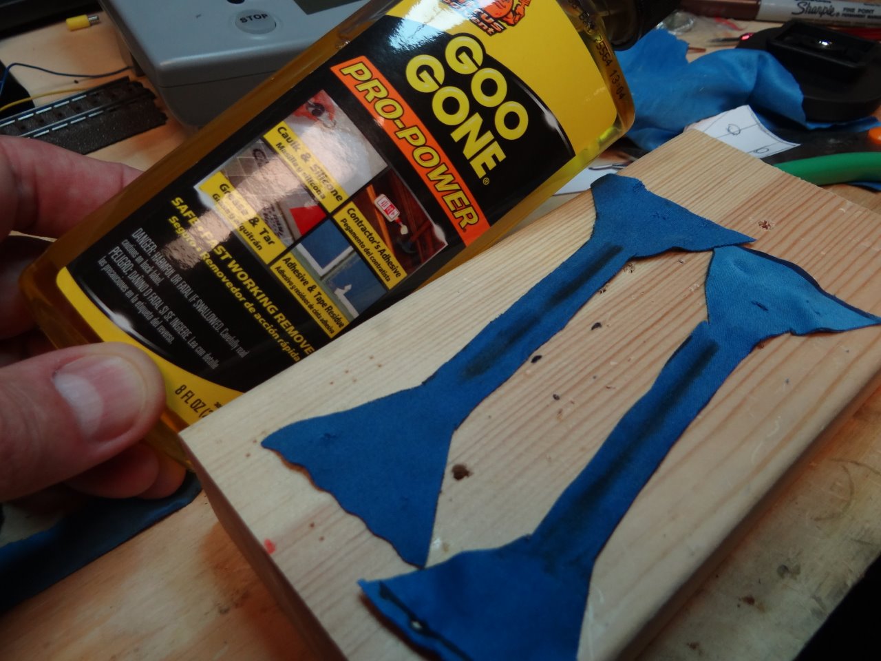

I read that someone used Goo Gone to put on a regular rail cleaner. Since I had some, I cut out two more cloths and tried it. Here are the results:
thanks 1 user liked this useful post by SCWHIPPLE
