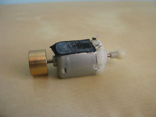

Dear Sir,
I would like to buy new motor(without flywheel) that shall be used for Marklin#36424 Ludmilla
The marklin part is No E408905 with flywheel
please help me to know the motor spec such as brand name , model , voltage.
Thank you
ThanethM
thanethm11 attached the following image(s):

I'm sorry, I can't help you with the motor specs. These seem to be generic DC motors used in many applications. I have seen similar in toys, shavers, small fans, etc.
Can I ask why you want one without a flywheel? I would have thought that with a flywheel is better than without?

This is what we call in the slot car world an FC-130 motor. They are all basicly 12VDC. The tough part is RPMs at that 12 volts. They can run anywhere from 14,000 RPM to 32,000 RPM. If the motor you have still works, RPM can be found with the propeller tach the RC airplane boys use. Motors typically have shafts at both ends and you cut to the length desired. A slot car pinion puller could be used to remove the flywheel and salvage for a replacement motor.

Because new Marklin motor price is30euro ... in Thai may be highter to 40euro. and i can not find many used-this model in ebay.
Then i would like to buy new one in other brand such as Mabuchi brand in ebay , or new one in Thailand.
Ok i will search it in Thai Hobby R/C shop.
