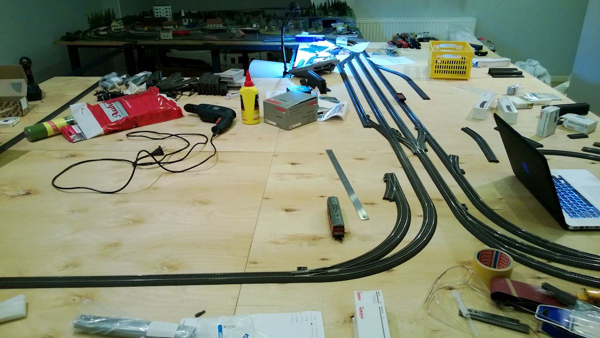

Hi to all from Ukraine, Kiev city! Smile
First of all I am glad to join you guys!
I am not a beginner of a marklin digital system and I know some hints of using it, but still learning some new features that produced by Marklin.
Since I decided to build new fully digital layout two month ago (3x3m), I started to learn braking system - here I got confused and I need some help from you guys.
Someone on this forum said that 72441(2) and 76xxx - got confused. Today I wired BM 72442 and 76394 and it seems to me works good, BUT could someone tell me please how to setup braking distance? I have 3 isolated sections: first section is 188mm, second section is about 540mm, and 3rd section is 360mm.
As far as I know, braking distance depends on speed of loco. Therefore, where should I install the signal before or after platform (one direction)? I tried to configure max/min delay - no reaction.
My goal is: smooth stop at the end (exact point) of 3 standing in a row platforms.
Your help much appreciated!
P.S. Here is some photos of my new layout RollEyes
Thanks in advance!
Boris

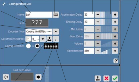

I understand what are you talking about. To be honest, I was a little worried as I could brake my decoder on loco while playing with CV parameters, so tried to change just braking delay parameters on loco settings page (if necessary, please see attached file). Also I know, if I make any changes to braking/acceleration delay values - CS2 telling me that "Nothing changed" while I pressing "upload it on my logo" button. Actually I checked and nothing happened, even if I put max/min values for braking delay (all my locos equipped with MFX decoders).
PS even if i something wired incorrect, braking module still works good ("trigger" sound from module, loco stops on red signal in braking area with braking sound) except braking distanceCursing. Today I will try to do once again, maybe something may change and let you knowSmile.

I went on my own risk and changed CV parameters of loco (15 by default). I can tell you that it seems to me workingThumpUp - many thanks for advice!!!ThumpUp.
Could you please tell me about 3rd section (secure): when pickup shoe touching 3rd section, locomotive just switching off and make some minor "triggering" sound, as it didn't have enough power supply. This only happening when "red" signal of semaphore and when I switch to "green" signal - locomotive continue moving on.
My guess, that behavior of my loco is normal as 2nd section (braking area) is not long enough for full stop BEFORE 3rd section. So I have to play with parameters.
Only I would like to know few things, if this is normal situation, when locomotive is switching off in 3rd secure section? And how to get locomotive to proceed slowly on "yellow/green" signal. As I understand, brake module supporting this feature also?

Good to hear you got the courage up to try and adjust the CVs. I too was nervous the first time I adjusted them. I usually will set the braking value to 0 on the initial loco screen so the CS2 software will play no part in the braking and just let the decoder do it all. I assume the third section you are talking about is the "stop" section of track in the braking area. This section of track has the power removed to insure the train stops. So it is normal for your train to shut down completely in this area. The trick is to adjust the braking value to stop before it reaches this area.
I am not aware of the braking module allowing a train to run at a slower speed in a "yellow" signal area. However, you can adjust the CV for acceleration so that it starts up slowly from a dead stop as it moves towards a set speed. You can try adjusting the acceleration and see how the loco responds.
