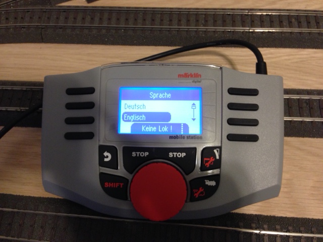

I upgraded from the MS1 to the MS2 about 6 months ago and everything was great. Cool That is until I decided to reset the MS2 via the menus a few weeks ago. When the unit boots up it displays the default language value of German. I go through the menus to change it to English but it never changes. If I return to the language menu after the "change" it is set to English but everything is still displayed in German. If I change it to any one of the other languages it still stays in German. I have nothing against German but it gets difficult to program decoders when having to look up the translations. Has anyone ever experienced this and it there a solution? I have reset it dozens of times hoping that it will work this time.Angry

After you select "English", have you press the button associated with it? In your picture, after you select "English", then press the third button from the top, on the left part of screen? It should change to English after an automatic restart, if not, then it's weird. Sorry, cannot help to much, never had this problem before, perhaps another members in this forum can help you. Good luck.

I have selected English. What I was hoping to show with the picture is that English has been selected, but all the menus still show up as German. When I do change the language from German to English it does not do an automatic restart. It just returns to train control screen. Is that what it is supposed to happen?
