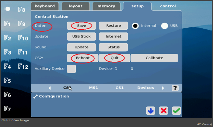

Now here comes Dialogue #2:
There should be no fullstops after "Delay" because it's no abbreviation.
I didn't spot other errors (but maybe a native speaker will).

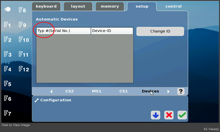

Here comes Dialogue #3:
Funny thing about this dialogue: there are two keys each for colon and semi-colon.
There's a backtick ("`") but the forward version ("´") is missing - is this a problem?
Are the symbols that are missing and which a native speaker would need?

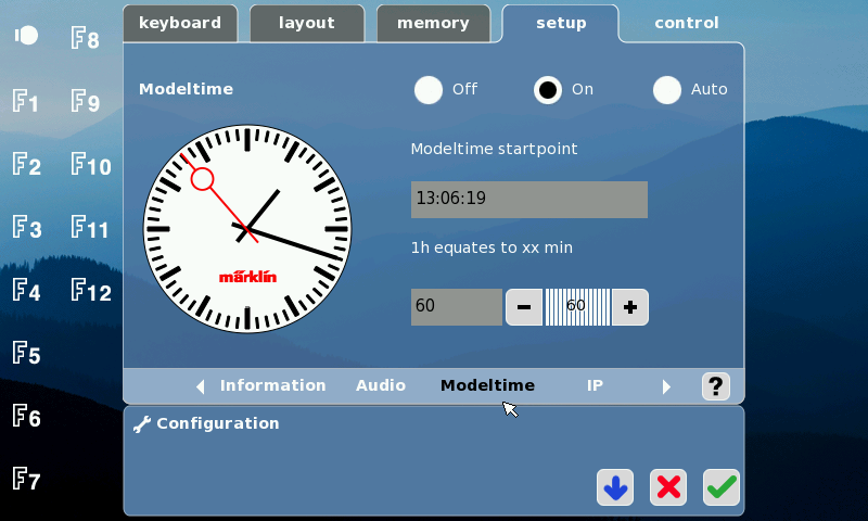

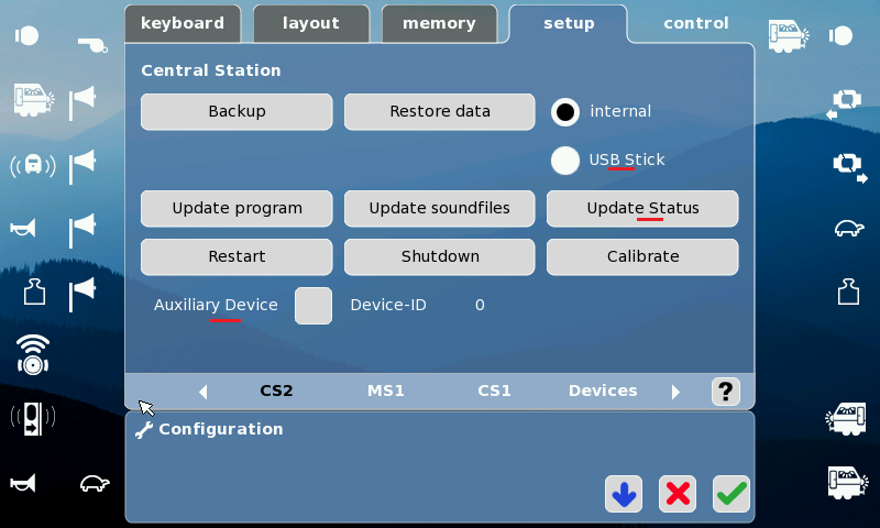

Now for Dialogue #5:
The word "Information" does not fit ("Info" could be used instead) and "Motor/Licht" was not translated ("Motor/Lights" will probably do).
Is "Direction Inversion" OK? Or maybe "Reversion of Direction"? "Reversion of Directions"?

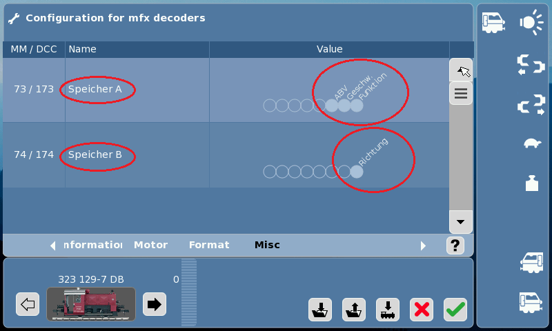

Dialogue #7:
Only two entries - and nothing was translated.
"Speicher" probably should be "Memory".
"ABV" should be "ABD" (at least they use ABD on the function mapping screen).
"Geschw." => "Speed".
"Richtung" => "Direction".
"Funktion" is left as an exercise to the reader ...

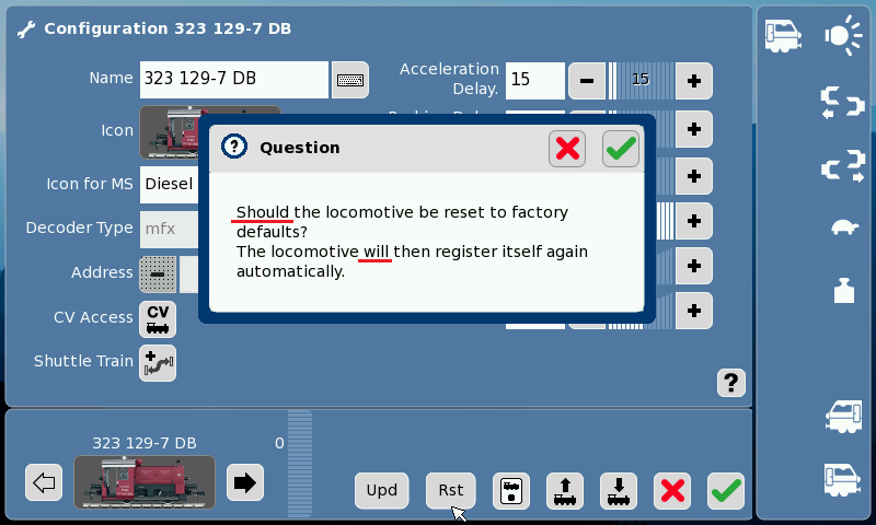

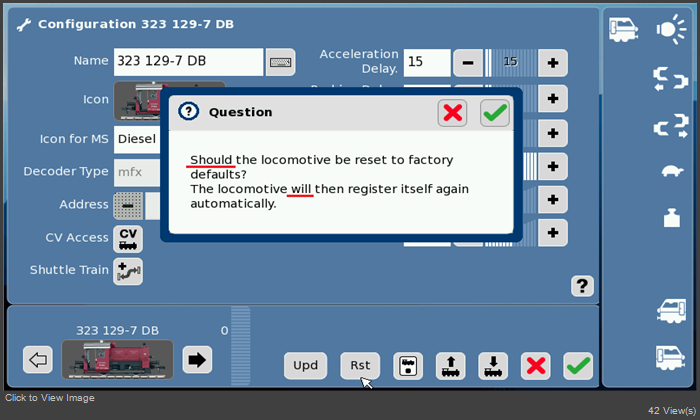

Dialogue #9:
How about using "shall" and "would" (instead of "should" and "will")?
Maybe native speakers can make a much better suggestion.

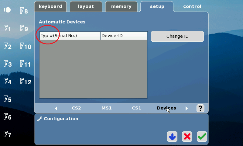

Dialogue #12:
Assuming that "Decoder type" is correct then it should be "Coding switch".
Should "Accessory state" be written in two words?

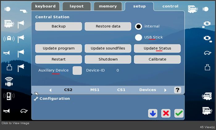

I think it should be "stick", "status" and "device" (all lower case) and "Device ID" instead of "Device-ID".
Do the native English speakers agree?
The "<" and ">" symbols are missing from the two keys to the right of "M". They are useful to me (on my eCOS) as I use them to label routes. For example, c48>c56 is the route between contact number 48 and contact 56. Fortunately, I have WindigiPet so I don't need to use the route function on the controller. Smile
Marklin needs to develop a Style Guide for the CS2 and other similar products. A Style Guide does not necessarily follow the strict rules of English, but it does make the look and feel of the device consistent.
For example, words like dog and cat are not capitalised in English, but the key words in a heading might be. For example:
The Dog and Cat Live in the Tree
Blah blah blah blah blah blah blah blah blah blah blah blah blah blah blah blah blah blah blah blah blah blah blah blah blah blah blah blah blah blah blah blah blah blah blah blah blah blah blah blah blah blah blah blah blah blah blah blah blah blah blah blah blah blah blah blah blah blah blah blah blah blah blah blah blah blah blah blah blah blah blah blah blah blah blah blah blah blah blah blah blah blah blah blah blah blah blah blah blah blah blah blah blah blah blah blah blah blah blah blah blah blah blah blah blah blah blah blah blah blah blah blah blah blah blah blah blah
In computer software you often see the words on a button (e.g. Click Here) capitalised. These are some of the things that make the look and feel of the application look comfortable and familiar to users.
A Style Guide will help to set consistent rules for the Interface that include capitalisation, font usage and colours.

Dialogue #9:
How about either:
a. Do you want to reset your locomotive to factory default settings? Once reset the locomotive will register itself automatically.
b. Are you sure you want to return you locomotive to it's factory settings? It will register itself automatically once complete.
Dialogue #12:
Couldn't have put it better myself!
There should be no fullstops after "Delay" because it's no abbreviation. <-- Agreed, “full stops” are called “periods” … these are accurately used for abbreviations, such as “Max.” and “Min.” speeds …
There's a backtick ("`") but the forward version ("´") is missing - is this a problem? <-- Yep, see qwerty below …
<-- If you look at a “normal” qwerty keyboard, the colon and semi-colon are correct, on the same key after L ... but the comma and dot (or period) after M are wrong … should include “<” and “>”, yep, also, “Shift” key took a hike before Z to the left, and “?” became a “2” after dot to the right, and Capslock went underground … , how about just: “Märklin, please check qwerty layout” … ^^ ?:
http://education.davidsp...9/9b/Keyboard_qwerty.jpg
The word "Information" does not fit ("Info" could be used instead) <-- Agreed
and "Motor/Licht" was not translated ("Motor/Lights" will probably do). <-- Agreed
Is "Direction Inversion" OK? Or maybe "Reversion of Direction"? "Reversion of Directions"? <-- I would write: “Reverse direction”

Dialogue #7:
Only two entries - and nothing was translated. <-- Not much to say here …
"Funktion" is left as an exercise to the reader ... (Function ?)

Dialogue #9:
How about using "shall" and "would" (instead of "should" and "will")? <-- “Shall” is closely associated with the Bible, and therefore kind of harsh for model trains wink, so I would suggest this wording in “contemporary” netspeak: "Reset locomotive to factory defaults? The locomotive will register itself again automatically." (The word “then” is not necessary … ^^)

Here we go with dialogue #16 (from the new 3.6.2 version).
There is nothing wrong about "Save", "Restart", and "Quit".
They were "Backup", "Reboot" and "Shutdown" with version 3.5.6. Could be "Archive", "Relaunch", and "Exit" with the next version. LOL

Dialogue #17:
"Typ" is German, "Type" is English.
#34 Posted : 25 May 2014 20:53:33(UTC)
Posts: 15,578

Dialogue #19:
I don't know whether the phrase "1h equates to xx minutes" is right or wrong.
The meaning is "1 model time hour equals xx real time minutes".
How to say this in English?

Several buttons were renamed with version 3.6.2 - as of version 3.7.0 no-one found time to update the help for this page.
"Update program" is now "Update" => "Internet" (of course requires a "functioning Internet-Verbindung") or "Update" => "USB Stick".
"Restart" is now "Reboot". "Shutdown" is now "Quit".
