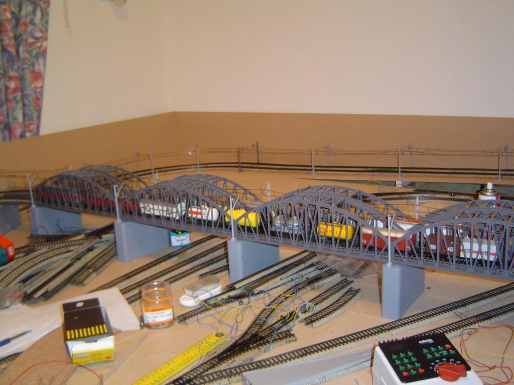

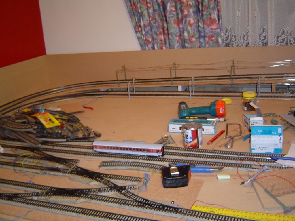

This is going to be a tight fit..........what you see here is the baseboard for the bridge and right hand yard area.
The backboard is attached
Time to play......
Ramps and bridges are installed. The bridge pillars were made by glueing 2 pieces of 18mm MDF board together, then cut to size and painted. The pillars were put through a router with a 10mm bullnose bit to give the rounded edges.
The lights at the end of the tunnel............no, it's a V200!!
The 2nd module goes in. Boy, is this a tight fit or what?? Getting this all out will be a worry. And, getting it down the stairs will be a bigger worry.....
Edited by moderator 11 January 2011 19:55:46(UTC)  | Reason: Not specified

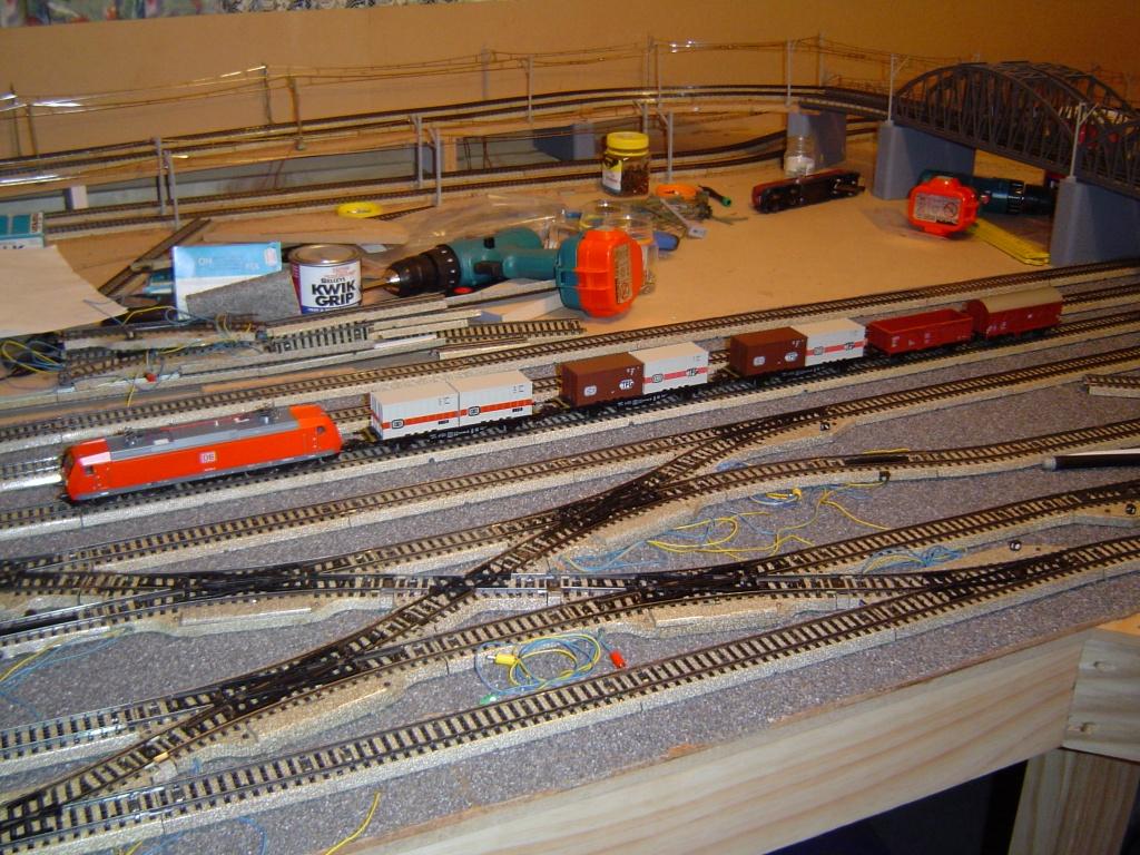

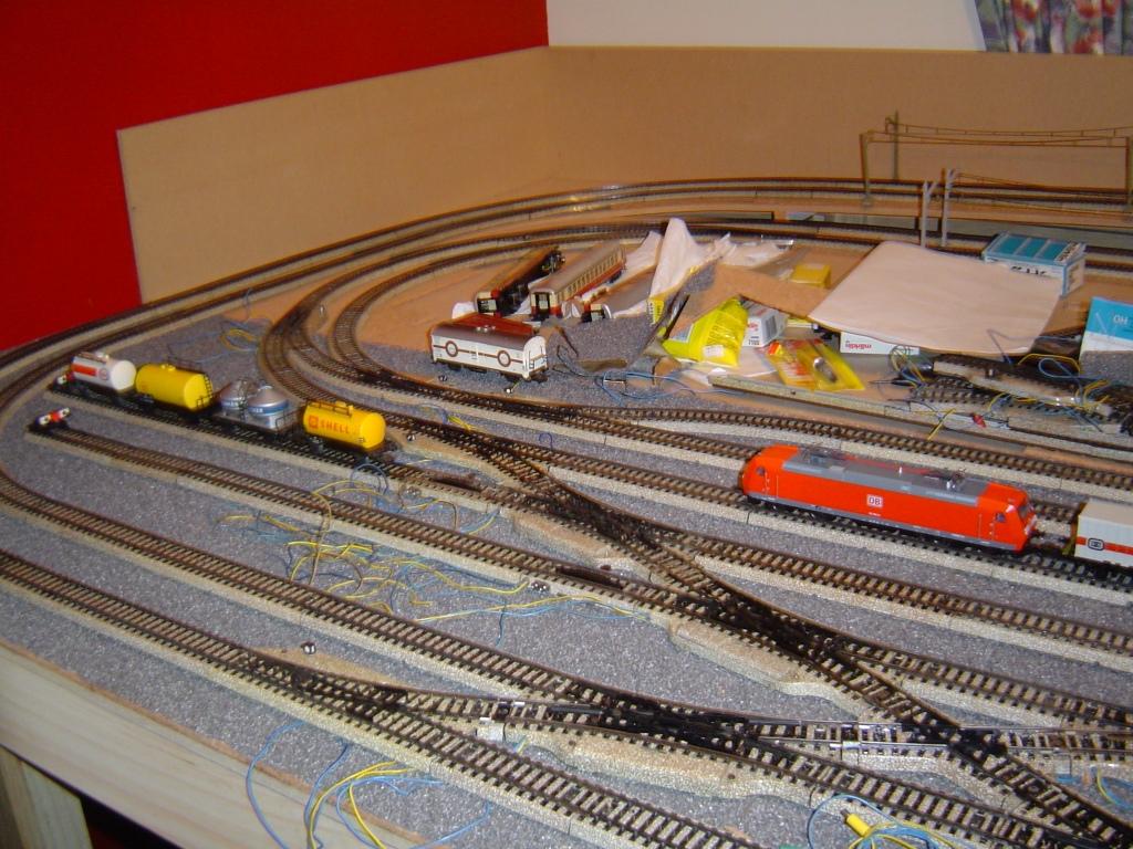

Here are the tracks going down
Hey, that V200 is going the 'wrong' way..... I initially ran the layout in the NZ / Aussie / UK way with trains travelling on the left hand track. Everything nows runs in the 'correct' European way, on the right hand track. The 6021 has since been replaced by a Central Station.
Sometimes you just have to play.......
Since these photos were taken (over a year ago) I have:
- Replaced a lot of the older M Track with new track I was able to purchase at a very good price. I was having trouble with some locos derailing, including the red BR185 you see in these pictures. Installing new track has fixed that.
- Installed Catenary
- Installed Station platforms
- Wired up turnouts with Viessmann 5211 decoders
- Sorted out some of the gradients, which were also causing derailments.
- Rewired parts of the layout with a better wiring loom that what I was using.
- Started installing some Viessmann 4013 light signals.
I don't have any later pictures than these, but I guess I need to take some more - after I track down where all the rechargable batteries for the camera have gone..... Let me think..... 2 kids with MP3 players, Cameras and Walkman CD players.......where have the batteries gone???.....and I'm left with the ones that only seem to last for about 4 shots...... I wonder why....[:(!][:(][:I][:I]
Edited by moderator 11 January 2011 19:54:47(UTC)  | Reason: Not specified

I especially like the second-last pic!
Nice view, and good work on the caternary. What brand masts are you using? (Electrotren?)
Suggestion; Personally I dont like the orange platform-roofs. Why dont you paint them all grey, when you get the new ones?
BTW; How did the V200 get there? (hehe)
