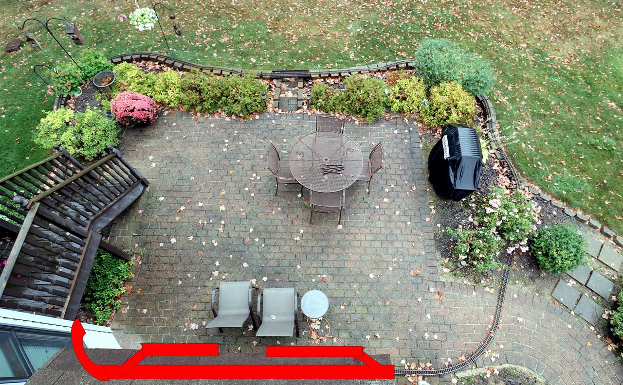

I have a large circle of track on the patio. I'm going to add two independent sidings to hold one loco while the other runs. I have an LGB 1205 and 1215 turnout. Can I convert these to power routing (when I throw the switch) or do I need to wire both sidings the old fashioned way with blocks?
I attached an image of the layout and how I plan to use the turnouts to hold the locos.

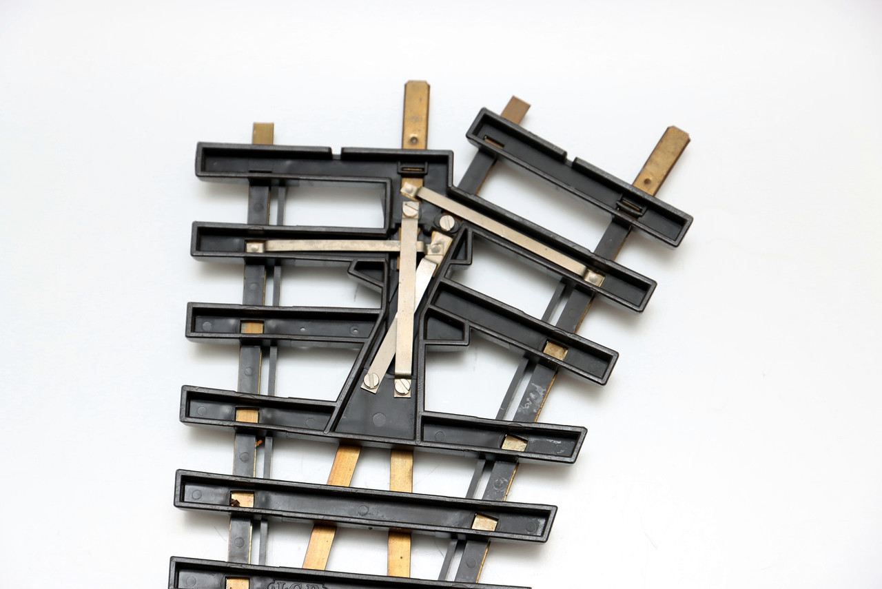

The back of the LGB turnout.

LGB part no. 12070 will do the trick. It is an auxiliary switch that mounts to the switch motor.
