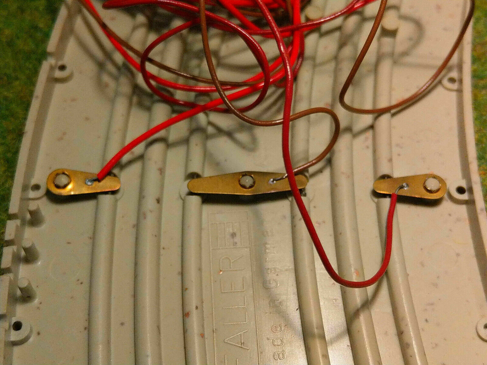

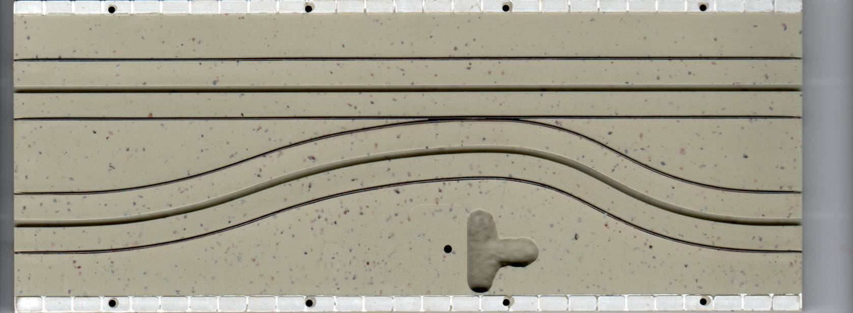

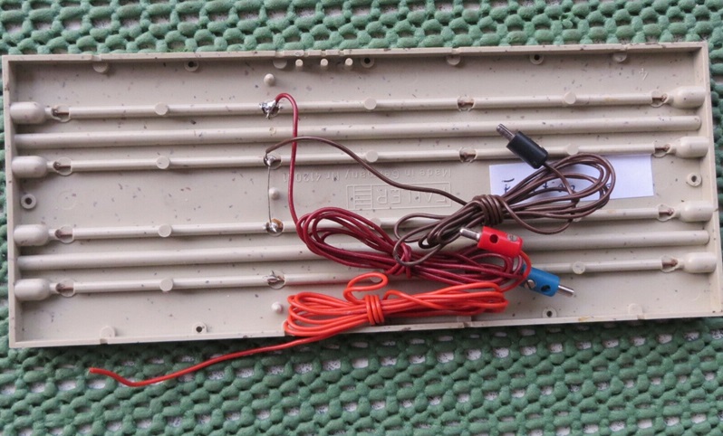

Actually, the two inside rails of each lane 'may' be connected electrically.
Some track feeder sections are wired this way with the inner rails being 'common' feed by the brown wire, and two different red wires for the outer of each lane
Also, the 'squeeze' track section has the two rails joined although I have seen some where a thin insulator has been placed between them.
Note the bottom red wire in this image has become disconnected from the outer rail
Another feeder method using press-fit contacts
Early wiring schematic
The 4726 squeeze section. This one has insulation between the two inner rails but it would pay to check
