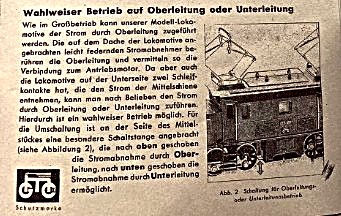

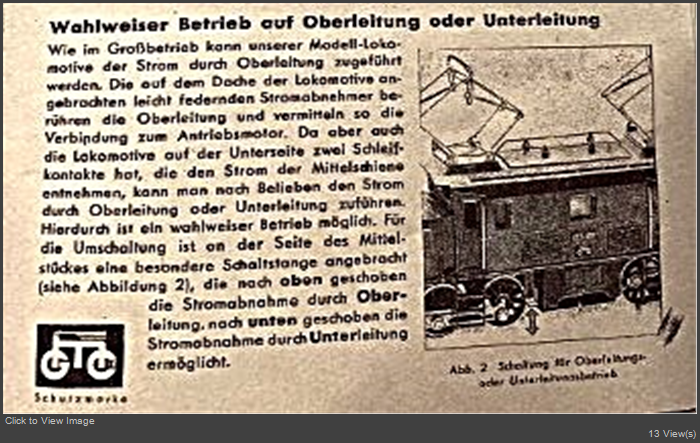

Offline ktsolias
#7 Posted : 22 March 2025 23:27:21(UTC)
ktsolias
Joined: 01/05/2016(UTC)
Posts: 624
Location: Athens
Hi here is a picture of the lever
is no 29 in the plan
Costas
Offline Peter S
#8 Posted : 23 March 2025 15:18:11(UTC)
Peter S
Joined: 28/07/2004(UTC)
Posts: 9
Location: Westfield, MA
actually your picture is mirrored and the lever is on the left side.
