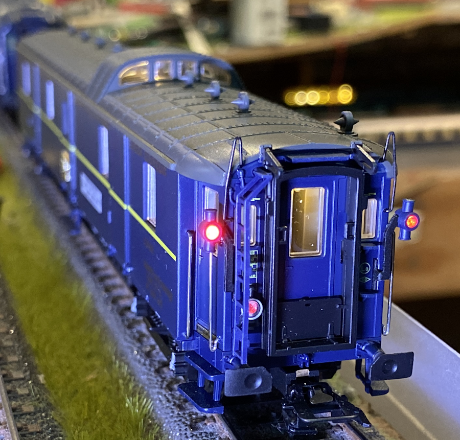

Here is a late Märklin treasury I got. The Edelweiss
Sans titre.png (1,212kb) downloaded 62 time(s).
