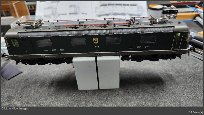

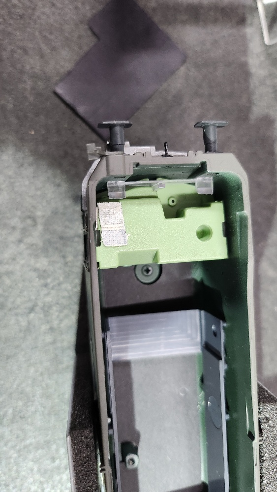

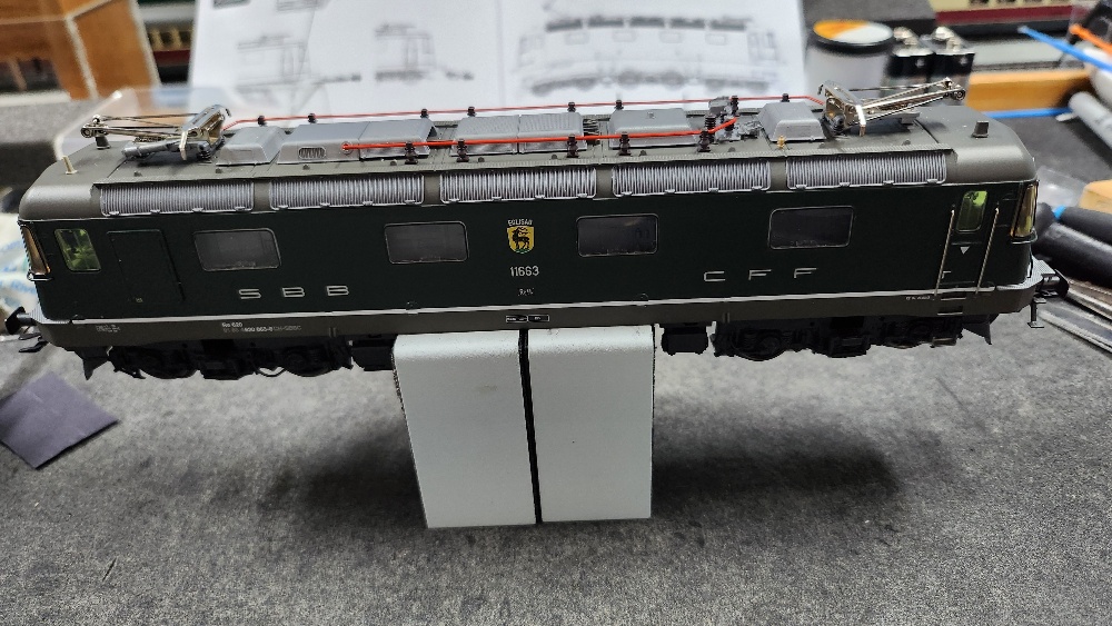

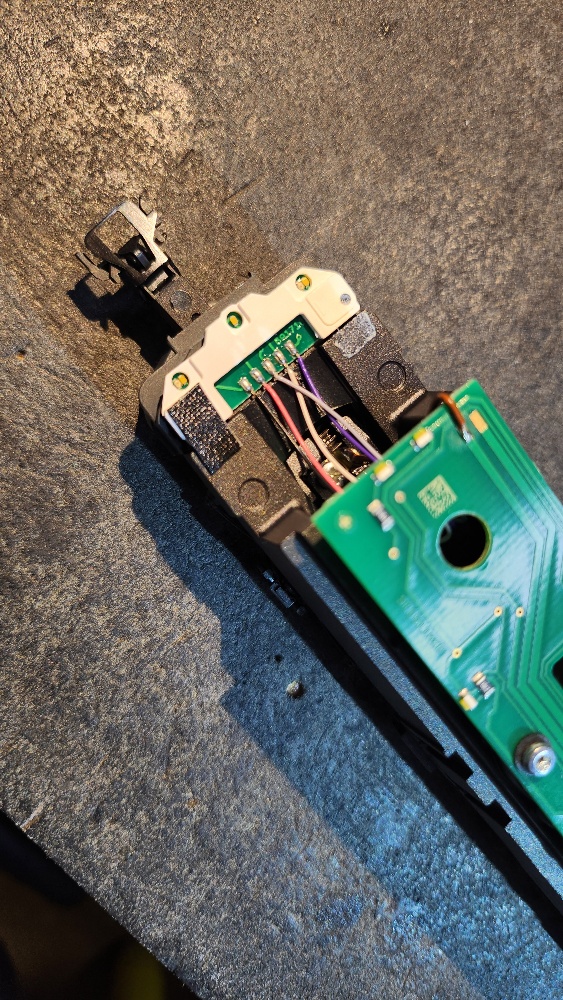

Hi All -Problem solved,
Last night I left the Loco body supported in the centre with centre bogie off and 2 main screws removed.
This way the chasis was not attached and gravity was pulling it down.
This morning 12 hours later I lifted the loco up and the chasis dropped down about 5mm - a little giggle and it dropped down.
It had been held in by one black insulation tape which cover each LED on each corner of chassis - it looks like the glue from one tape spread side ways and adhered to the bottom corner of the drivers cab which was why the window above was moving before.
I have tried to attach photos but cannot see how to do it - will do if someone can assist . ( THANKS KiwiAlan -pictures now attached BigGrin )
Thanks for all the input with a good out come and the help of gravity and time.
