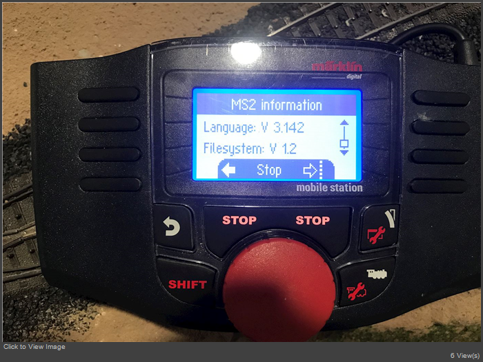

The controller is only 1 year old and says it has version 1.2.

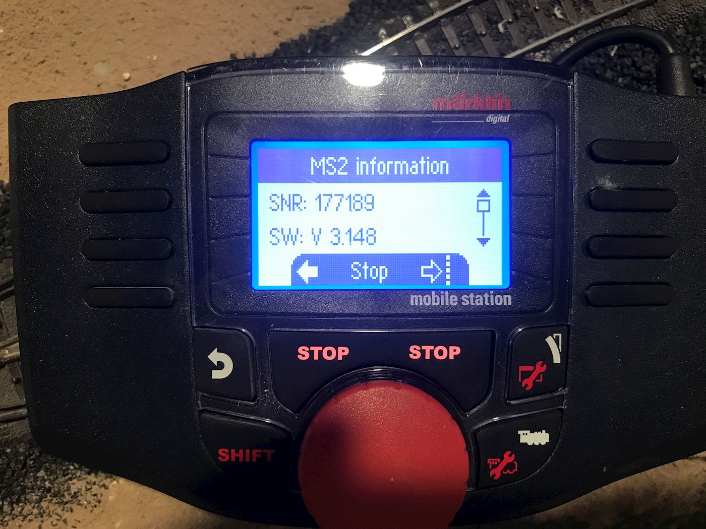

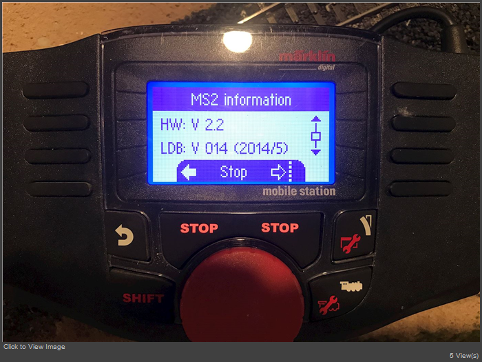

Sorry about the lack of introduction, my name is Ivan and I live in eastern Wisconsin. I started a 4’ by 14’ German Layout with Marklin items that I acquired 20 years ago when visiting Germany. I may not understand which number is the version number on the mobile station. Here are pictures of the unit and its settings. CAE880A6-24B6-4C4D-B416-BE6D31EAC7C2.jpeg2305F9C9-E913-4B29-B37B-F397A564AA90.jpegB2D2C9F5-E058-47E2-B12E-629583B2E5CC.jpeg

You have SW (software) 3.148 and yours train models with the mfx protocol should work.
