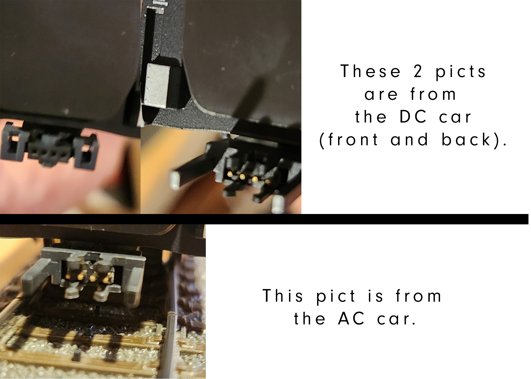

Probably best put up some pictures showing the couplings

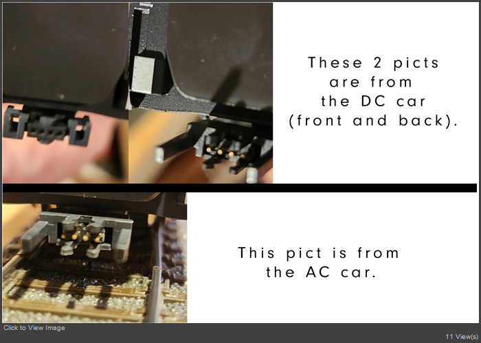

. coupler.jpg. Sorry they are a bit blurry but as you can see they look identical. I didnt detach the AC unit for a pict of the female end. These couplers feel like they will break if I pull too hard. I hope thats not the case....but.
