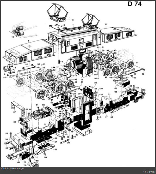

To make things clearer, here is how it looks with an exploded view
So when you remove the two side housing / cowlings (and the lights assemblies) the loco runs fine.
I suppose you refer to a version after 1953. Before that, instead of having traction tires the 3015 had weights.
Each cowling is fixed by 2 screws that are located rather close to the locos extremity.
Each cowling is engaging into the central housing and there must be a free clearance (cowlings should not touch the central housing)
So look for possible force having bent those cowling which in return prevent the free rotation of the sort of cardan shaft. This could cause an irregular and excessive friction against the motor's rotation.
So this is only an assumption.
Please remove the central housing (2 screws) and test with the cowlings in place
Then remove the lamps and test again
Then remove the cowling on the direction relay side and test
Then remove the other cowling and test
Another possibility is an electrical fault (with the direction relay or with the light assemblies).
Another possibility is someone has played and messed the articulated transmission (sort of a short tube with 2 screws and 2 locking nuts).
When messed with, the result is the loco is crawling around instead of moving straight.
Here is my loco during my repair. Because I had no direction relay, instead, I used a spare C90 decoder and 2 diodes
Maybe it could help you better understand how it works
